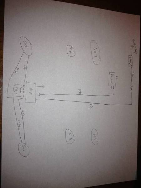

    So here is the diagram I have drawn up so far. If I use a crossover on each of the front speakers how do I wire this correctly with the door speakers connected to a 4 channel amplifier and how does this tie in the my HU?? And is a distribution block necessary?

    I've always used a 4-channel amp with one side bridged going to a single sub. If I was running 2 subs, I would probably opt for a separate amp for the subs and door speakers.
    With component front speakers w/crossovers, you just run the wires from the amp to the crossover, and then from the crossover to the speakers. Most will come with the wires you need, and also allow you to boost the tweeter a little if needed.

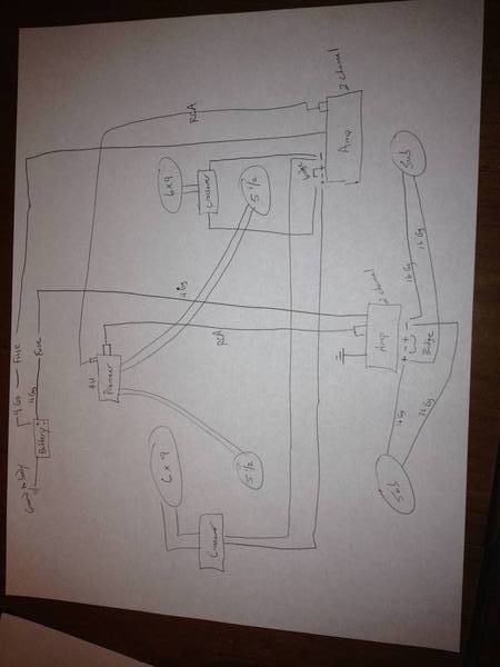

    So how does this look w another 2 channel amp and added crossovers?? What are the crossovers for anyways?

    That looks right.
    The crossovers cut power down to a speaker for frequencies that the speakers cannot reproduce easily. For example, tweeters are only good in high ranges, so sending frequencies below around 4KHz to 6KHz is a waste and may distort the sound. The mid-woofer would get frequencies from about 120Hz to 4KHz, and the subs somewhere below 120Hz. Crossovers and truly fine-tuning a system, the space, and the speakers is a complicated subject that I know very little about, but those are the basics.
    The amp should have a way to set it up for subs and cut frequencies above a certain frequency, kind of a built-in crossover. Head units that have a SW output can do this is well. Make sure to check both the amp and the HU setting.

    One thing you might want to consider with your wiring options is connecting your subwoofers in parallel across a mono channel amp. This would allow your resistance seen by the amplifier to be 4 ohms instead of 8 ohms (the 8 in the 10w1-8 indicates the resistance of the sub) therefore increasing the amount of power that the amp delivers to the sub.
    example wiring
    http://www.pakwheels.com/forums/attachments/car-entertainment-electronics-gps-navigation/555686d1217679720-subwoofer-wiring-diagrams-big-3-upgrade-2svc_8-ohm_mono_ox6_pakwheels-com-.jpg
