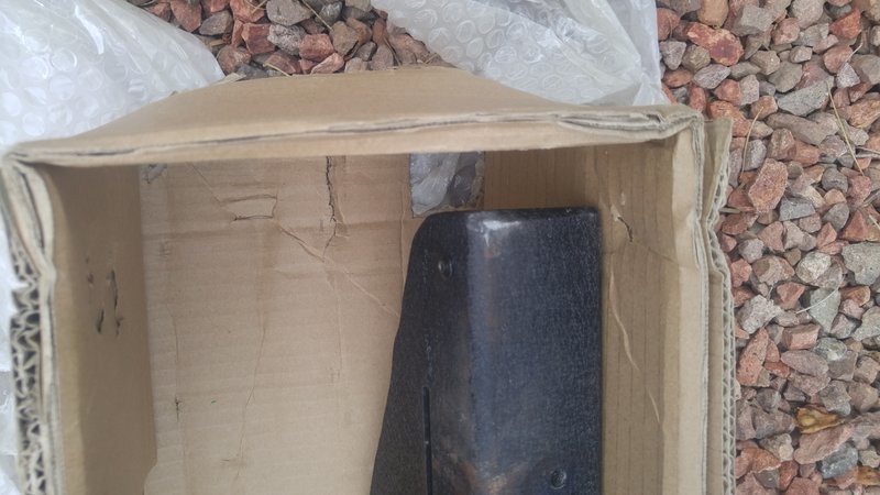

    One thing I will say - the packaging wasn't exactly what I would call sufficient. These steps are HEAVY and they were packaged in a box with only one layer of bubble wrap around them. One of the corners of the box had some damage and one of the steps had some scrapes. It wasn't horrible, easy to touch up and was on the side that isn't visible anyway:

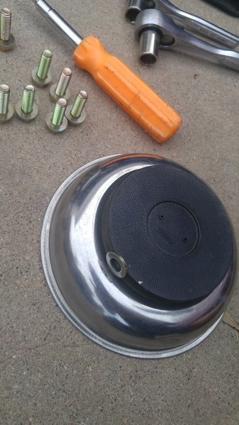

    The first thing I did was inventory the hardware, I poured the bag of screws and washers into my magnetic tray and almost immediately was disappointed thinking I was short one washer. Turns out I was just clumsy:

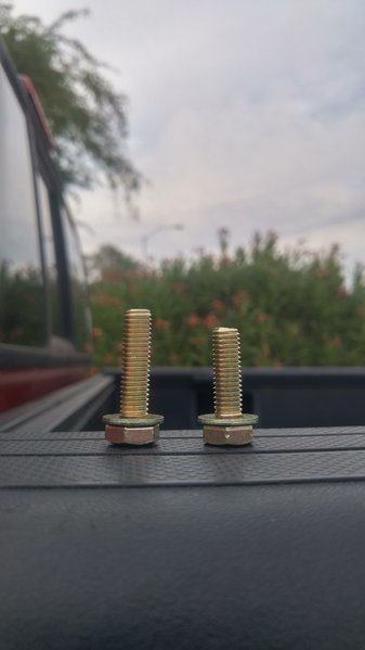

    Most of my research resulted in people recommending that you completely ignore the instructions, and I fully concur. The instructions are vague at best, basically they say "take them out of the box and put them on the truck". I noticed two different lengths of screws were included - I opted to use the shorter ones to secure the brackets to the steps and the longer ones to secure the brackets to the truck.

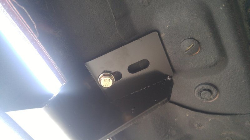

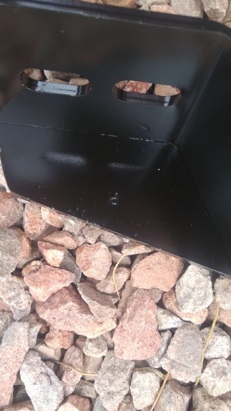

    After getting the hardware sorted and ready, I went ahead and followed the advice of a lot of others who had performed this install - I went ahead and put the brackets on the steps first, I didn't torque the bolts down all the way, just tight enough so they didn't need much more to completely tighten them. I used a hammer to adjust the positioning under the truck. The brackets and steps come wrapped in different colored packaging - green and clear. The green had the driver side items and the clear had the passenger side. The brackets are also stamped with a "D" and a "P" :

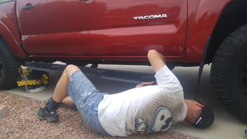

    I used my 5-gallon tool bucket to hold the rear up while I bolted up the front. My advice is to start at the front and work backwards - I tried to work from the back to the front on the passenger side and ended up having a hard time getting things to line up. Front to back went much more easily.
    You can see how the 5-gallon bucket is just about the perfect height.

    Easily tapped each bracket with a hammer to line them up to the threaded holes in the truck. The front bracket will only have one screw securing the steps to the truck:20160610_173525.jpg

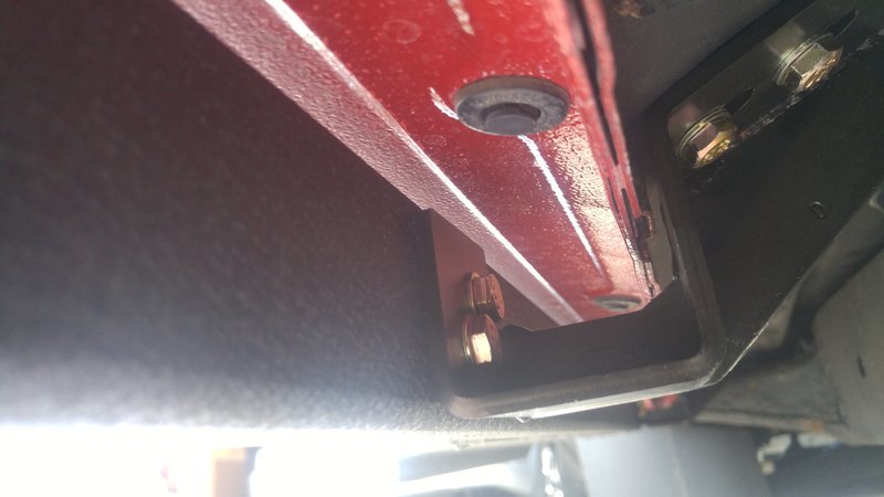

    No matter - I jumped up and down on the steps after the install and they felt very secure. The bolts that secure the brackets to the steps are the challenging ones to tighten - but with them being mostly tight they only needed to be turned about another 3/4 to 1 full turn to get them completely torqued. I used a six point 13mm socket and a 1/4 ratchet to achieve this. Some reviewers said they couldn't get a tool on those bolts because they were too close together, but I didn't experience this. I have just standard Craftsman sockets - nothing fancy or thin-walled, so maybe this is an issue that has been corrected by the manufacturer - not sure. EDIT: After they were installed for a few days I went under the truck to re-torque all the bolts and found that I was unable to get my socket on a few of the bolts that secure the brackets to the steps. Not sure if it was the AZ heat, or just shifting around, but whatever the case, I can say that I also experienced the issue of bolts too close together. I guess I'll be shaving down a cheap 13mm socket.
    I do see how awful this installation would be if you put the brackets on the truck first, though (that's one thing the instructions DO tell you to do - trust me, don't do it).
    In the above photo, you can see the two bolts on the bottom - those are where the bracket is secured to the step itself. Not much room to work in there, so tighten them as much as possible before installing on the truck, leaving them just loose enough to adjust with a hammer.
    Some folks used floor jacks to move the steps around to install, I opted to just go ahead and go hulk on it (well, as "hulk" as I can - I'm not exactly a bodybuilder). I was able to hold the steps up by hand while tightening the bolts up. Did everything by myself, so if I can do it, anyone can do it.

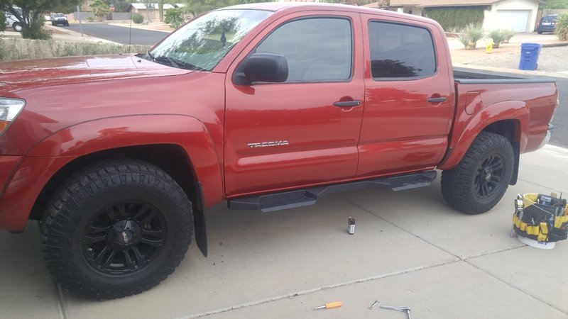

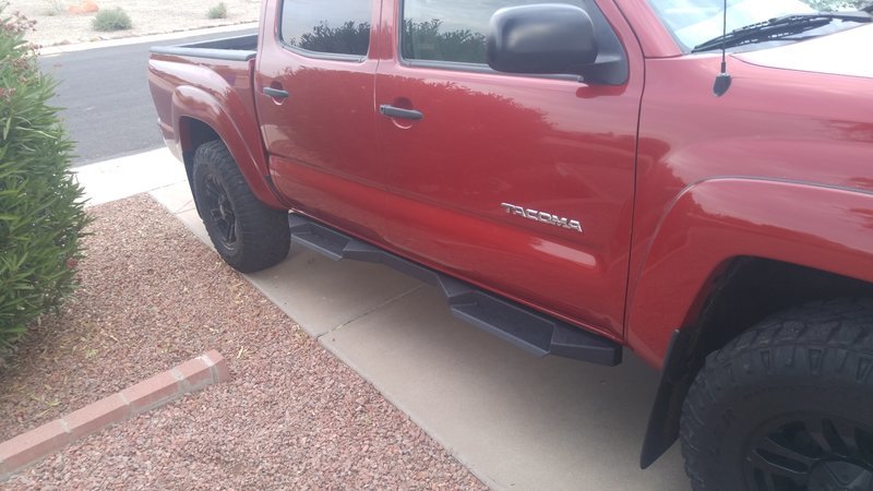

    The finished product:

    So that's about it - good steps, good price ($275 on Amazon, after tax and free prime shipping just a touch over $300). Yeah, you can get cheaper steps or nerf bars, but the biggest thing I liked about these is that they cover up the spot-welded portion of the body like the factory steps do, but at a lower cost than a set of factory steps.
    Some other observations - I don't believe these are sliders. They're very heavy duty (I believe 3/16" steel) but because they attach to the factory points on the truck, I fear you'd really mess up your rocker panels if you put the weight of the truck on them.
    They are functional steps, but keep in mind that because they install higher than nerf bars, you get steps that are only about 3-4 inches lower than the bottom of the door opening. It's enough though - my wife and daughter can now easily get in and out.

    Truck looks good, nice install. What wheel and tire are you running?

    MB Wheels - I believe it's called the "TKO" wheel. They work with TMPS, but require an adapter for fitment ($12 ea).
    Tires are Goodyear Wrangler Duratrac LT265/75R16. A little noisy but not awful.
    Wheels and tires came with the truck when purchased.
    One thing I noticed is that even though the steps are considered to be done in a matte finish and the wheels are supposed to be done in a matte finish, it looks like the wheels are a tad bit "glossier" than the steps. Not a huge deal, but some folks might be put off by the difference.
