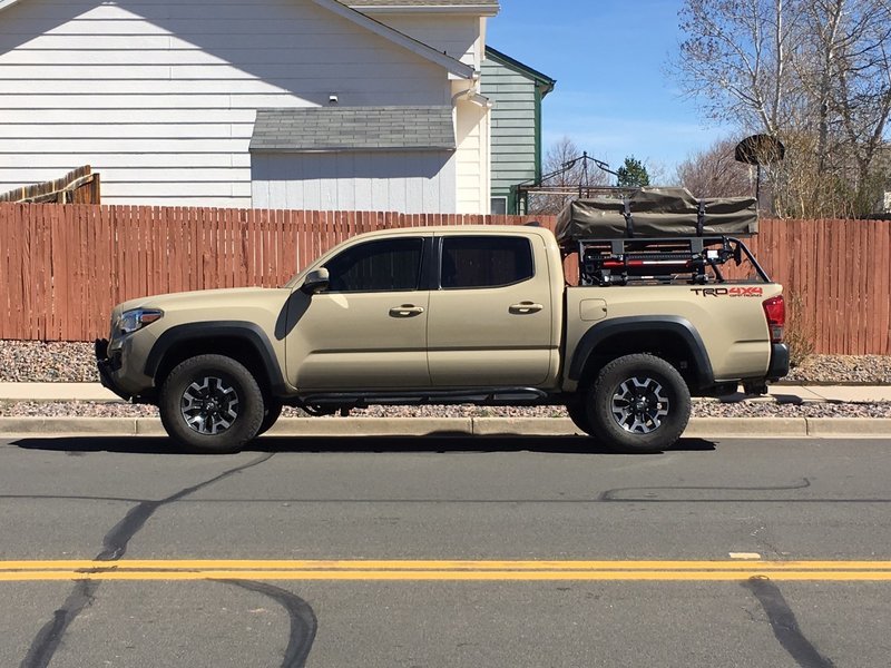

    Next wasn't really planned just yet...as I was researching RTT I noticed CBI was having their Garage Sale and one thing led to another and Nate and the boys at CBI gave me a smoking deal on the tent and Nate's bed rack and I was off to Idaho via a weekend trip with the wife and dogs thru The Grand Teton National Park. The Expedition Rig is really taking shape now....

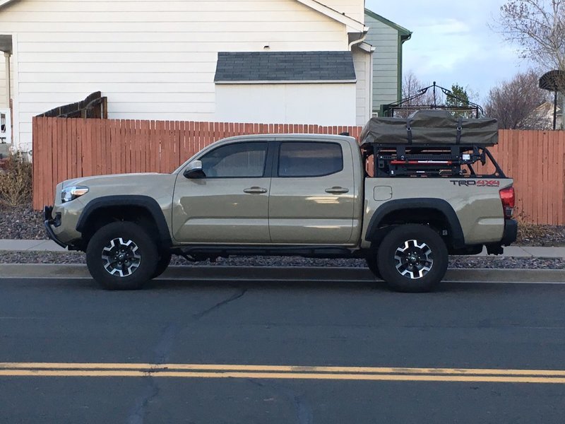

    Also thru the Revteck light bar on the front as I like the look of the Tacoma front (CBI hidden winch mount will be added later) and the light bar tube dia matches the sliders and rack so it fits.....painted (plasti-dip) the rear bumper and badges as well but all the badges came off soon after as the clean look is much better in my opinion.

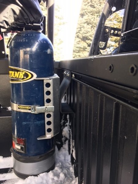

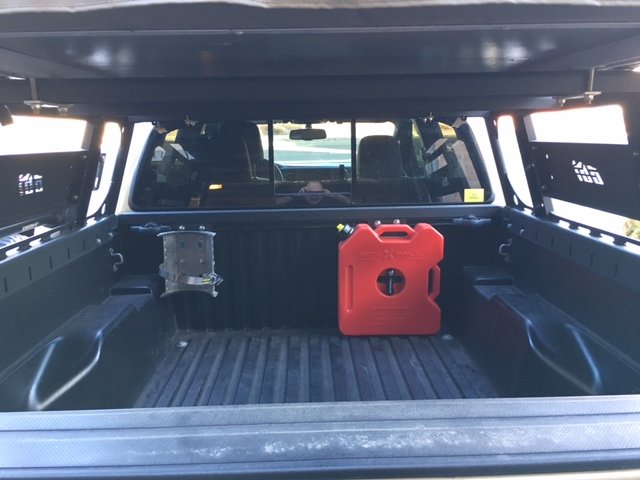

    Next...ordered the front bed rail mounting rail and then modified the RCI Hi-lift jack mounts to accommodate my Powertank bracket and fab'd up a Rotopax mount for the extra fuel can....

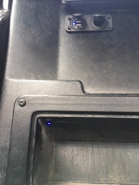

    As the tent has an LED strip across the interior top I needed a way to plug and play without the truck being on so I wired up an auxiliary USB/Cig port in the bed with an on/off switch in the storage box....now I just drop my LED/phone lead thru the tent and into the bed and it charges no problem....

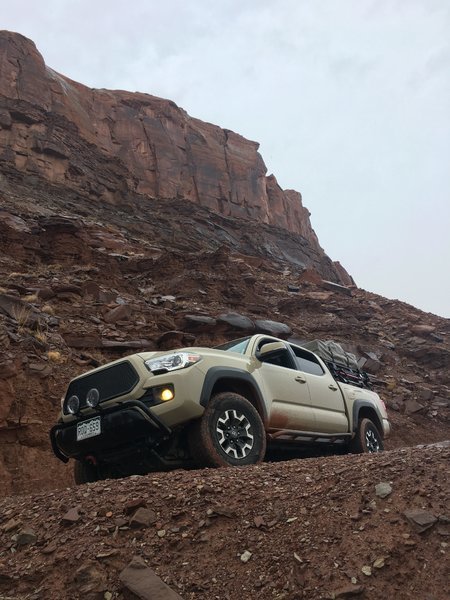

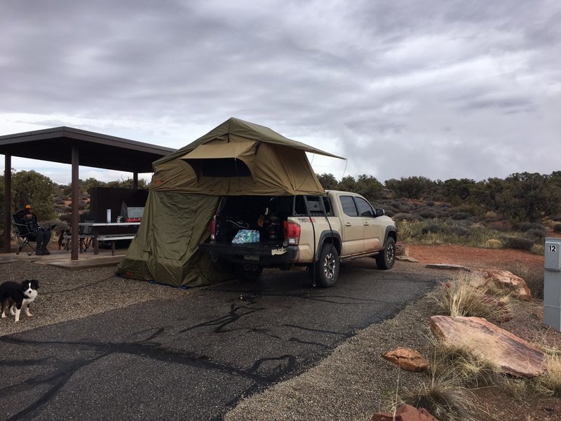

    Made a quick run to Moab a couple of weeks ago.....rained all weekend but at least we got out for a weekend and allowed me to see how the weight thus far on stock components were or were not working....moab tent.jpg

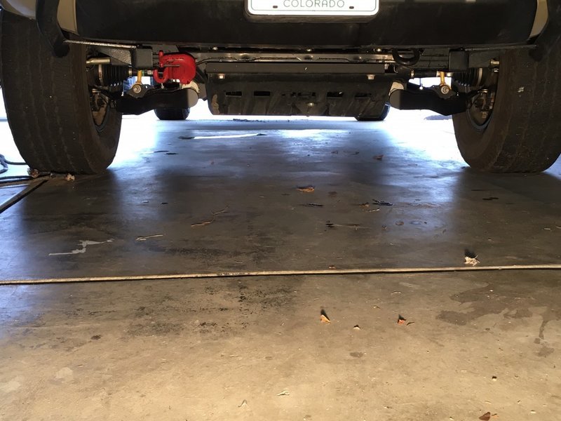

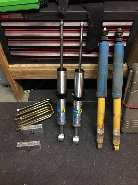

    As mentioned before goal is to load this thing up with weight first and then build the lift and tires later to match (that and can't see not utilizing the stock tires for as much as I can get out of them before going to something more aggressive......that and the JK needs new 35's first and damn tires get expensive)....but the Moab trip proved I got to do something as the rear was bottoming out and I was dragging the hitch mount quite often, so after a little research I got Bilstein 5100's (2nd gen on front due to better extended and compressed lengths compared to 3rd gen) and Toytec's 1" rear lift blocks all for under $400 (Jet.com had great prices and 15% off for first time user's).......More pic's to follow as this is current 03-16-17 and going on this weekend and next.....got ther rear Bilstein's on already, setting front at 1.75" with stock coils and 1" blocks in rear

    Bilstein 5100 installed front and rear......front at 1.75" and rear with Toytec 1" blocks.......Honestly cannot complain with this setup for $400 and a afternoon in the driveway.
    First pic is only rear Bilstein with blocks installed ......second is 100% complete......I don't have any post measurements yet.
