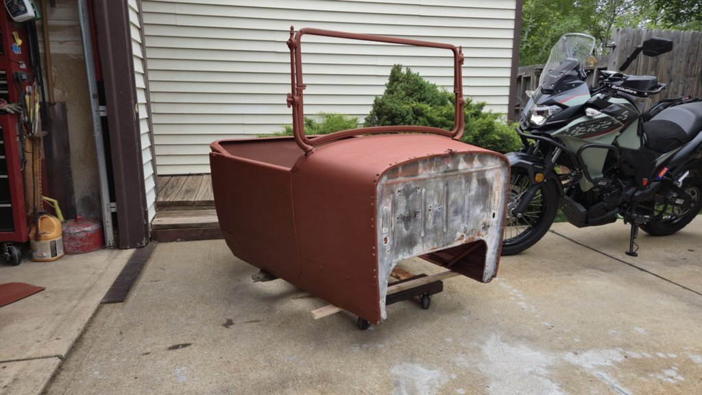

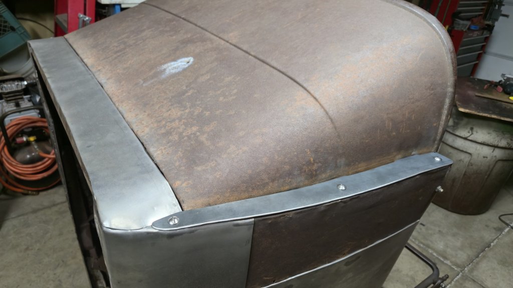

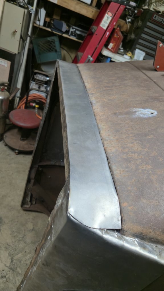

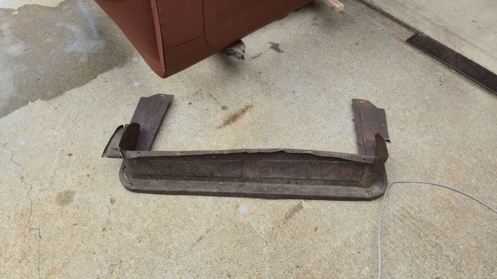

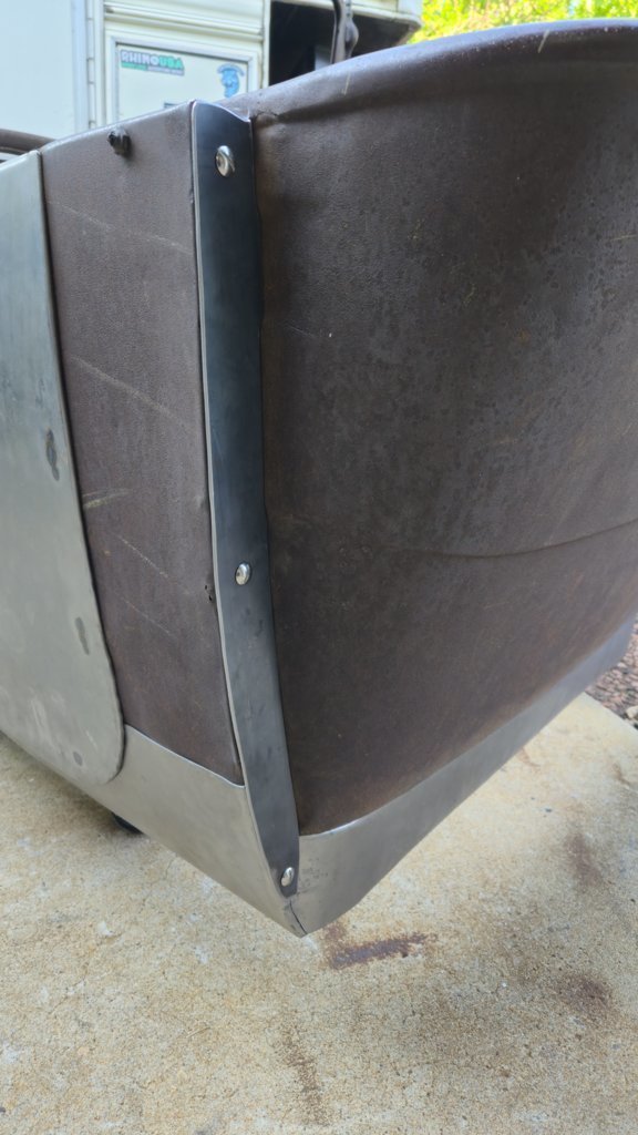

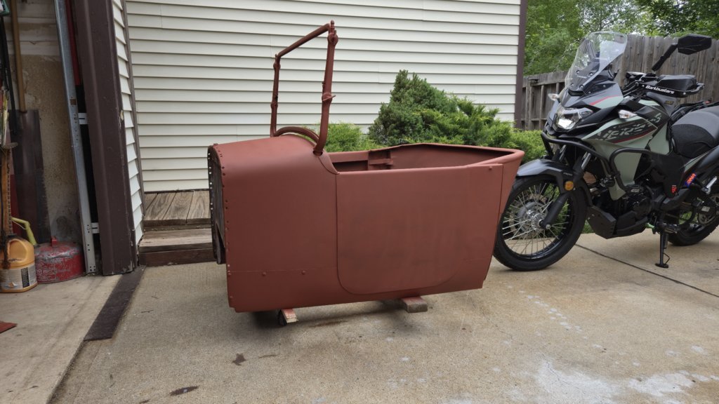

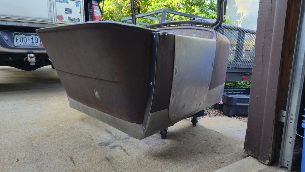

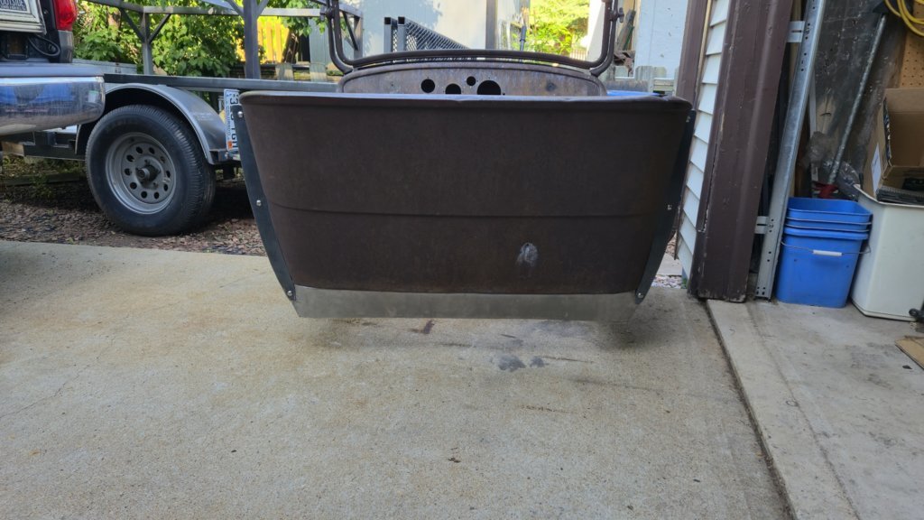

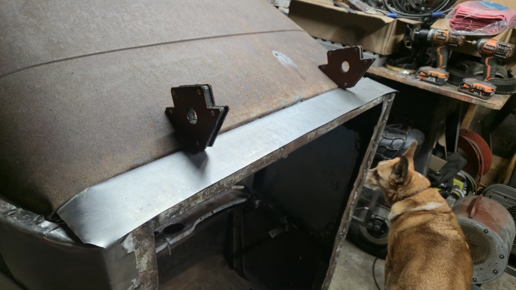

    These were the most difficult to "fit" in place. Not gonna win any fit and finish awards, and I'm ok with that.
    I gave it a 1/2" bend up top and self tapped it from the inside. The bottom edge just rests against the tub. This took a couple days, a little at a time as this was the last of the 20ga.
    Ended up with this panel.
    These were made from 14ga, drilled and tapped into the tub.

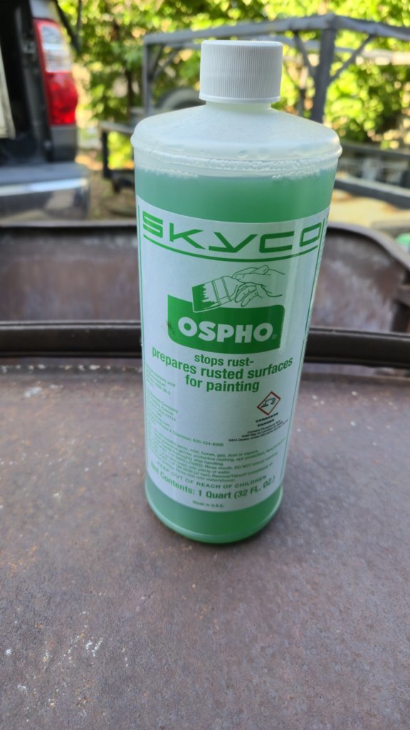

    Next step is rust converter, then primer maybe tomorrow.
    Truss head screws look much better. Swapped out the front as well.

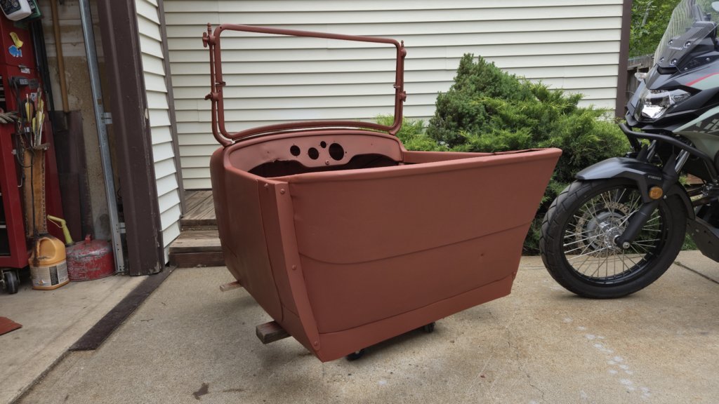

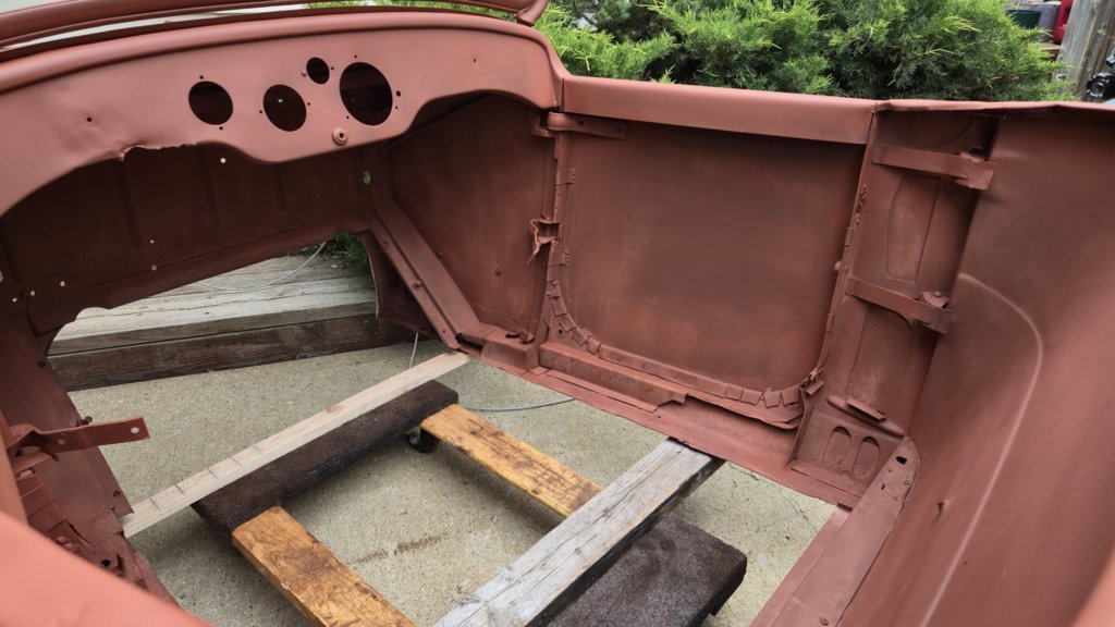

    That rust converter is some nasty stuff. I wonder if this tub has been treated before. No pics of the mess I woke up to this morning, slimy coating of rust slurry, some dry and cured. Moved it outside and the ambient humidity was enough to make the entire thing "wet" again.I rinsed it off, rubbed it down with a scotch brite pad and it was in good enough shape to primer after hitting it with a weed burner to dry it.
    Just an fyi, cover the surface that is being worked over, Pretty sure this is permanent. Good thing my truck covers it and it needs replaced anyway. It was on it's nose during the bulk of the application and the outline is visible. :anonymous:
    Primer almost looks good enough to leave as is. Except it will fade to Pepto pink in the sun.
    Leaving the patina on the firewall for now.

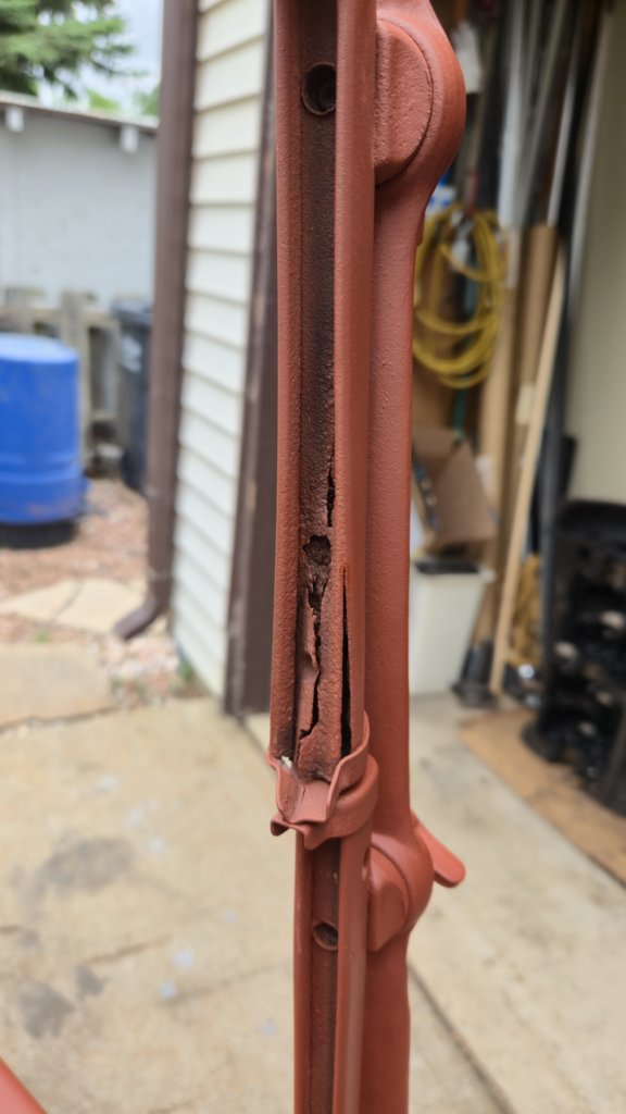

    Still need to address this portion on the upper window frame.
    Took 4 cans of primer for two coats on the outside and one on the inside. Not bad for being so rusty.

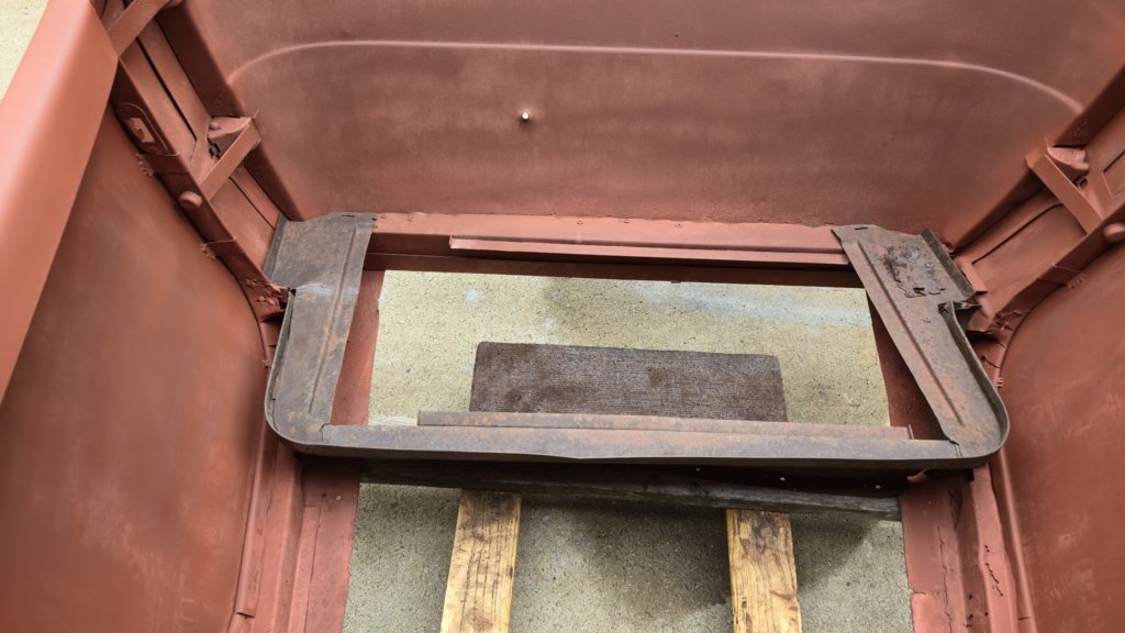

    Next up is this section, which I suspected was the seat.
    This pic is the first time I have had it installed correct. I was trying it upside down and backwards for the first couple dozen times.:p
    It's bent all to hell, missing one trim section, but otherwise salvageable. The ride height after upholstery should be perfect.

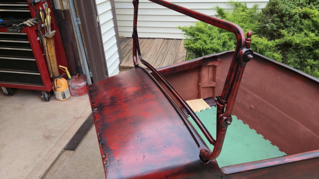

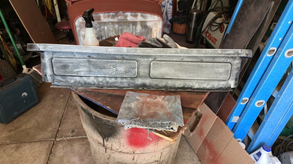

    Got the seat pan figured out, and currently using it for a test piece since the surface has the same rough characteristics as the body.
    Not sure if I like it, or if I'm doing it right. This is the 2nd attempt, it's easy enough to paint over it and start again. Supposed to look like distressed bare steel. Might need more or less silver.
    Another option would be to go with an actual color like red or yellow and streak it with black.
    Found a complete engine, trans, radiator, etc, still sitting in the truck in Golden CO. Been sitting for 30 years with no carb (open intake) and the hood down (not a split hood, so there might be a chance). No other information other than make offer. Would be nice to know why it was parked. Still looking.

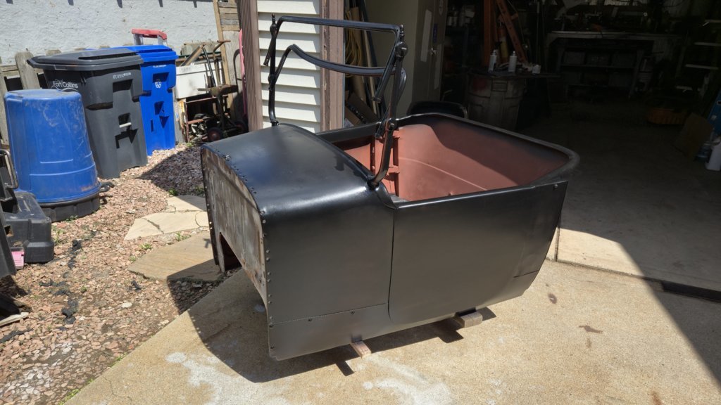

    That engine build book is being delivered by bicycle. It left Florida 8 days ago, it's currently in Grand Prairie Texas, estimated to be here by the 18th.

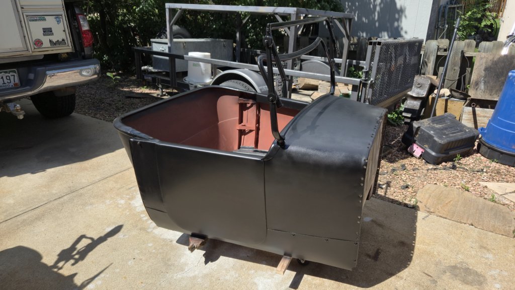

    Watching black paint cure today.
    Satin finish does not look bad at all, from 10 feet away. Tempted to just leave it, but I'll go ahead and try the silver rub after it cures. Black alone shows every dent, ding, hammer mark, etc. Primer alone hid all that pretty well.

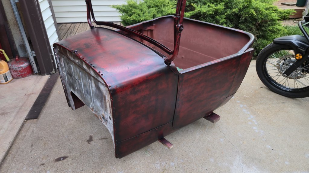

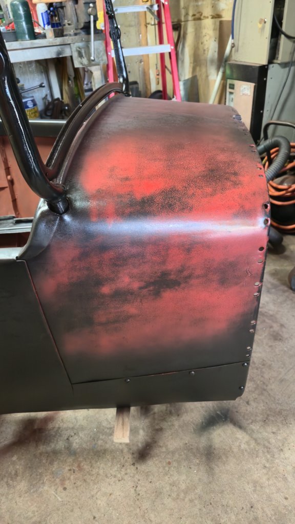

    Quick sample before I go off to work. People who know me will say I have commitment issues, and they would be correct. I kind of like this look better. Faux patina.
  15. Jun 12, 2025 at 5:14 AM
    #75
    Deathbysnusnu
    Deathbysnusnu [OP] Work is just a daily detour to happy hour.
    Oct 4, 2013
    #113825
    17,223
    Brett
    Fort Crawlins, CO
    Vintage Tundra
    Dog, camper.

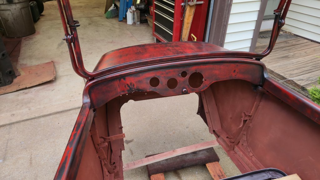

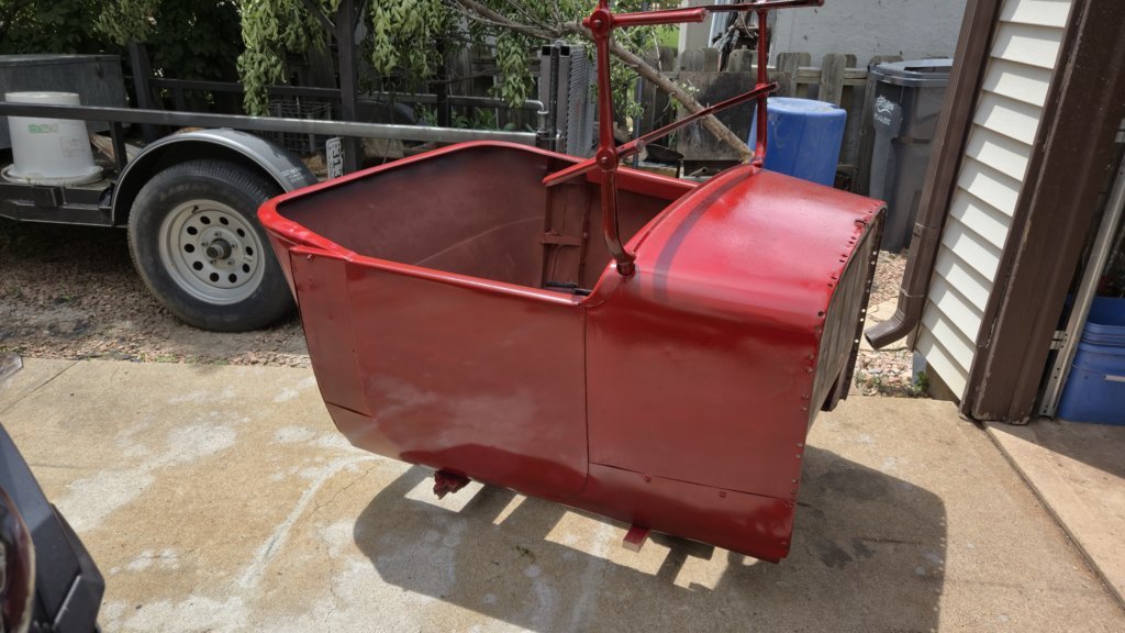

    It should last another 100 years now, 5th and 6th coat of paint. The sample pic was black base with red rubbed in. Trying that later didn't work out well, so went with red base. International gloss red.
    This is where it's currently at. The more it's rubbed, the more red comes thru. Kind of a black cherry look.
    The rough rusted surface actually lends well to this process. The smooth fresh metal does not. At all.
    Original steel is done pretty quick as the pits hold the paint. The smooth, is a challenge to get the fade and not have it just rub off.
    This color combo hides the imperfections quite well.

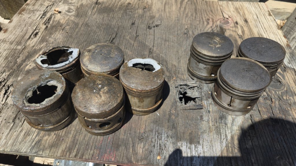

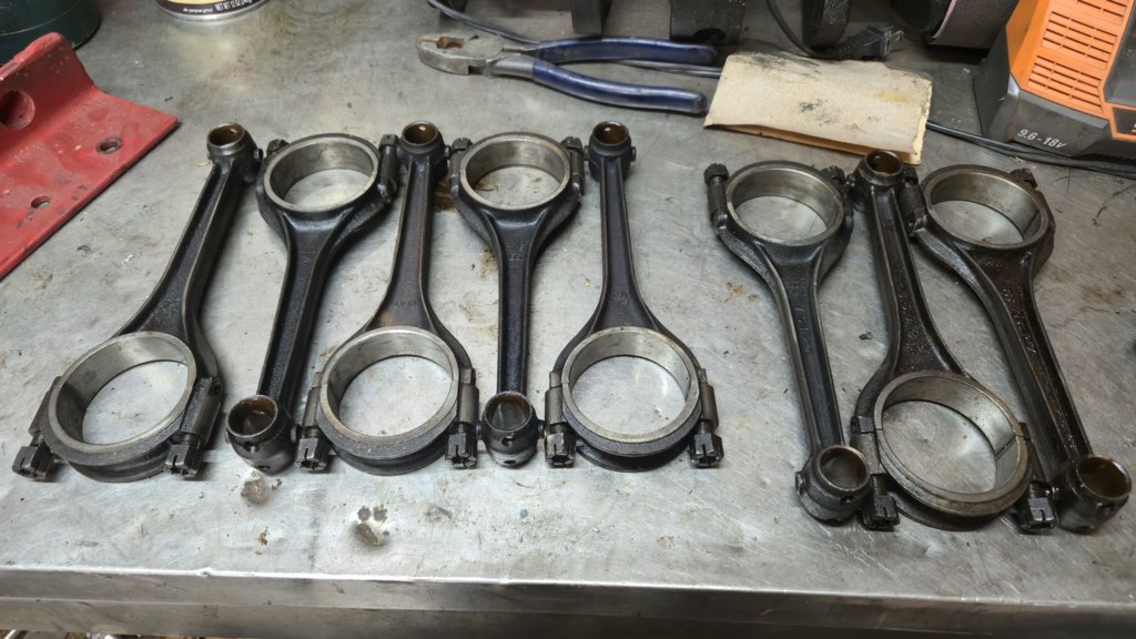

    It's 100° out, what better time to swing a 3lb sledge and pound some pistons out. There was no way in hell these were ever gonna break free on their own. :rofl:
    The carnage. Three on the right were the ones that came out on their own.

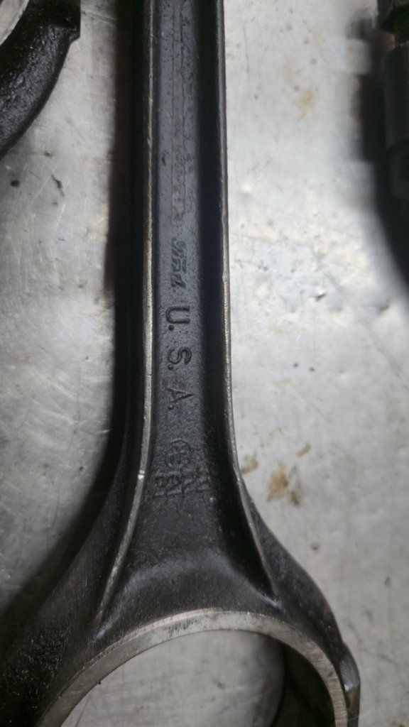

    This brings up so many questions that will never be answered. The three rods on the right belong to the "good" pistons, all stamped Ford and USA.
    the other 5, no Ford, some have USA, all 8 have 29A on them.
    The book mentioned that sleeves are installed when the block can no longer be bored.
    This cracked block has 8 sleeves, it's been around the.....block. :D
    At this point it can be taken down for recycle and I might get like $8 out of it. Cast ain't going for all that much.
    The 8BA block has one sleeve and the other 7 measure the same as the sleeve, so it may be just fine for a rebuild.
