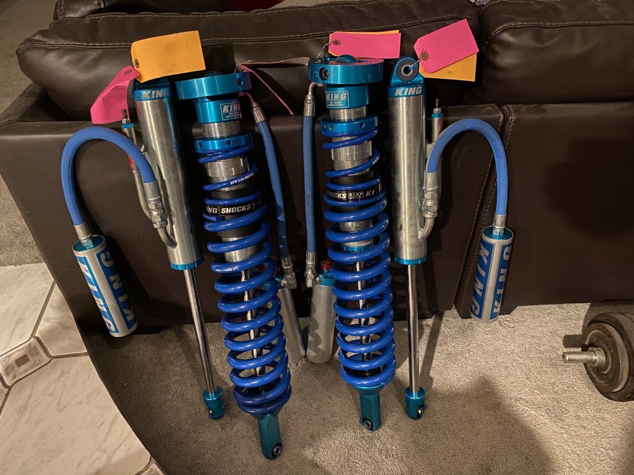

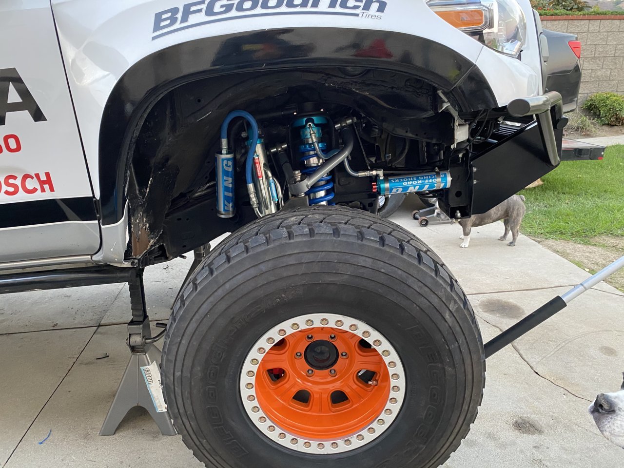

    Picked up the shocks from King designed for this mod. Just waiting for the front crossmember to finish up. Then I’ll start the 3 link rear suspension.E90998AF-0C2F-488E-A14E-2CE311D69FE7.jpg

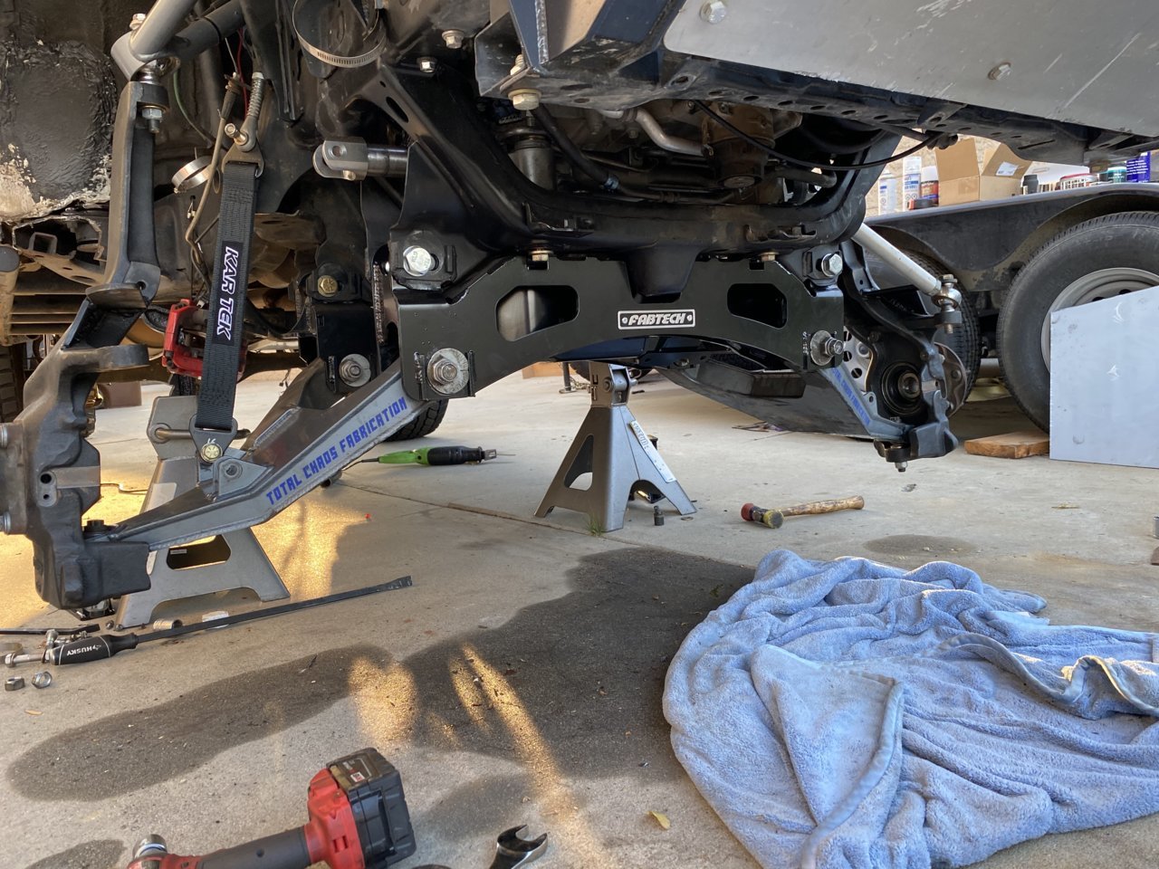

    4A27FA06-26D2-4EF4-AAA5-63486C3EA8B3.jpg Picked up all the parts from Fabtech today. Look how much more clearance I have. Way more than RCLT +2 Kit. I’m glad now I went this route..

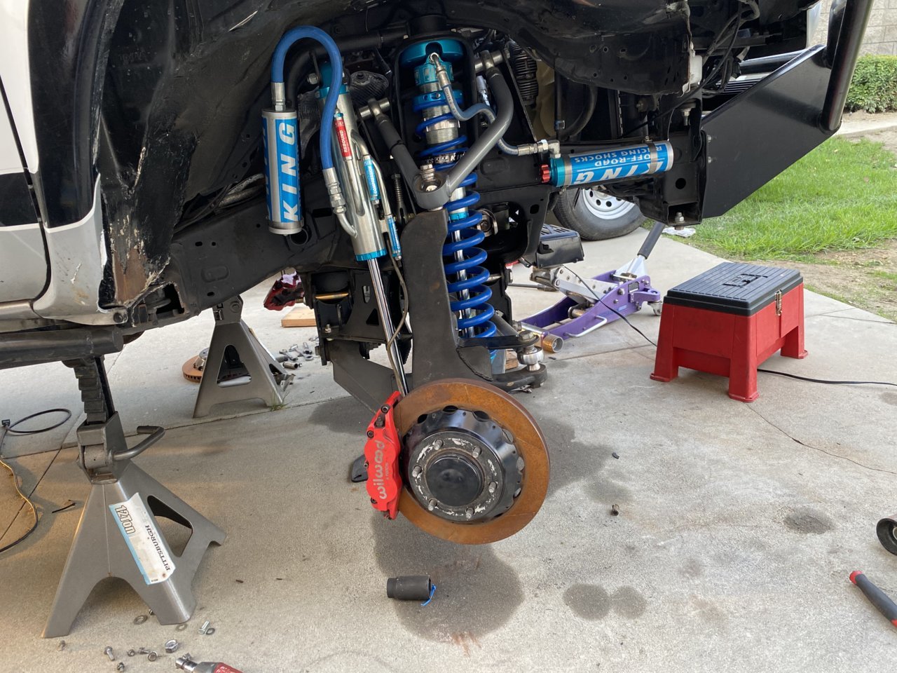

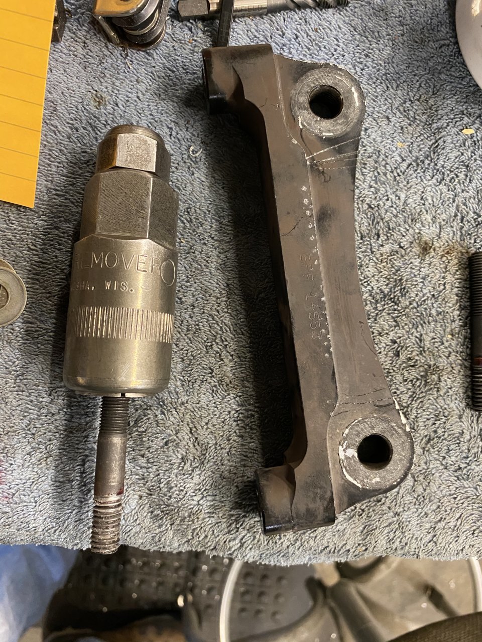

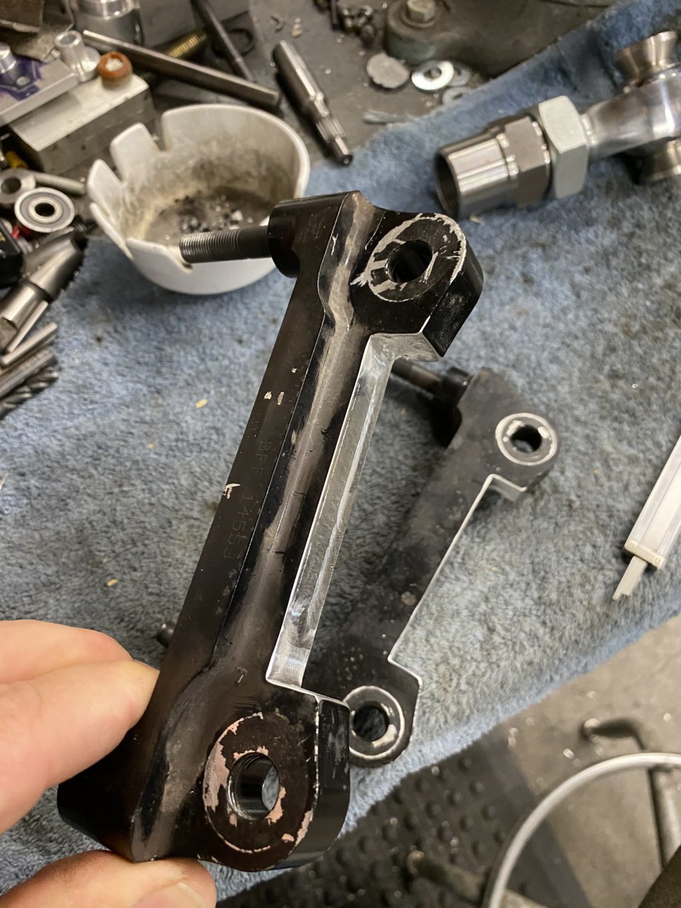

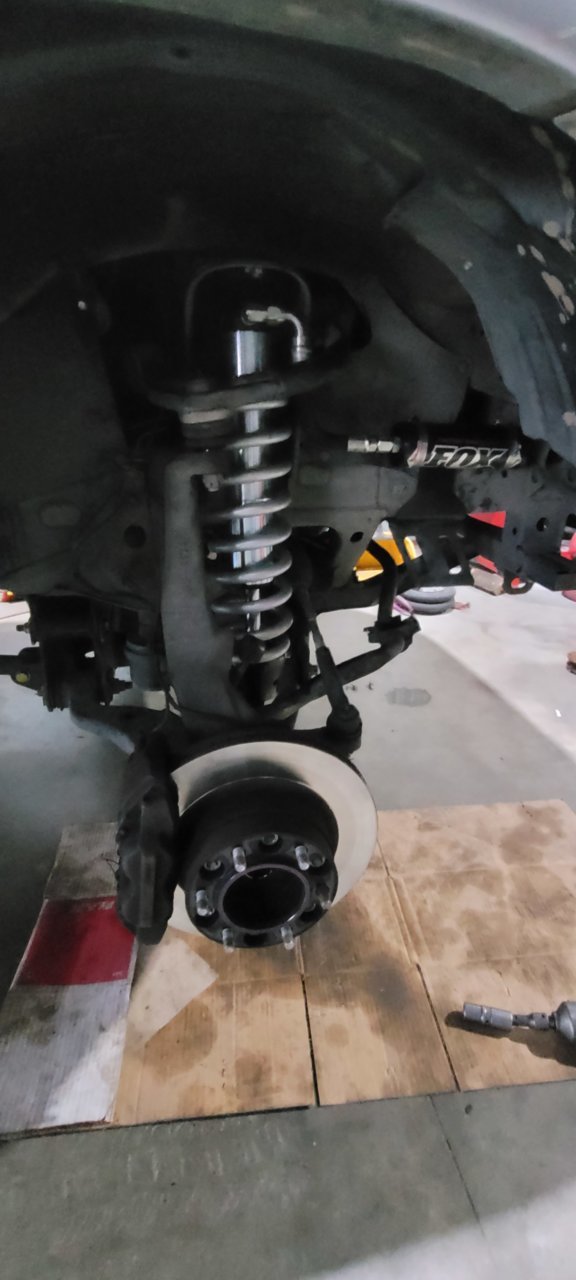

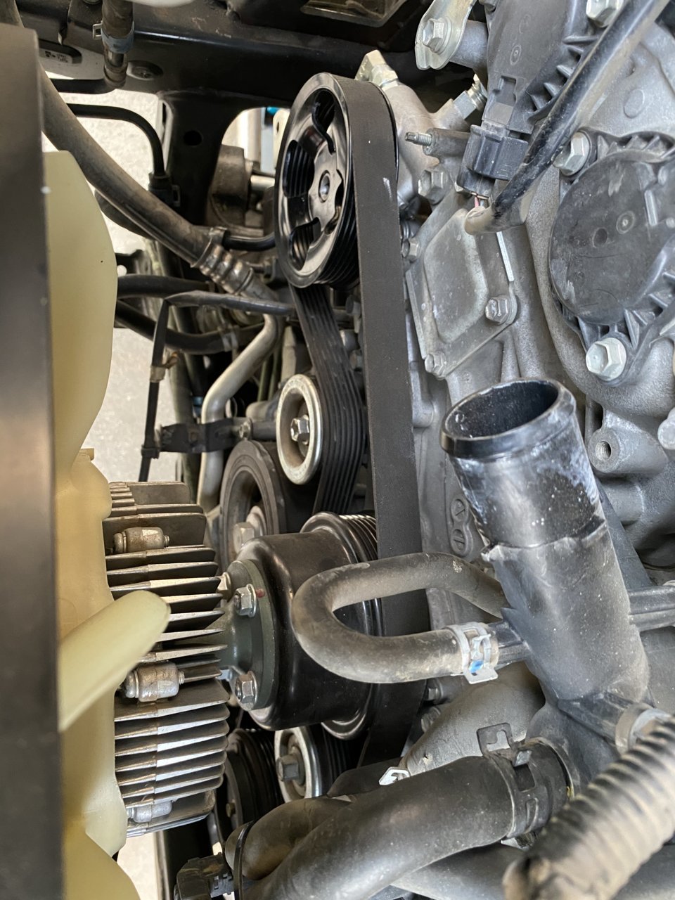

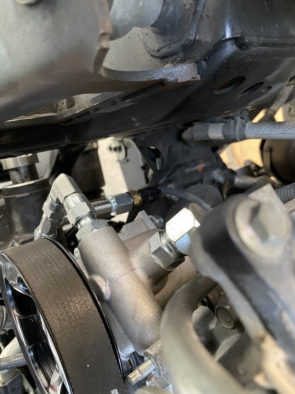

    335FA407-3A28-45E8-B095-3D02F167FD57.jpg A286044E-3538-4327-908D-A4C397CFEC1C.jpg So my Wilwood brakes didn’t fit on the new knuckle. So I put them on the mill and fixed them. Triple bypass shocks hit the frame had to clearance the frame with sledgehammer. The coil overs hit the driveshaft had to clearance them as well. When we measured for shocks the drivelines were not in. Seems like every part on this build needs to be massaged to fit. Good thing I have a machine shop or I would be so screwed. I’m almost done with the front.... got the serpentine belt on and the 1450 psi steering pump is in all I need to do now is bleed the rack and pinion 0AF0A1E3-95D9-4A26-954A-DDD222D13BA8.jpg86C86BCC-F184-4D7B-BC39-7523C7C77F5B.jpg

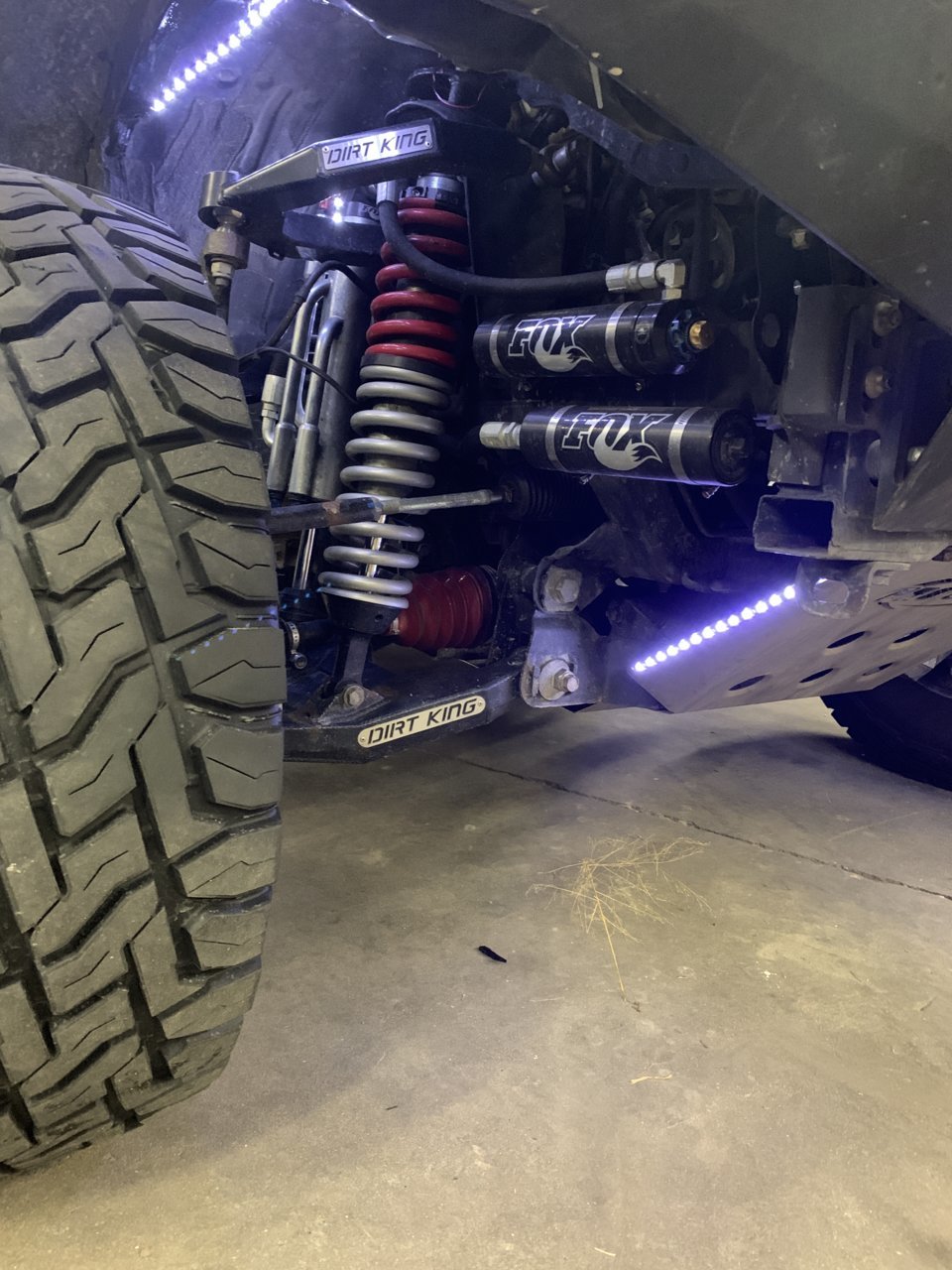

    I did something similar a few weeks ago for a friend. It took a few years for the manufacturers to start producing 6" lift shocks with drop bracket. Finally accutuned had an awesome solution so here we have some fox 2.5 on a pro comp drop bracket lift. Ultra comfortable!

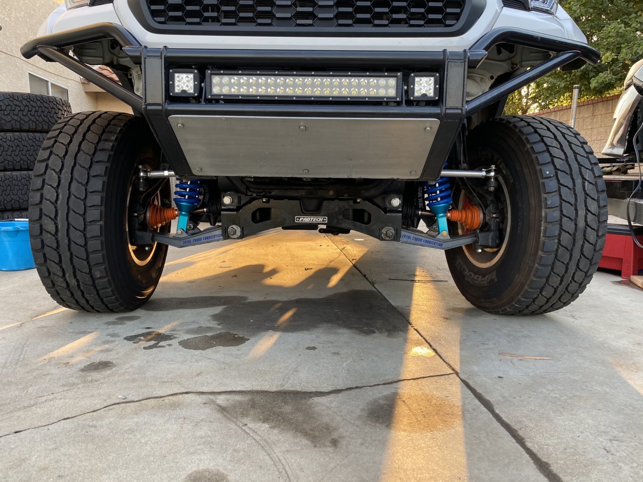

    29B69F74-9DBC-4DA9-BA6B-65DDCACD76C0.jpg FC0EE680-91FB-47EA-BF3B-F108EB54809C.jpg O ya ! Welcome to the party. So this is where I complain about the fuckers that put my truck tougher. I’m so glad I’m doing all the work this time. When Dosilate built the truck they never fixed the camber. Driver side is neutral the passenger side is - camber. Good thing I have adjustable Heims on the top A arms. Passenger side no threads showing and driver has 4 threads showing. The alignment shop never said anything I figured I paid good money to have the long travel kit installed so I figured it was always correct now I know different. Also when I centered the rack and Pinion I found out the steering wheel is not straight this is why the truck will not do a U-turn and makes great right turns. As docilate never centered the rack and pinion to center of the steering wheel. This LT bracket lift has been a bear to say the least having the Solo Tundra Rack n Pinion just makes it harder and I own a machine shop! King took 3 weeks to build the shocks and the spring retainer hit the drivelines and needed to be machined to clear the shafts. The frame hit the Triple Bypass and that had to be addressed. The tie rods were to long and I had to cut them and retap them. The stock Bumpstops were to short and the Fabtech bumps were junk and didn’t work earthier. The Wilwood brake mounts didn’t bolt up to the new knuckle so they had to be machined to fit. I put the wheels on and the rim hits the tie rods. Fuck me. So today I machined a 1/16 hubcentrick spacer. Now that problem is cured. I have pulled this kit off the truck and put it back on at least 5 times. Good thing I have 5 other vehicles I can drive. I should be finished this weekend and ready to start the 3 link rear. So ya thats my Dennis Miller Rant lol
