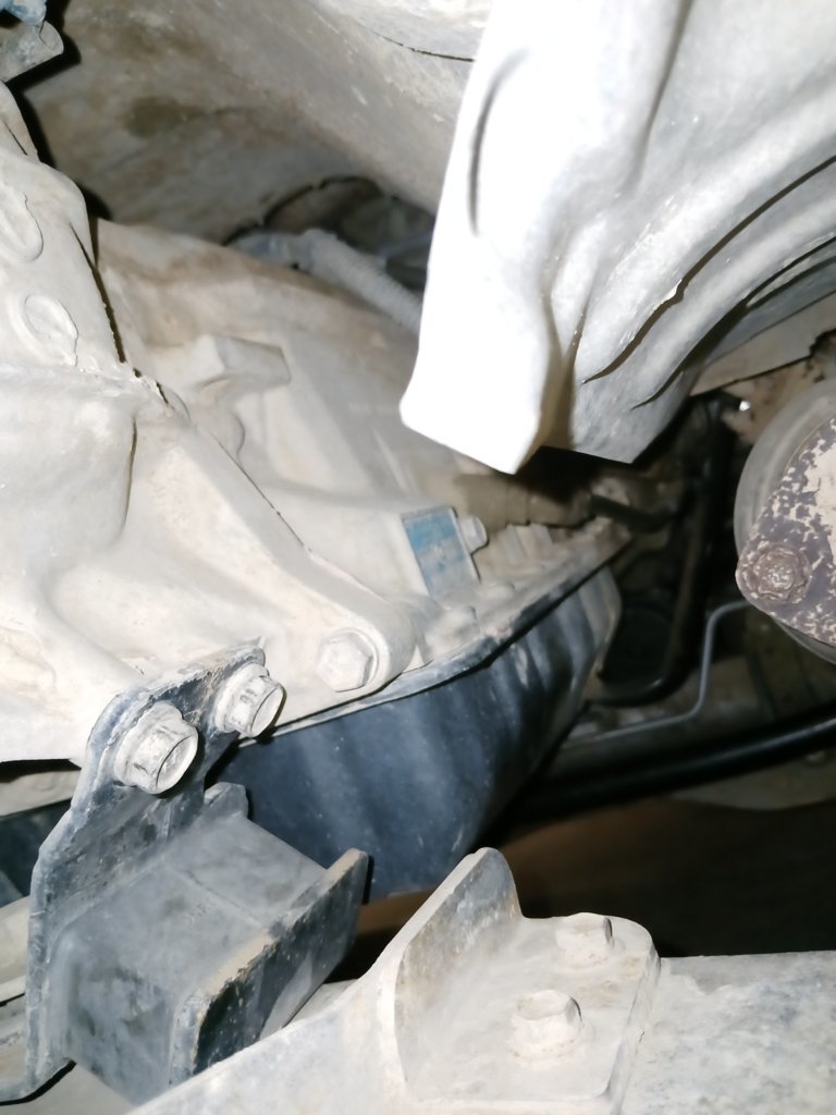

    snap some pictures of the transmission tunnel for us to see

    I'll add pictures when I get off work.
