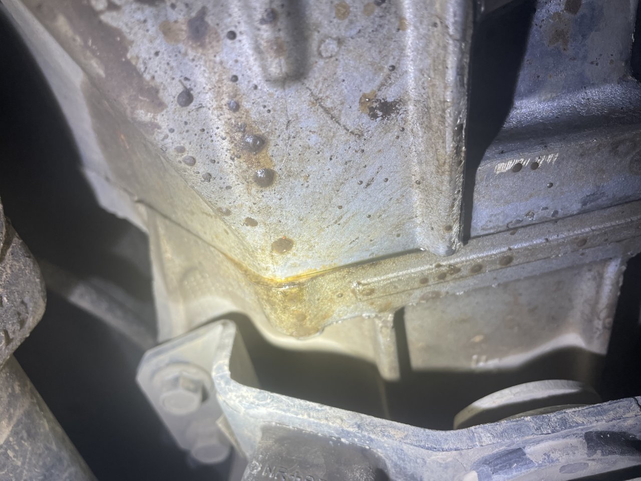

    19 w/ 50k miles. Noticed it leaking where the t case meets the trans. It hasn’t started leaving a puddle on the driveway , but there’s definitely oil there. I’ve read other posts about dealers not doing anything about it til it actually “leaks” which I find complete bs and I hate dealing with dealers already. Has anyone had the same problem and fixed/had it fixed? If so, what was the issue? Is there a seal that keeps the gear oil in the t case where it meets up to the back of the trans ?

    looks more like a leak than a weep

    Pretty normal if you wheel it, since you are constantly trying to twist all the mating surfaces. I just completely resealed mine at 60k since it was leaking from pretty much every joint, and used the right stuff rtv instead of the red stuff toyota uses.

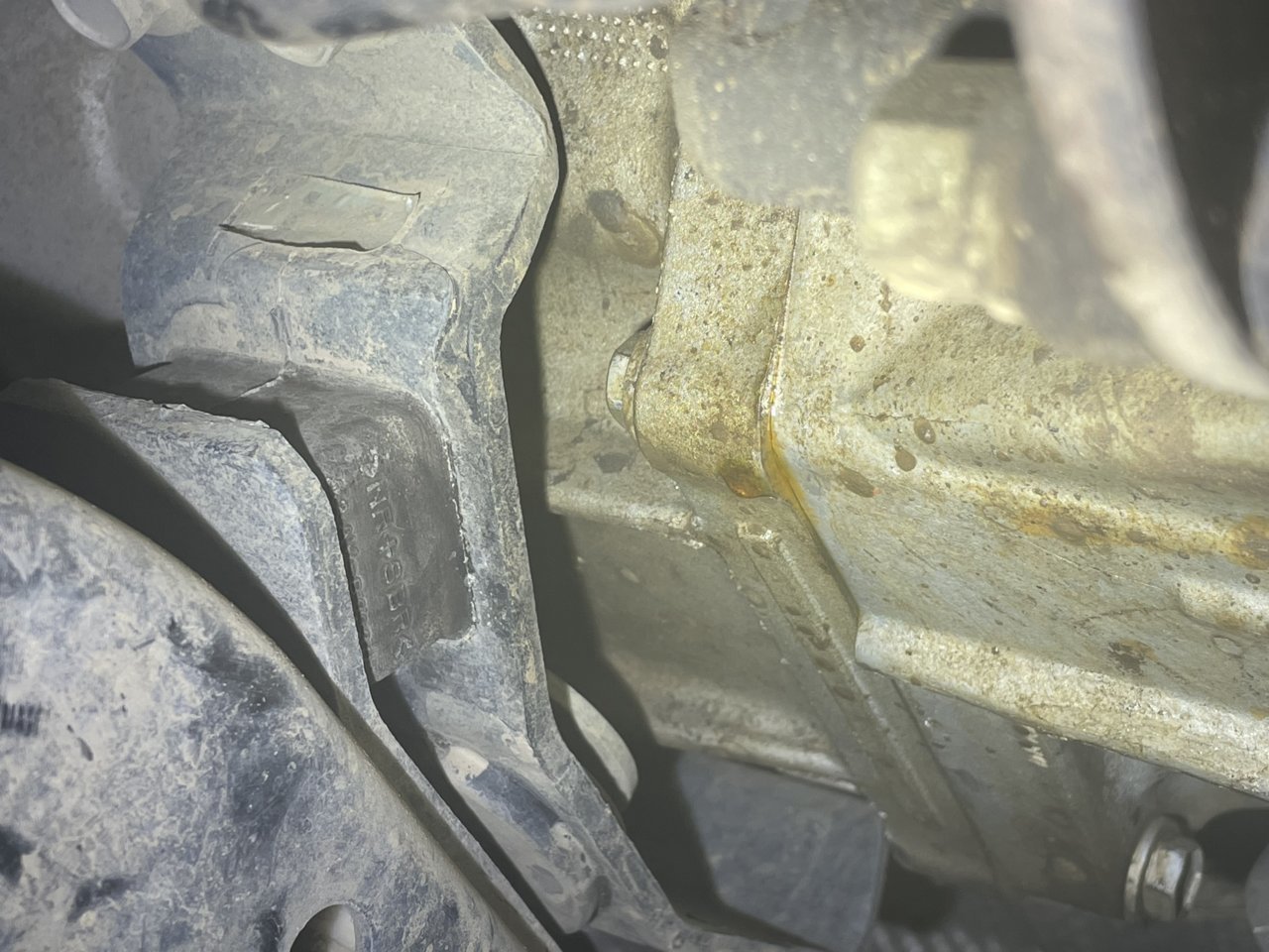

    Took it to dealer, tech says it’s trans fluid. I spoke with him over phone, he’s swearing up and down the t case seal is dry but the fluid is leaking from trans seal. That’s some strange looking atf to me

    They’re replacing the trans seal. But like I said, I swear that’s gear oil. Never seen any trans fluid looking like that before , ever.

    Theres no hiding the smell of gear oil.

    I just looked at it in person. The front of the t case is dry. Sure nuff it’s the rear output trans seal. Will be covered under warranty.

    It definitely is. It’s really hard to describe and it’s really weird to see but it’s def trans fluid. It looks gold til u get close to it and put a light on it. Front of t case is dry.
