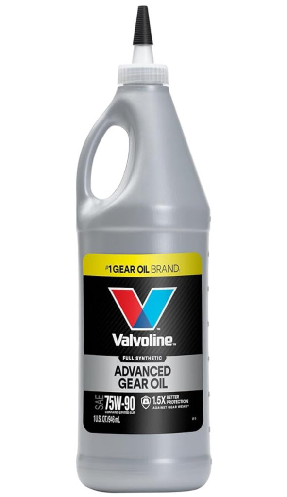

    Thank you for the suggestion I was thinking of doing this but didn’t have an empty bottle laying around to use and didn’t really want to just buy a bottle to dump the oil out and use it. In the future I will save one of these style bottles.

    Redline MT-LT 70w75 is also acceptable and what I put in mine at 30,000 miles and 10,000 miles later no issues.
    https://www.amazon.com/Red-Line-RL-...v&qid=1750797035&sprefix=mt-lv,aps,124&sr=8-1
    I put mine in a gear oil bottle with a bit of hose and was able to fill the TCase with out a pump. I did use a pump for the front diff. but you could gravity fill that with a longer hose and a person above and one below to keep the hose in the front diff fill hole and to say when it's full.
    Ravenol does have a nice straw in the bottle for you and it a full litre not a quart.
