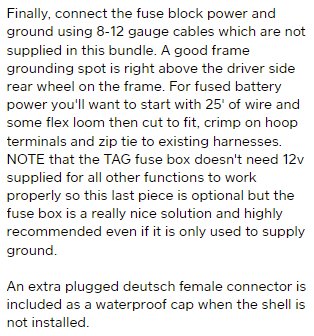

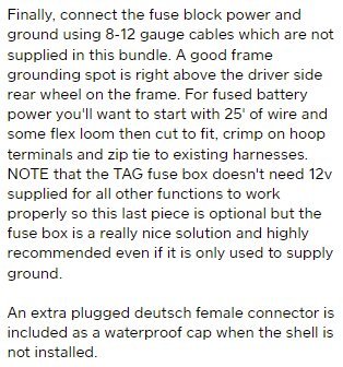

    What is "5. Power from taillight fuse box (sold separately) at 42" to flange" for on the TAG Harness? To run an additional auxiliary fuse panel (in addition to the fuse panel mentioned in the item description that mounts to the taillight cavity? besides the TAG fuse panel (for brakes, bed lights, and locks)? Is there a relay used in this harness that requires the power from the taillight fuse box? If I look at all 3 pieces individually without the flange connector, I do not see power being required or a relay being mentioned unless if a high amp draw is anticiapted.

    Not sure I understand why that portion is necessary besides grounding from the flange for the 3 functions unless one or all of these functions are setup on a relay.
    I see your write up for the last step somewhat explaining this, but I am not sure why this wire (#6 on diagram? / "5." on Description) is there in the first place:

    Aux power is part of the TAG setup. So I include it as the 6th wire, pinned from the fuse block and intended to use the 3D printed fuse block case that is made by TW user @switch
    On my own truck I still have to run power for this. I use it currently as a ground distribution only.
    So I have power pinned from it to flange to TAG but no power in from the battery and not using it off the fuse box yet. Presumably I might one day do that and feed my shell dome tube light with it, having constant power since that tube has a switch. Then use my Matt gecko kit for the unswitched dome fed from my switch pros triggered by cab dome.
    no relay is needed for this, a relay would be used if you have a switch driving a high current device. Here we are merely trying to provide fused battery to the shell.
    another use might be usb charging or 12v power socket or possibly ignition switched power (then you use a relay) to feed something like a shell mounted camera. Your options on sourcing power in and consuming that power are specific to your needs.
    it’s mostly because the tag has 6 wires in and the flange too so I include it per the TAG spec.
