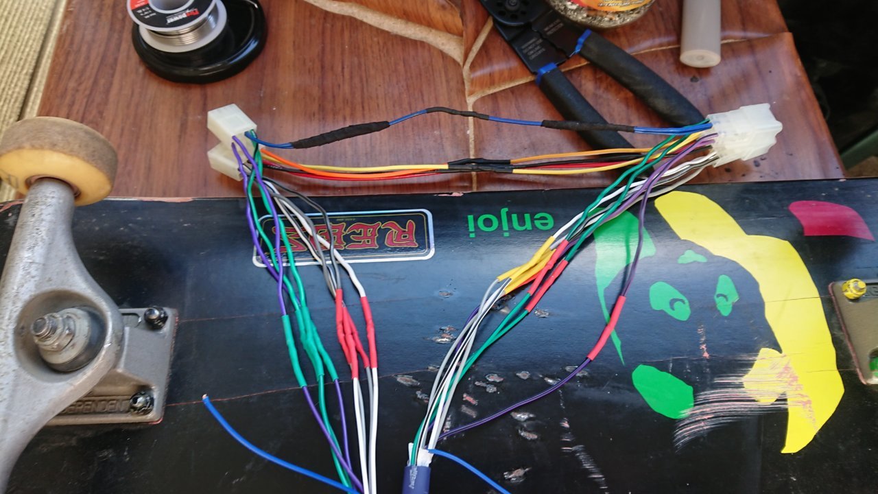

    Hello everyone, finally decided to build this myself and just wanted to make sure it was correct? Anyone?

    Looks correct from what I can tell! Throw some zip ties or Tessa tape on it to clean it up a bit and you’re ready to roll!

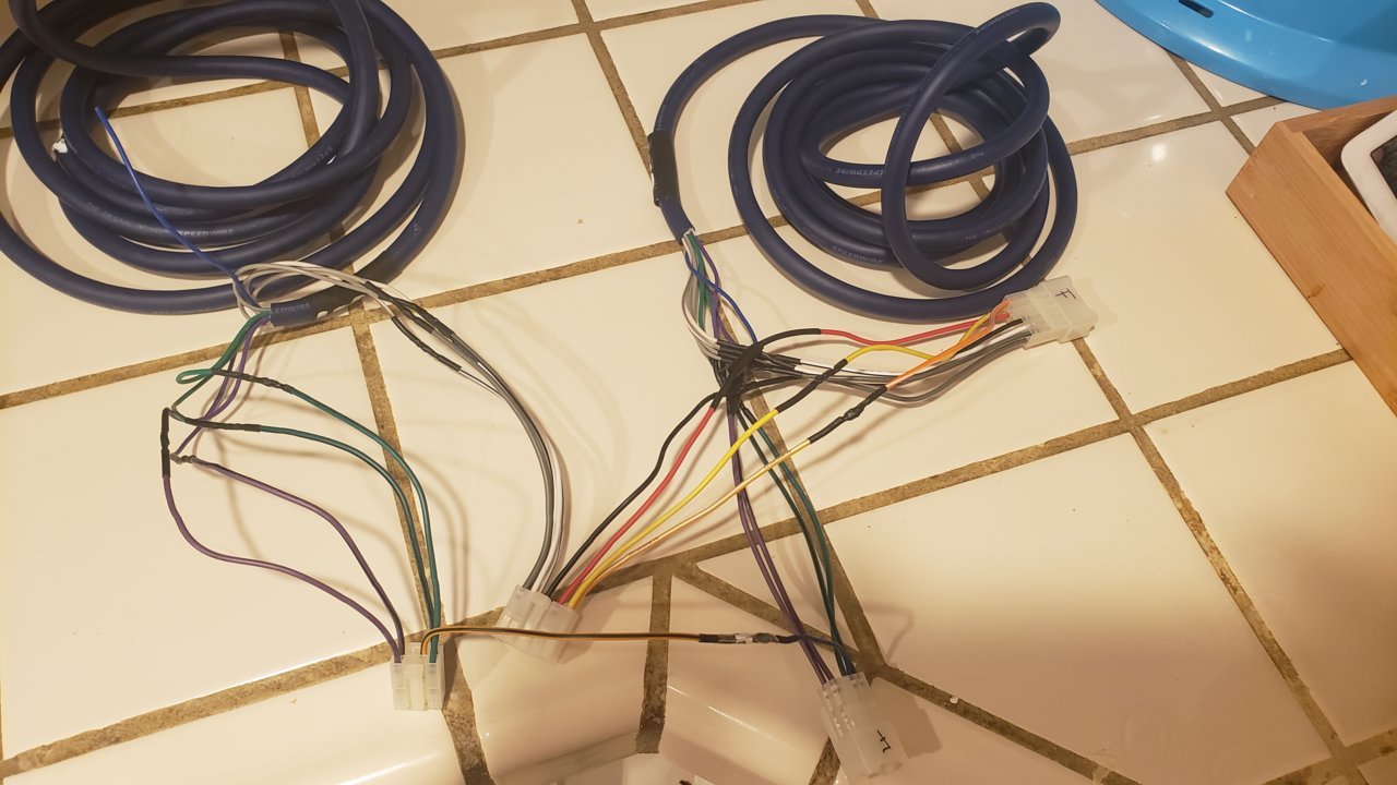

    And be absolutely sure you get the correct roll of speed wire to the correct place. Label the ends of them now before you run them through the truck. In the picture above, The right roll (with the female connectors) will be connected to the amp’s OUTPUT and the left roll (with the male connectors) will be connected to either your LOC or the amp’s INPUT.

    The first time I did a speed wire harness like this, I didn’t label them and couldn’t tel which was which and ended up having to bust out the speaker popper and the multi meter and all that fun stuff. Wasted half an hour of my day because I forgot to label :annoyed:

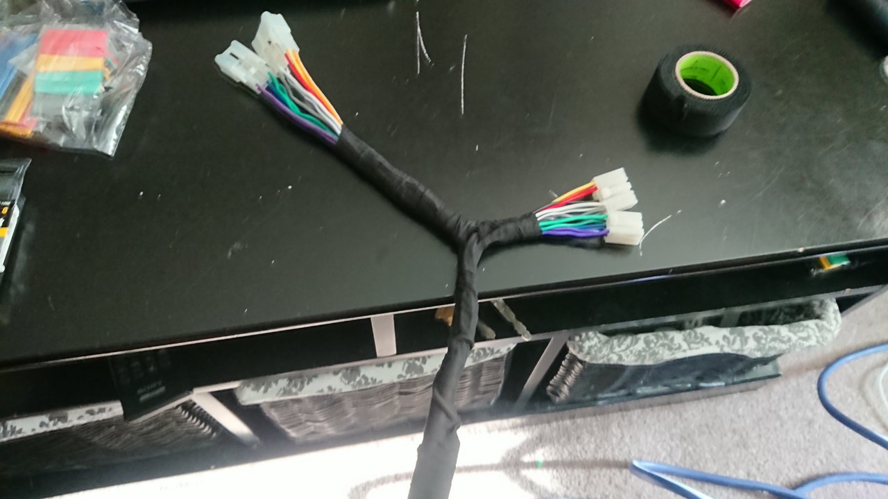

    I just built my T-harness a few days ago. Was a breeze if you're comfortable with a soldering gun. Good job with your harness. Here's mine. And it works great. I left out a remote turn though.
