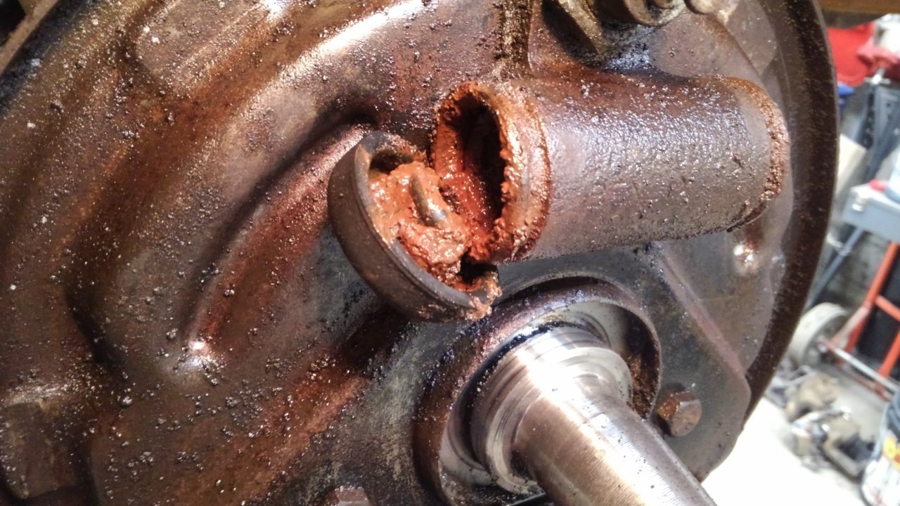

    Normally when you service drum brakes no bleeding will be required, you aren't opening the hydraulic side of the system and the wheel cylinders don't need to be pushed back like a caliper.
    You won't do anything to the wheel cylinder except gently pull the boots back and look for leaks and rust.
    This is a good example of what you don't want to find under the boots. DO NOT step on the brake pedal with the shoes off (or the drums), it will blow the pistons out of the wheel cylinders.

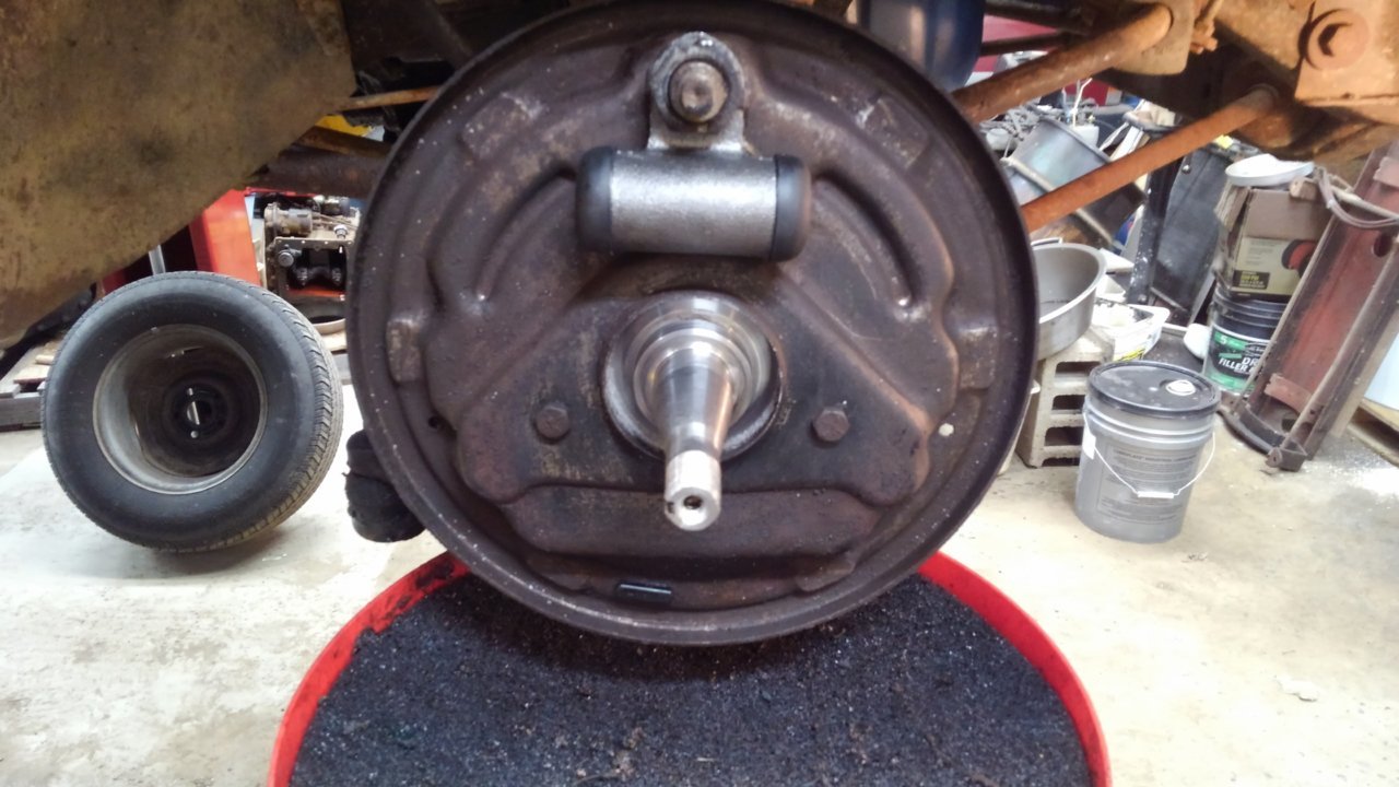

    After you have stripped off most of the parts it will look similar to this except you will have the axle flange in the way and the hand brake cable and lever -- this picture is from an old car with drum front brakes.
    Notice the six flat around the perimeter? That is where the shoes ride, they need to be clean and smooth with no grooves or burrs, add a light slick of the brake grease on the flats. The rubber plug at the bottom pops out so you can use the brake spoon to turn the star wheel adjuster.
    There is a tool to keep the wheel cylinders together when the brakes are apart, not normally needed for routine service -- just don't step on that pedal when the drums are off.

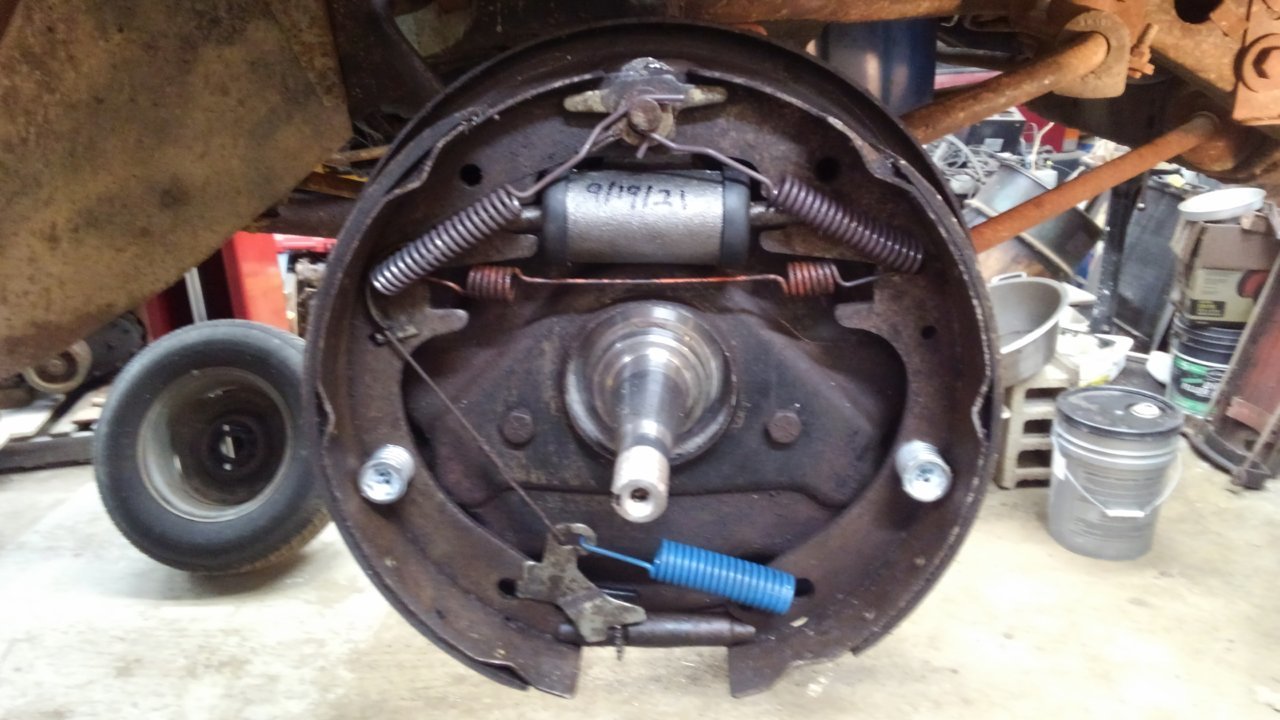

    Although not from rear of your truck the photo below pretty clearly illustrates drum brakes. The 3 springs at the top return the shoes to the resting position. The silver coil springs are the hold downs. The blue spring/arm/star wheel and cable are the self adjuster with the rubber plug for access behind it.
    The star wheel sets the clearance between the shoe and drum in the resting position.
    Too much clearance results in a low brake pedal and the shoes will wear at the top.
    Too little clearance and the brakes will be grabby and lock the rear prematurely.
    About the shoes:
    Look carefully at the lining material, it is shorter on the shoe on the right side of the photo then that on the left. The short side lining is called the primary shoe and always goes to the front side of the vehicle. This is the passenger side of the car.
    Notice each shoe has 3 indentations on the metal edge near the lining? They are places to hook the pin end your brake spring pliers, the hook end goes around the hooks on the springs.
