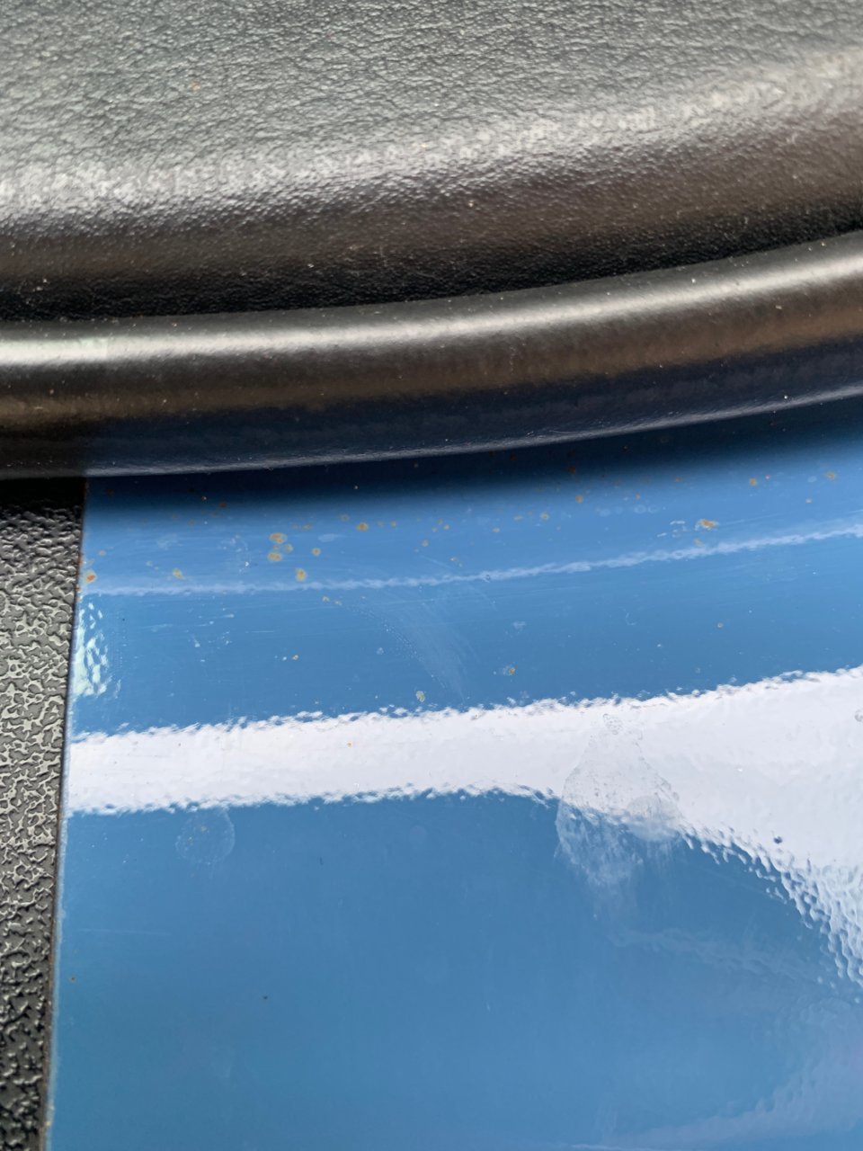

    That's not what I'm saying. What I said is yours appears to be on surface (metal shavings on surface) that rusted. Doesn't look like the others, that have rust problems.

    My buddy checked his ‘18 Pro today:

    To me that looks like rail dust, not what like the members other with rust blisters. I bet yours and his would come right off with a clay bar. I admit the other have a problem, with rust coming from under weather strip.
    I hope you guys get it resolved.
