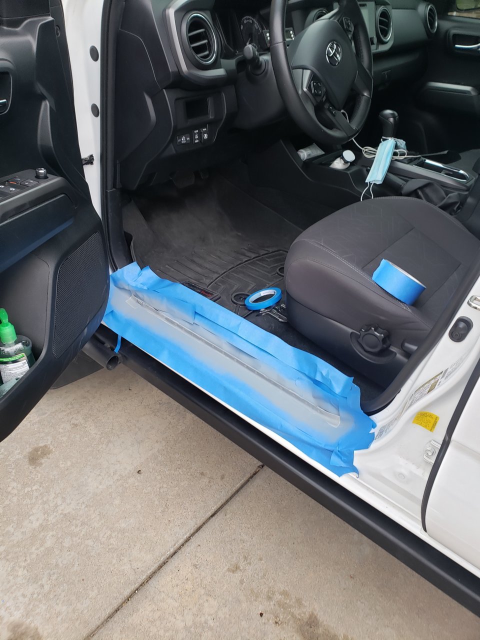

    2017 at 49k miles my local dealership 'Eddys Toyota ' wouldn't bother. I forgot to take before picture but the corrosion is around those 2 pitch welds. 20201121_105755.jpg

    Currently seeing if Toyota will cover mine (doubt it). If not, it's rust-oleum and touch up paint for me!

    Wichita Kansas
    You gonna get some 3m seam sealer for the pitch welds? Thats what they applied on the tsb

    2017 Black TRD Off Road 4x4, 2019 MGM 4Runner SR5
    I've thought about it, but honestly, I don't see the need. When the body shop took my trim off to take photos, it didn't appear to me that it would have made a difference. My guess is somehow road salt ended up getting under the trim. My driver's side has it, the passenger side less, and none at all on the rear. Maybe I'll change my mind though.
