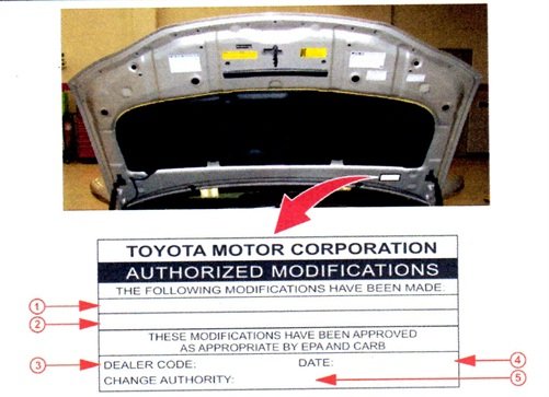

    Apparently, as part of the TSB, Toyota will place an "Authorized Modifactions Label" to the underside of the hood. Should look something like this...
