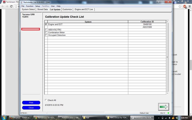

    By the way i wanted to verify that Simi Valley toyota DID IN FACT reflash the ecu. (verified by the calibration ID in reference to the tsb itself)
    I verified this by way of a techstream cable and techstream software (same shit toyota has)

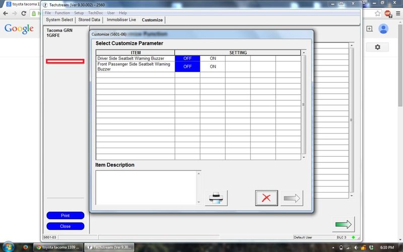

    Also verified that yup... seatbelt buzzers on or off can be customized (had already turned these off via blutooth and a telnet terminal)

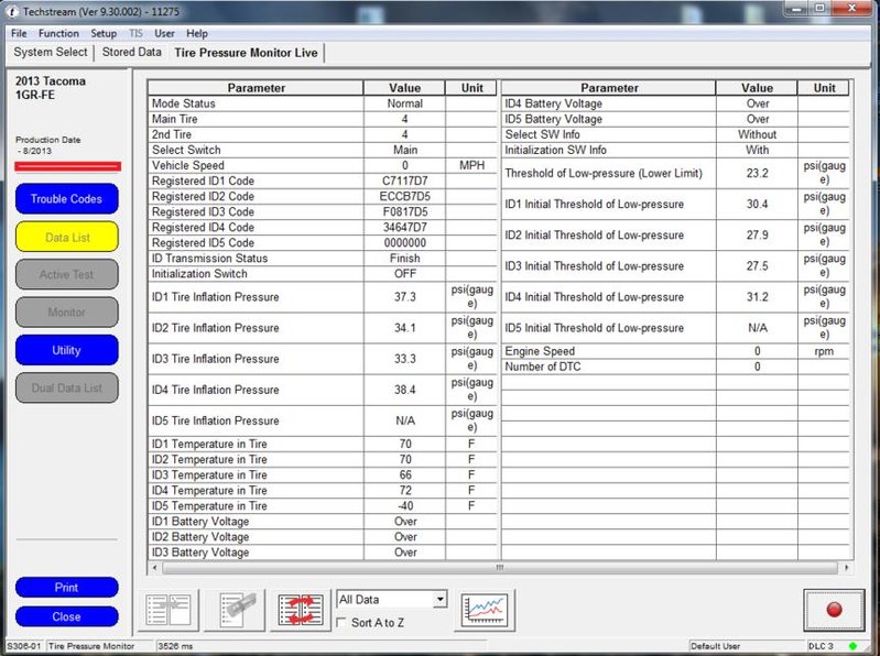

    BTW.... did you want to know exact wheel pressure and temperature... NO PROBLEM

    ^^ Sweet! Now can you elaborate on "had already turned these off via blutooth and a telnet terminal"? I assume it's not that easy and I need special hardware/software to do this?
  13. Feb 4, 2015 at 6:58 AM
    #393
    127.0.0.1
    127.0.0.1 AKA ::1
    Dec 24, 2012
    #93641
    3,915
    /etc/hosts
    2013 NBM AC 4.0 4x4 Auto OR
    a bluetooth OBDII adapter (like elm327)
    and a laptop with bluetooth and terminal software to open COM port
    on bluetooth. putty can do it.
    fairly simple.
    some phones can do bluetooth com port as well
