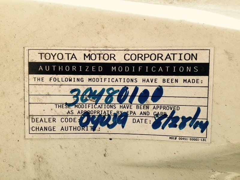

  17. Mar 17, 2015 at 11:40 AM
    #417
    gonathan85
    gonathan85 [OP] Well-Known Member
    Dec 8, 2009
    #27220
    457
    Nate
    Central California
    '13 4x4 SR5 V6 Tacoma
    I was finishing up my 40,000 mile service last night, and I noticed that the dealer DID stick a decal under my hood referring to this TSB. Check out the picture below...
