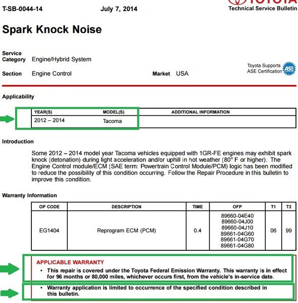

    Check through the time and mileage constraints, if any, and make sure you meet those requirements on the TSB. If you do, then go to the dealer with the TSB on hand, and highlight you VIN number. Basically do their homework for them. Also, read through the customer symptoms description on the TSB, and use some of that language with the Service Advisor.
    Once he understands it's a legit TSB, he should set up the service for you at no cost. Make sure also to check there is no labor fee... Toyota keeps mention of who pays for labor off the TSB while its under warranty in some cases.

    I agree with the advice you got from "mbrogz3000."
    Print the TSB found on page one of this thread. Bring it with you. Describe the problem as the TSB describes the problem..."1800 engine rpm...under load...driving uphill....temperatures at or over 80*F."
    The way I read it (see attached picture), Model years affected and covered by this TSB should be 2012 to 2014. The TSB is covered under federal emissions warranty for 96 months or 80,000 miles. It is restricted as warranty only to vehicles that have the described pinging sound present, so you should qualify for free service in this case.

    +1 to the advice Matt and Nate provided. Assuming your "2014 Prerunner 4x2" has its original 4.0L V6 engine, this work IS "covered under the Toyota Federal Emission Warranty." Don't let the dealership off the hook. Despite having shown them the TSB and discussed the warranty coverage when I made my appointment, they still tried to charge me $65 for the work. I had to put the TSB back in front of them AGAIN to get the charge removed.
