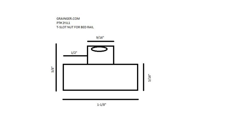

T-SLOT NUT FOR BED RAIL... SO U CAN MOUNT YOUR STUFF

    Amazon wants $15 for one which is really one of the only other places i could source it. if you have a tier 1 grainger account (i do through work) its $3.24 ea

    There is also this option as well: https://www.zoro.com/te-co-t-nut-black-oxide-38-16-916-41406/i/G1777921/. This was a popular choice in the 2nd gen forum for mounting items to the rails.
    If you're Canadian, keep searching because either the company won't ship up north or the cost per each is too expensive to even bother. I'd like to be proven wrong because I could definitely use this on my truck.
    This thread: https://www.tacomaworld.com/threads/bed-rails-attachments.114001/ has a bit more information on what options are available, and even indicates what is available in Canada.

    I bought mine from Fastenal back when I first got my '11. they are perfect. Not as easy to steal as the OEM tie downs.

    Just a FYI...
    Those sit tall and require removing bed rail screws to slide them in passed said screws.
    They also teeter out if you try using them on a section of rail with the position notches.

    I get mine from McMastercarr, $3 each and they have many sizes!

    Good info. I do have to remove bed caps to get them in.
    I haven't gotten then by the position notches but good to know.
