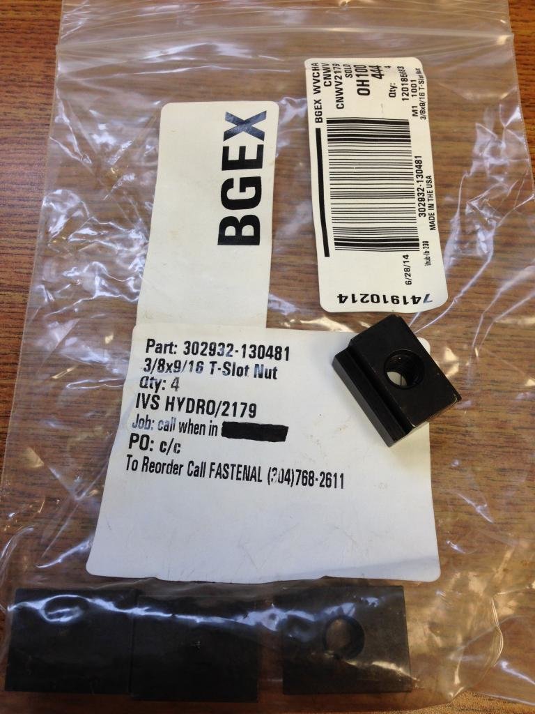

    I know a lot of you have already been down this road but thought I would throw this out there for the rest of the new guys. If you are looking to mount some thing on your Tie down rails here is the perfect t slot nut. I got these from Fastenal. Here is a pic, part number is right on the package. Hope this helps some one!

    Whats the thread inside? I found some at McMaster-Carr, but the hole is 5/8"-11, and that is a bit overboard for most applications.

    3/8 course
    http://www.fastenal.com/web/products/details/302932-130481
    best thread out there...all my added on stuff is the same thread :D

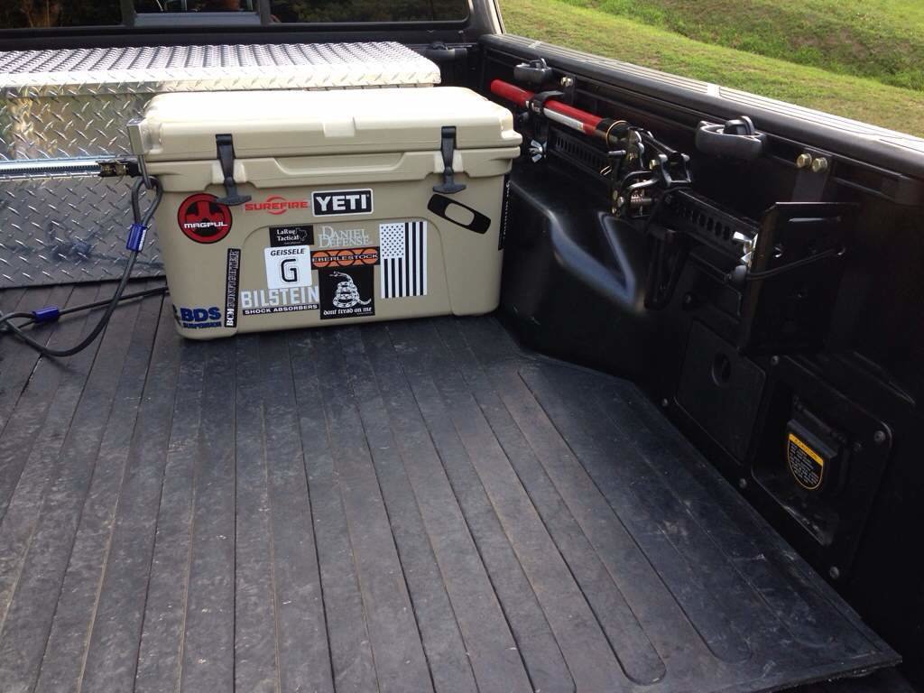

    Mounted my Hi-Lift with them.
