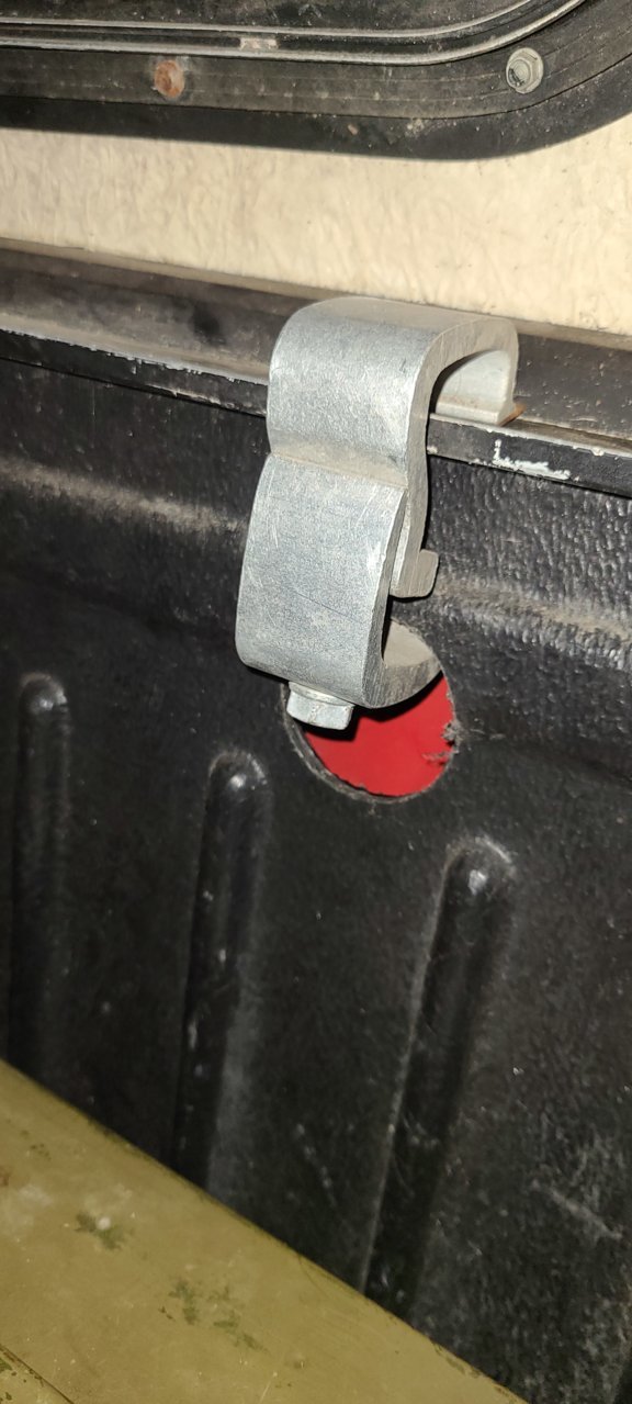

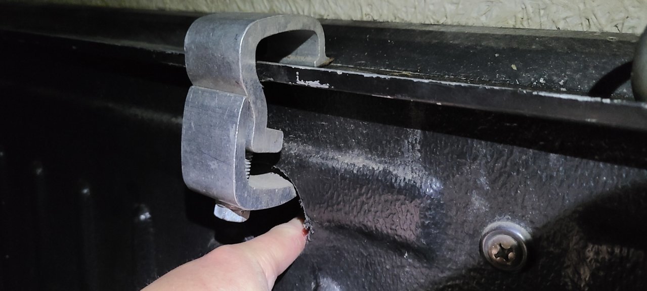

    I Have no clue about the t-tracks for 1st gen but I own both a 1st and second gen and both have camper shells. I can see how it might be nice to install the rails for fist gen but personally I'd stick with the tried and true c-clamps myself (for the 1st gen/yours). I guess you can find or make proper mounting points. I did a quick looksy and it seems you will probably have to take out/cut out some of the plastic bed lining part. The c-clamps work great

    Id personally stick with the C-clamps for the first gen. I have camper shells on my 1st and 2nd gen. I'm sure you can modify and put the rails on yours. The c-clamps work great... I guess having added tie down spots with rails might be useful but?! I'm sure you'll have to cut and modify plastic bed liner to make sure the rails will be attached to something secure
    For your reference
    For your reference full disclosure the shell on my first gen wasn't made for it but works fine and stays dry

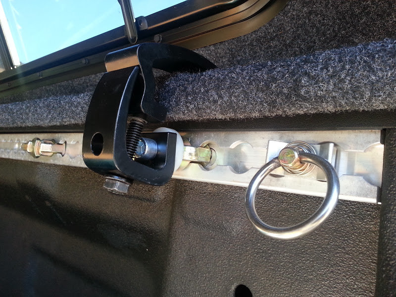

    I know this was posted a while ago, but this is what I plan on doing on my 1st gen. I haven't used a set of c-clamps I've liked for camper shells and tonneau covers due to the larger bed rail depth on 1st gens. It's a real pain to take on and off.
    Using L-tracks will do the trick.camper shell clamps.jpg camper shell clamps.jpg

    That’s not my photo but I have l-tracks installed the same way and decided to not use them to mount my topper. They are only mounted into the thin sheet metal edge of the bed rail, so it would be easy to start to bend that upwards. If you use clamps you are clamping up and down in the same spot, so it’s much more secure. The bed rail l-track offsets the force to an angle which might be a problem over time.
