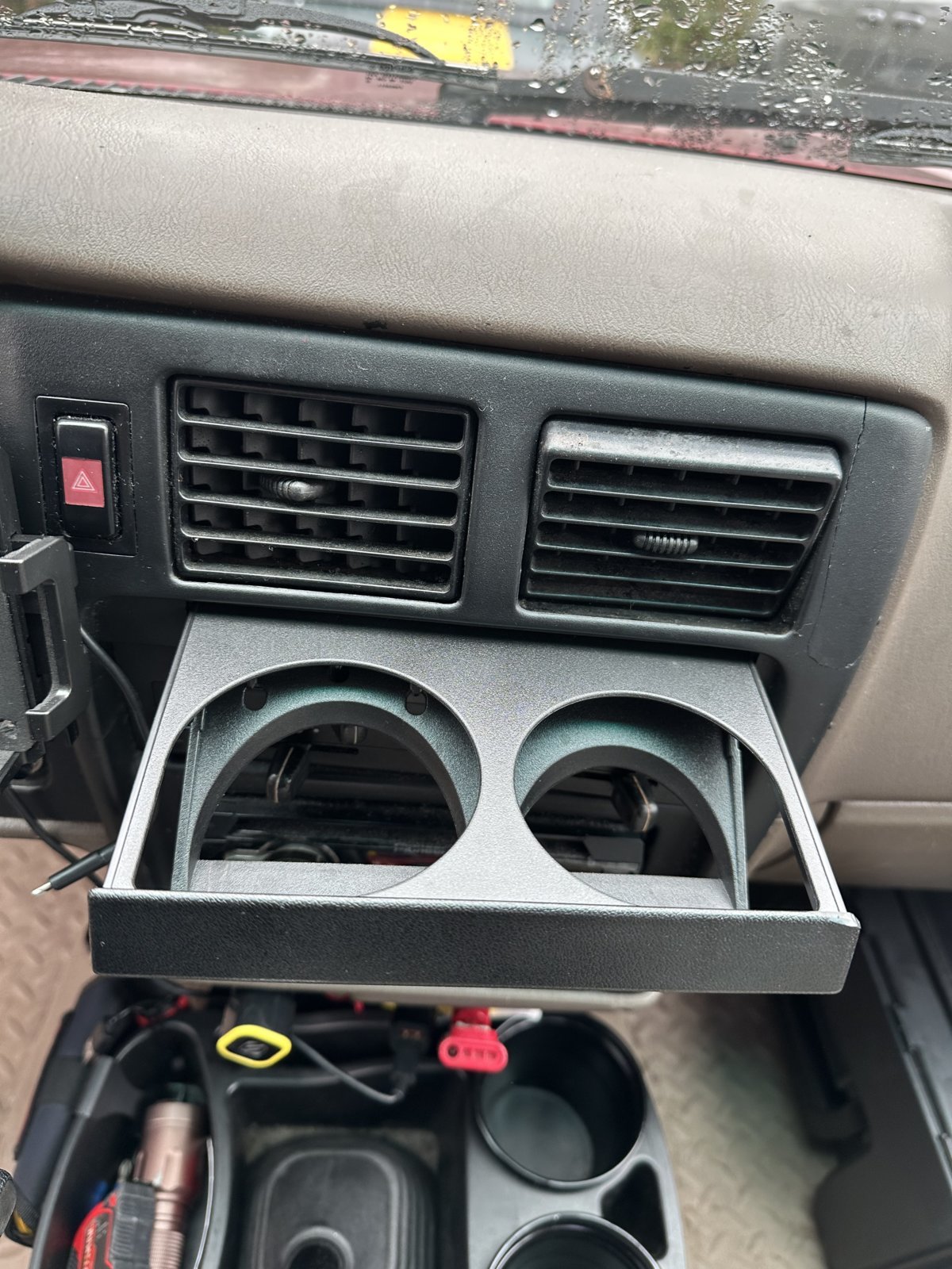

    The first matter is cupholder usage-

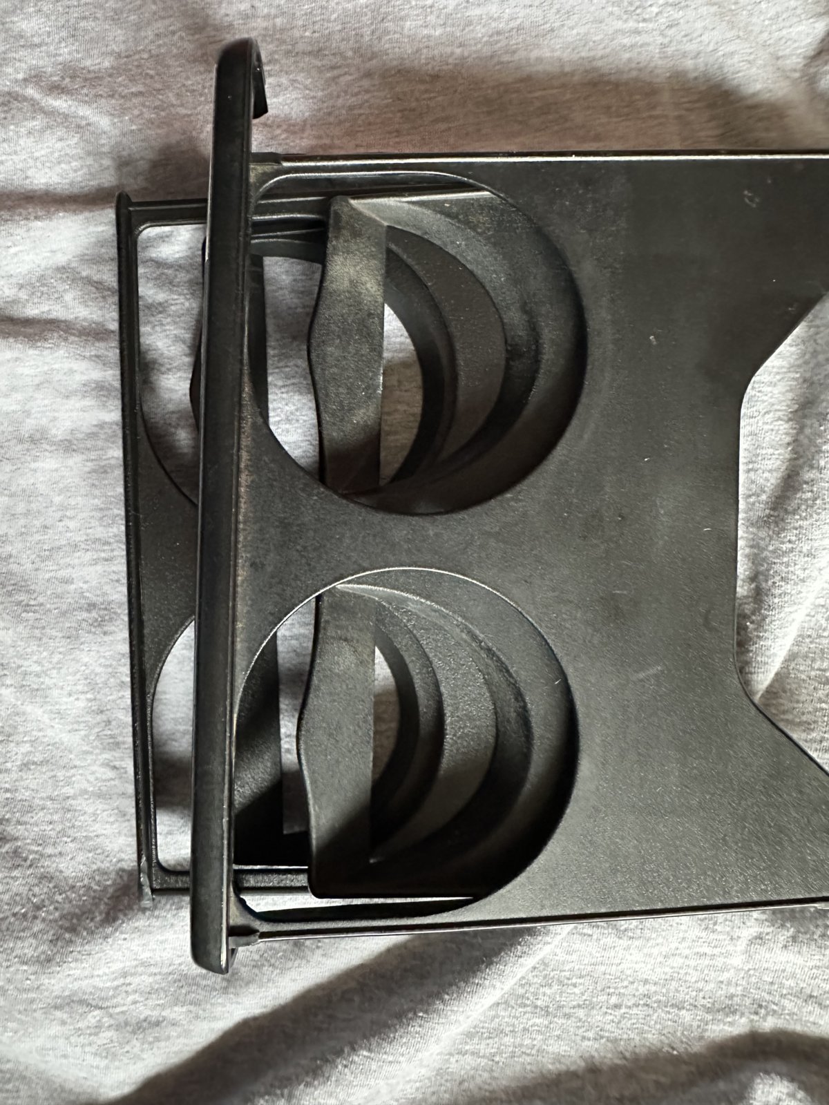

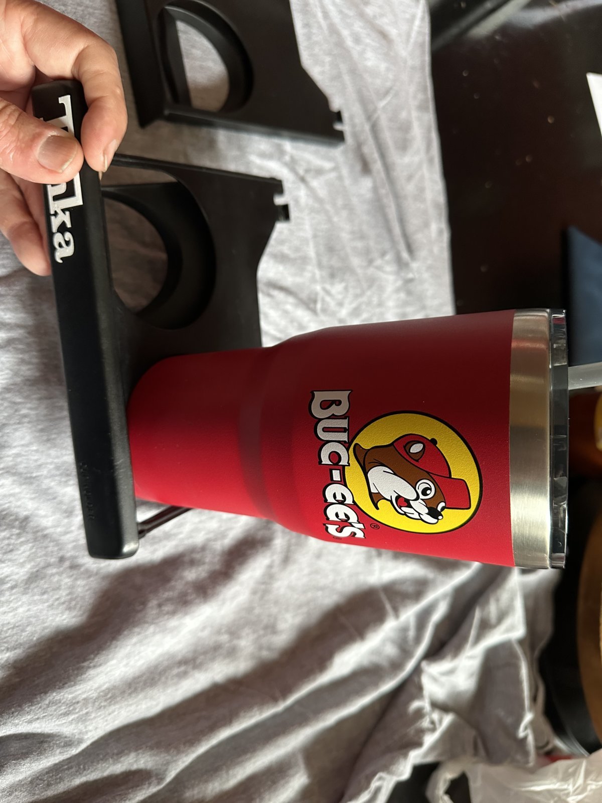

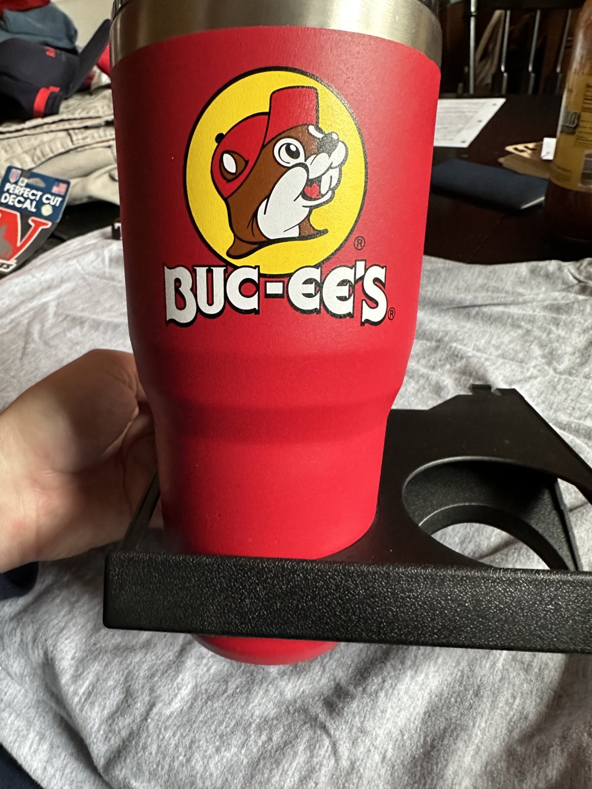

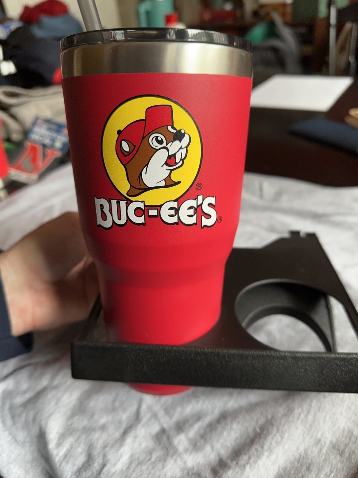

    Looking at the Caribou ashtray cupholder, I kept thinking about the hole width. I have a 90 Miata & I made a phone & cupholder for it using the side console screw to mount. I played with different things to use for the cupholder. 3” is just slightly too small to securely hold modern 30oz cups.
    Yeti, Ozark Trail, Magellan, & Yukon brand 30oz cups are all slightly different in width & taper. So, they need different minimal width & depth to hold securely in cupholders.
    The T-100 cupholder is slight different in shape than the Tacoma one. The T-100 is squared off, while the Tacoma is actually slanted side-to-side.
    The T-100 holes are also 2 different shapes. The larger left is 3 1/8” wide, while the right one is 2.81” wide.
    The Tacoma holes are 3” wide.
    The result of the size difference:
    Yeti larger tumblers WILL semi-securely fit into the Tacoma cupholder, both sides. While, the other 3 brands listed above will not. The main issue is the drop-down bottom part not allowing them to nest further down IF they would clear the hole enough to sit securely.
    All 3 fit securely into the T-100 cupholder, left side ONLY.
    The second is locking in (so not slide all the way out).
    It does lock-in enough to stop itself from sliding straight out. But, it you lift the front to angle the rear tabs down, you can manually & gently slide it out without removing the whole console surround.

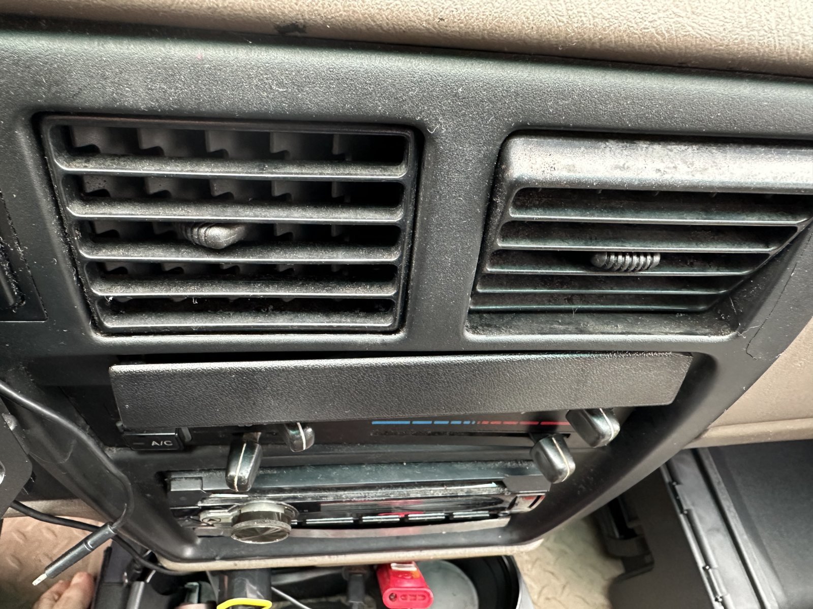

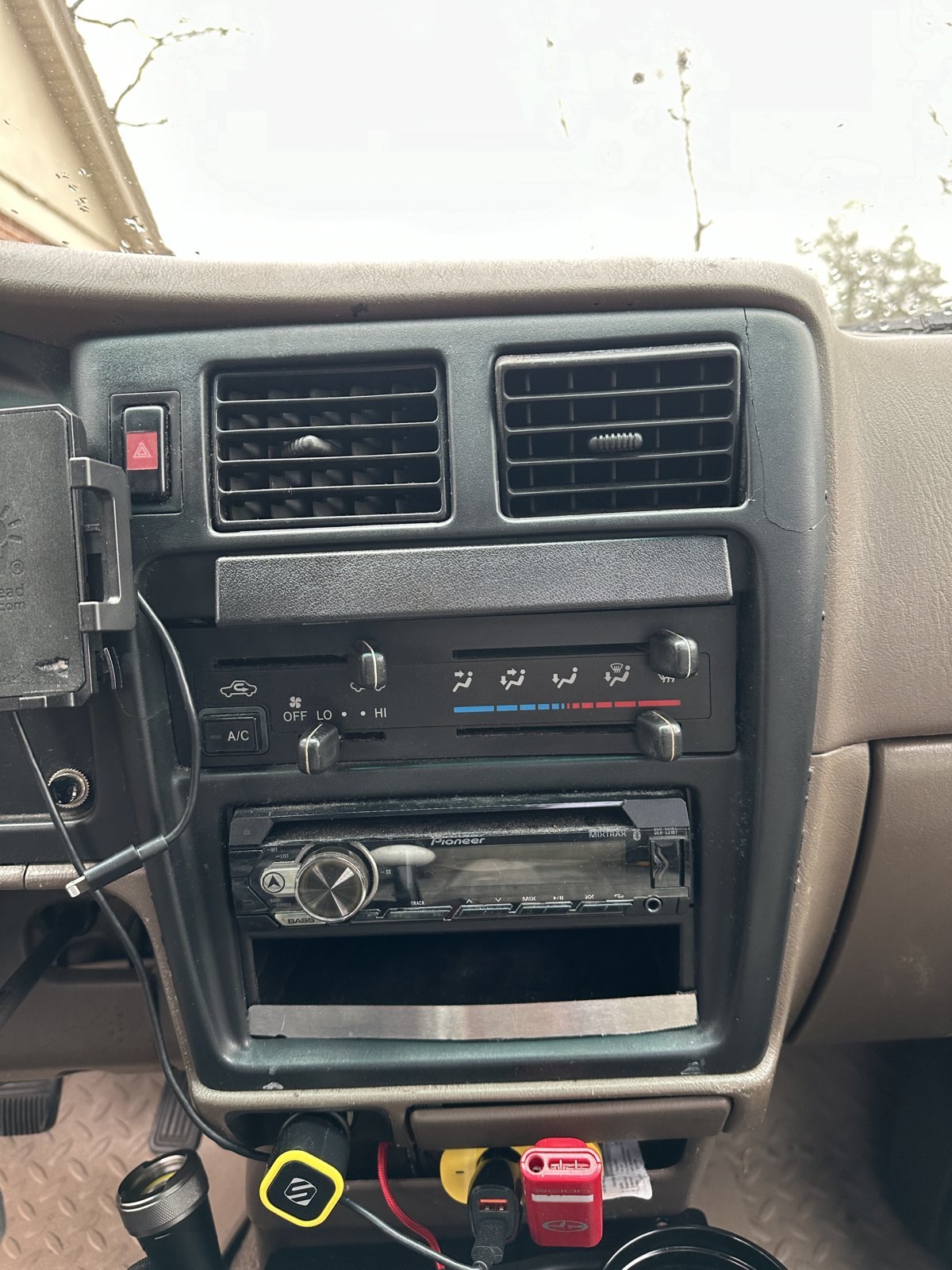

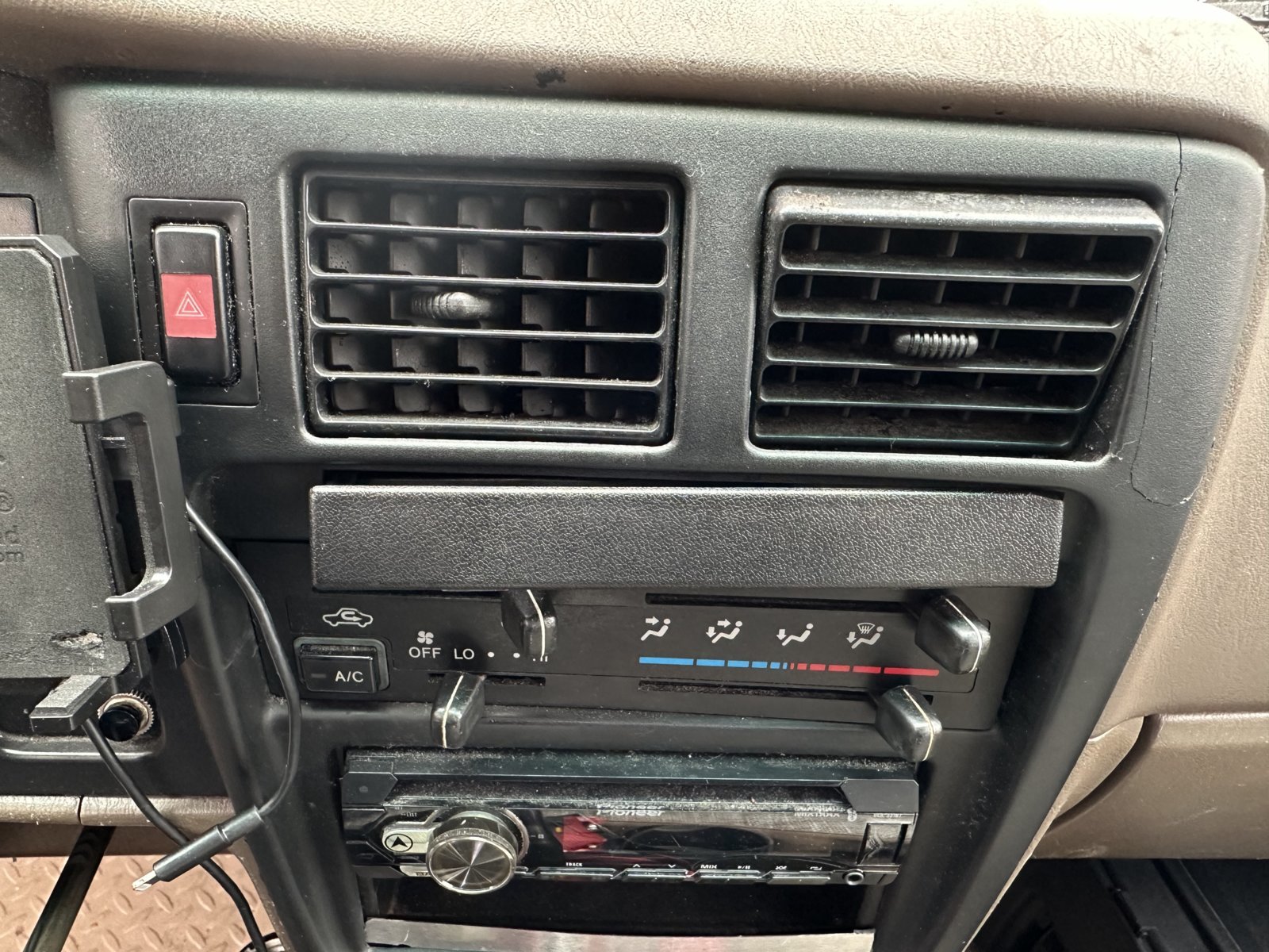

    The 3rd & biggest issue is how it sits when closed.
    As stated before, the stock Tacoma one has slanted front & back portions. The T100 one is squared.
    So, the T100 one slides in straight & it’s “faceplate” sits perfectly perpendicular to to front-rear line of the truck. While, the Tacoma one angles the “faceplate” slightly toward the driver, which follows the shape of the dash.
    As a result, the T100 fits flush on the right side (better with a very slight trimming of the upper right corner to clear the tighter dash structure), but the left side sticks out about 1/4 inch. It’s really only noticeable from looking down on it.

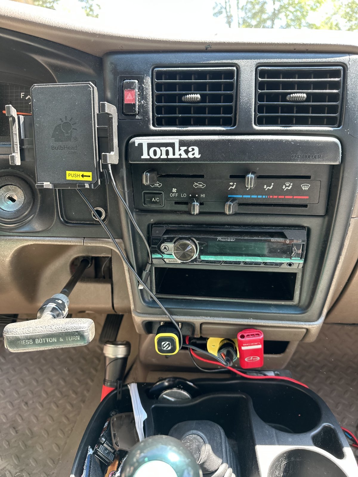

    Functionally (for me) , I like the T100, but the Tacoma one fits & looks a lot better in the dash.
    Pictures show what I mean. The “Buc-ee’s” cup was chosen as a pretty common 30oz cup. It’s shape is very close to the Magellan one.
    Edit- picture order changed in upload. The wider face is Tacoma, while narrower one is the T100.
