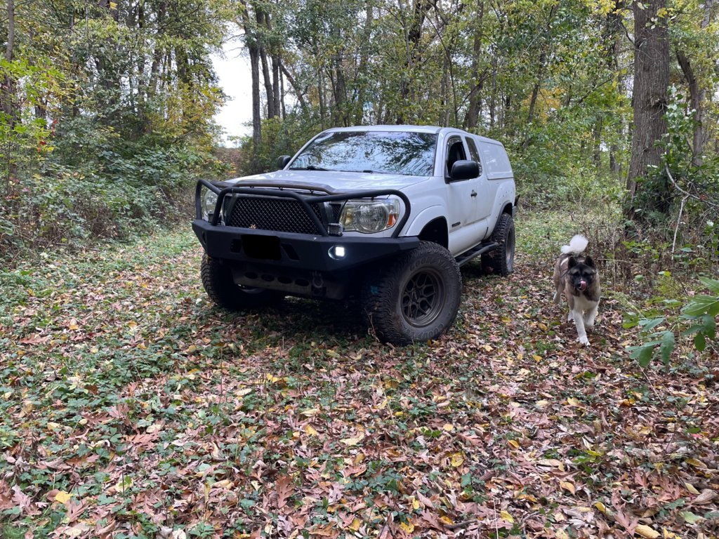

    IMG_5189.jpg Super White 2008 Toyota Tacoma TRD Access Cab 6 Spd Manual.
    This is my second Tacoma, 3rd Toyota Pickup. +23 years behind the wheel.
    *More to come, including pics.
