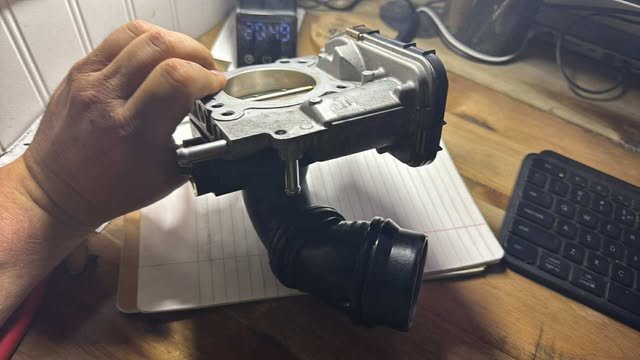

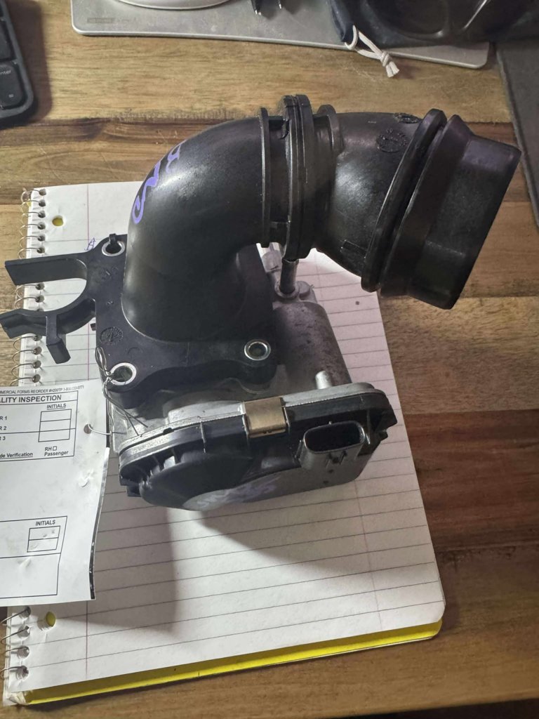

    Thought I'd pass on a few measurements taken from a spare Throttle Body and Throttle Body Elbow off of the Tacoma (it's the same for other T24A-FTS platforms like the LC250/4Runner).
    Located what I think might prove to be a choke point.. Enjoy!

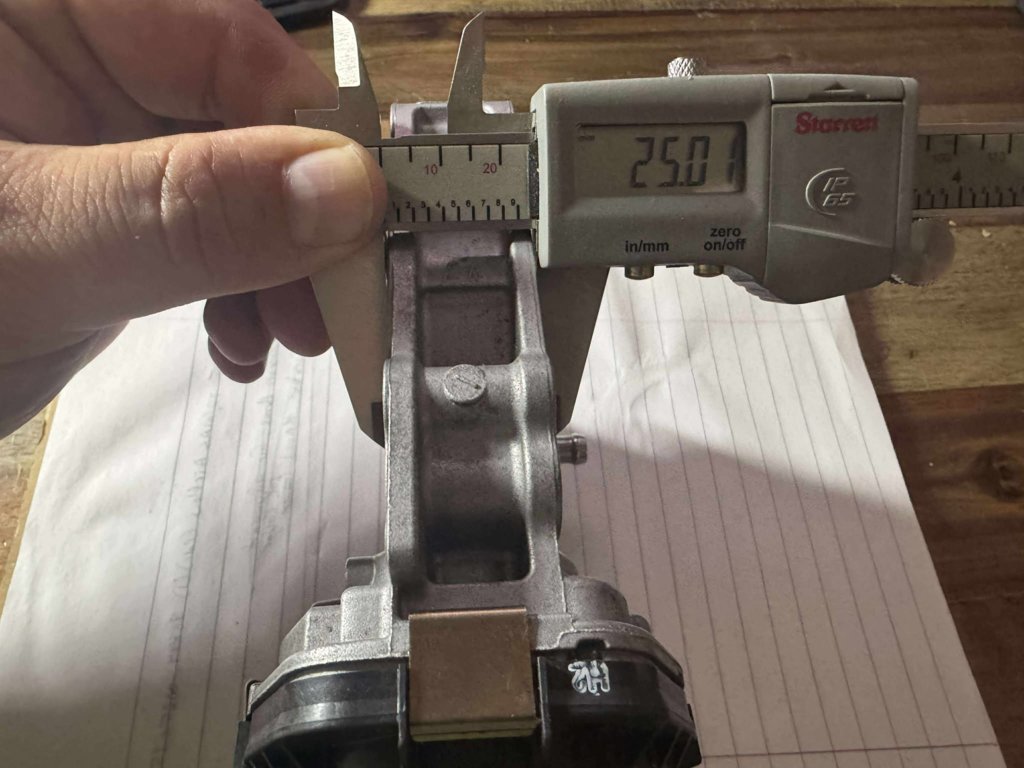

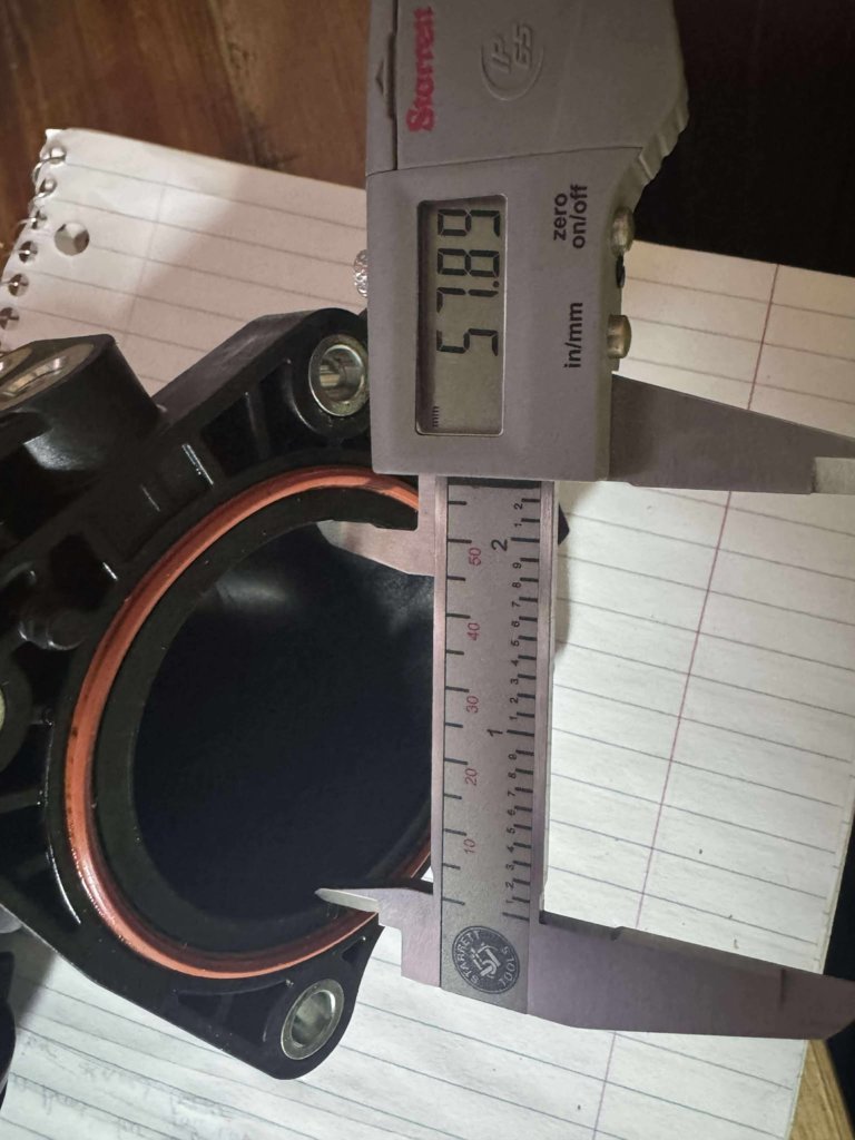

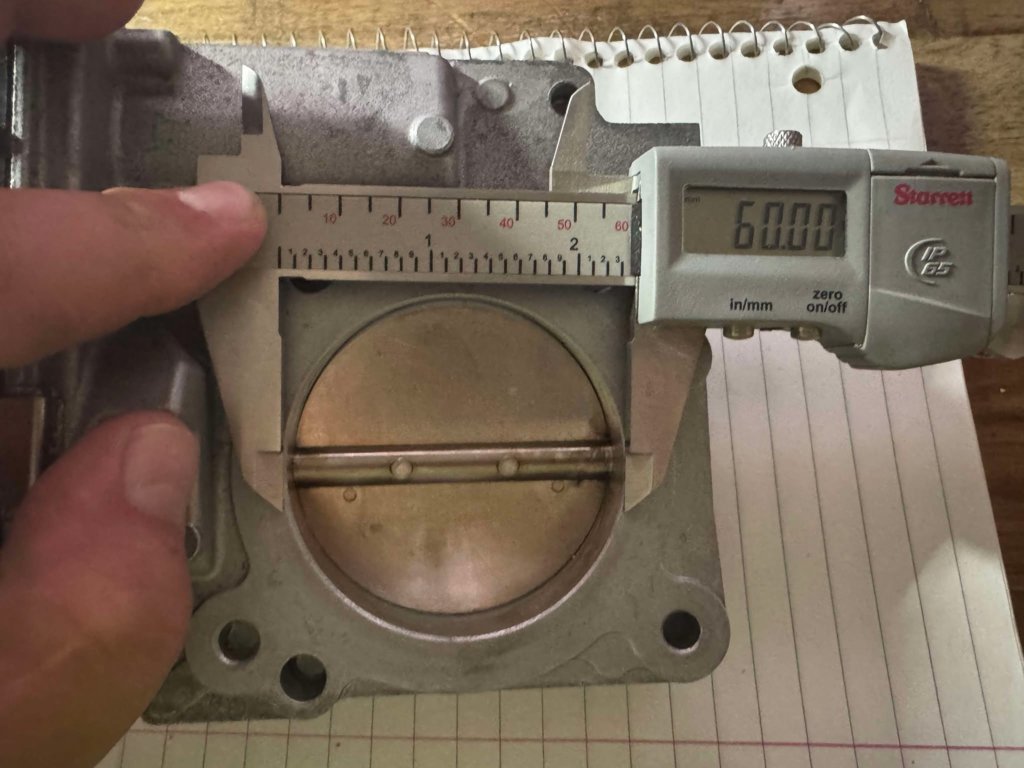

    *My calipers aren't perfectly positioned here, but the ID of the TB is 60mm, which gives us a cross-sectional area of ~2827.4 square mm excluding the throttle plate/bar.

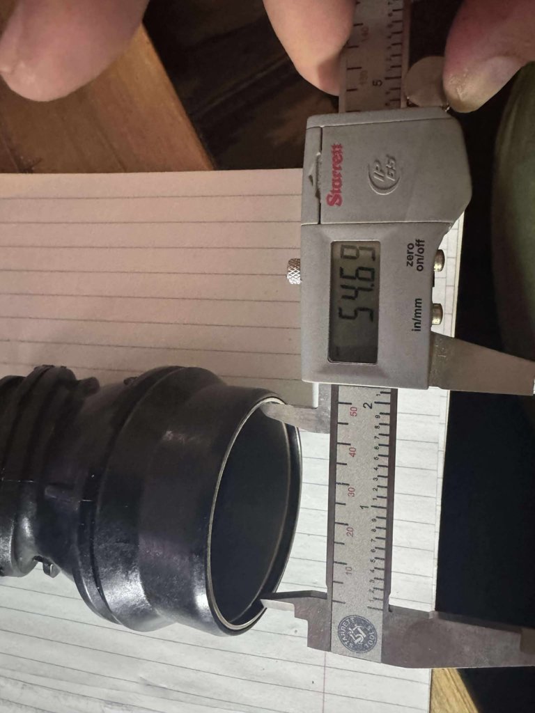

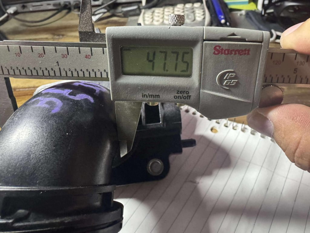

    *Choke point located!

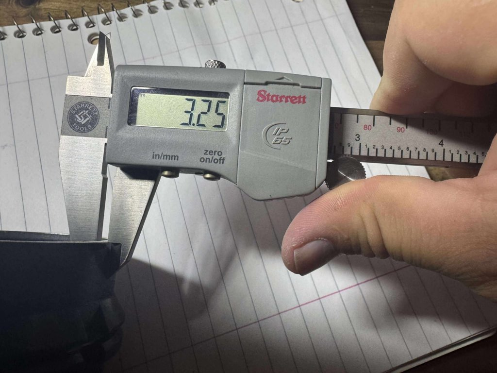

    With an OD of ~47.75mm and a wall thickness of ~3.25mm, that is an approximate ID (at the radius) of about 41.25mm (~1336.5 square mm).

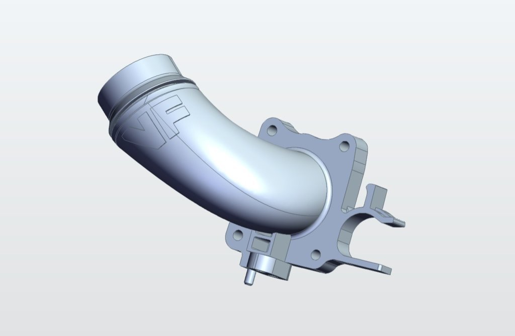

    VF will be producing these.
    "Coming soon...and available for pre-order this week.
    Tacoma/4Runner/ Land Cruiser 2.4L Turbo CNC Throttle inlet pipe.
    - Dramatically increases the Throttle inlet pipe diameter. No longer restricting down to 40mm.
    - CNC Billet Aluminum
    - Designed in the USA
    - BOLT ON compatibility.
    - Replaced the tiny, restrictive plastic one with a larger volume CNC
    Replacement.Will provide:
    - Dramatically less intake restriction
    - More flow
    - Better throttle response
    and more
    Pre-order for introductory pricing of $325!"
    Let them know OTT sent you! If 10 of you mention that OTT sent you, he's gonna discount them further to $299!
    VF has requested that anyone wanting to purchase and get their "OTT" mention/discount, please email Support@ovtune.zendesk.com and reference the throttle body inlet.
    https://vftuner.com/products/vf-throttle-inlet-pipe-toyota-2-4l-turbo

    designed in US. made in chinatown? no actual pictures of it on a tacoma...

    This part was designed entirely here in the U.S., and what you're seeing is a 3D CAD rendering intended to share development progress and provide early visibility to the community. It's not yet in production, which is why photos on a vehicle aren't available—yet. The goal of sharing this now, along with a pre-sale opportunity, is to give early adopters a chance to get involved and help offset the initial production costs.
    We're here to contribute to the community by pushing the envelope—bringing new, innovative, and problem-solving products to the table. That process often involves risk, investment, and transparency about where things stand.
    When folks immediately jump in with negativity before a product has even launched, it doesn’t just affect us—it creates a climate that discourages others from taking similar initiative. If we want to see continued innovation in this space, primarily from smaller teams trying to do something meaningful, it helps to approach these efforts with some curiosity or constructive feedback rather than dismissal.
    At the end of the day, they're just trying to build cool, functional stuff that solves problems for enthusiasts like us. Hope you can forgive us for trying!

    i understand now why no pictures of installed.
