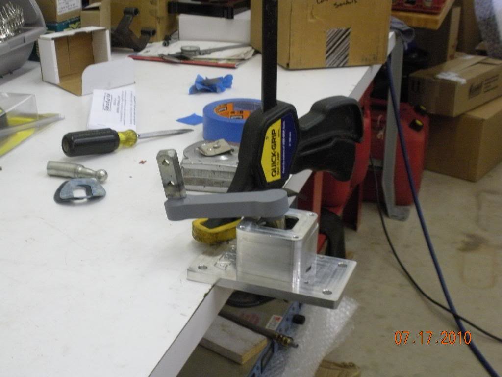

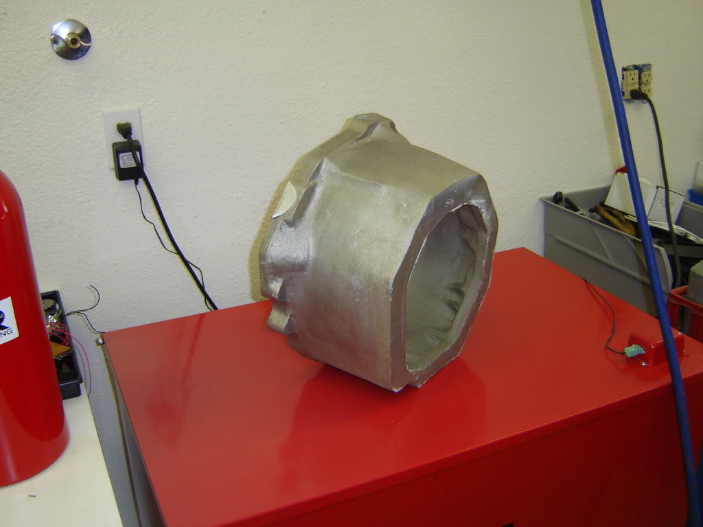

    Custom bellhousing.
    Mock up.

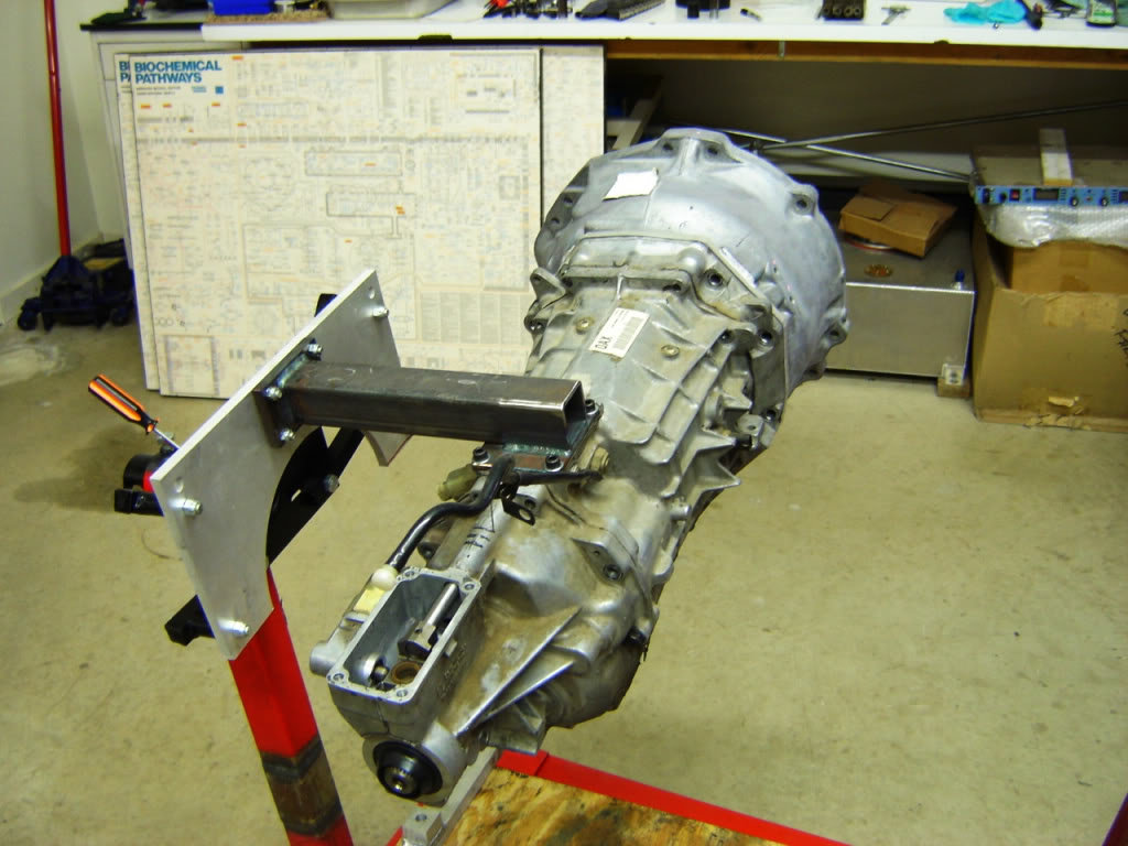

    Pic of trans in the tunnel.

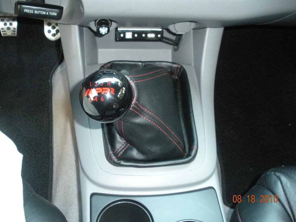

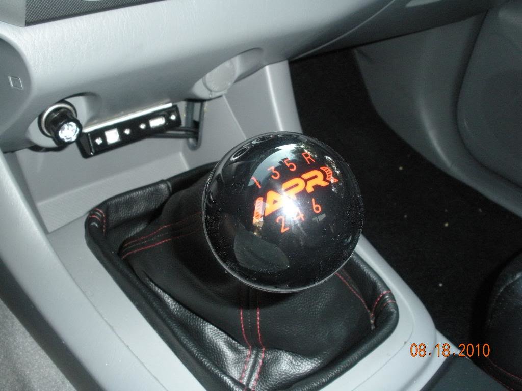

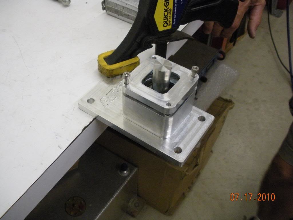

    Shifter pics
    From the top side.
