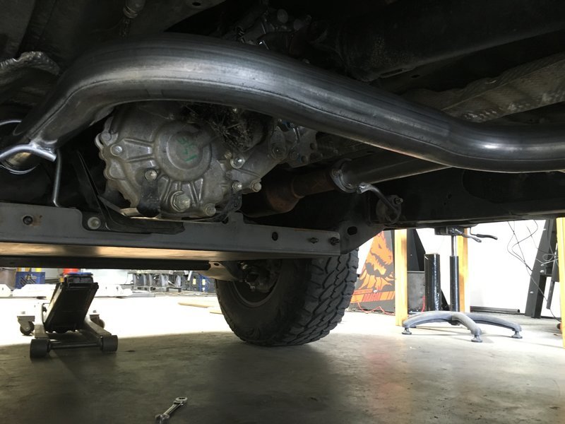

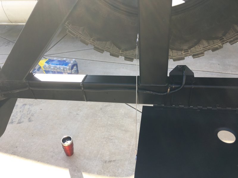

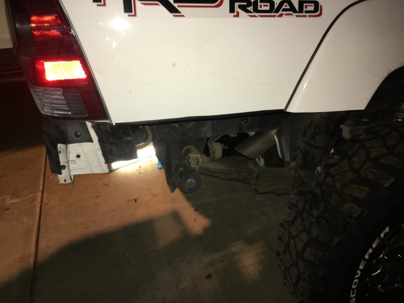

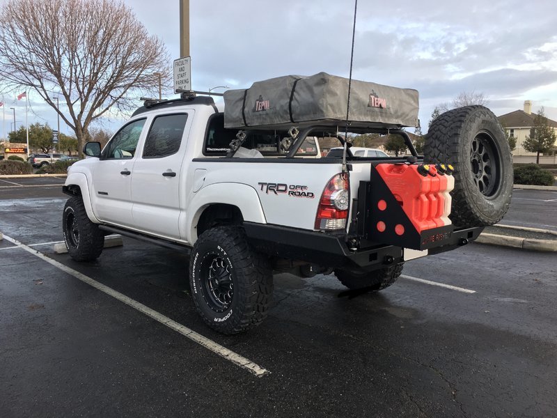

    Haven't updated the build page in a long time and I've done so much to the truck since the last post. I'll update over a couple days, but for now I'll give some teasers for my high clearance rear to those who aren't following on IG or the "what have you done to your 2 Gen thread". Thanks as always to @Mademan925

    Got the exhaust rerouted, cut for the turndown, and a flow master put in at ABC muffler in Benicia awhile back too. They do some great work!

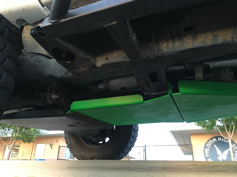

    Here is the BAMF Mid and T-Case Skid for the flat belly!

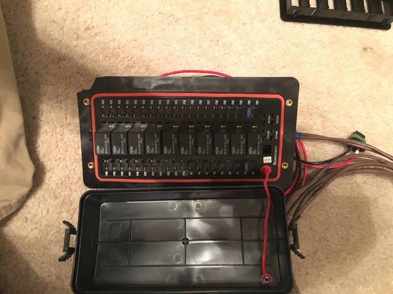

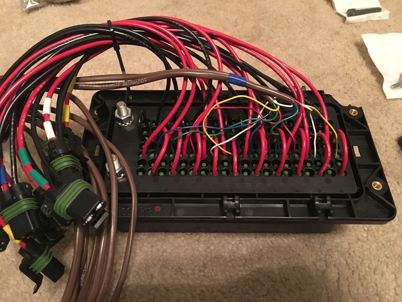

    The current project I am working on is my electrical relay and fuse box for the rig. Got the box all wired up and the Iggy switch panel ready to go just waiting on some minor parts here and there to put it all into the truck. This includes making my own relay/fuse box panel for the engine bay.

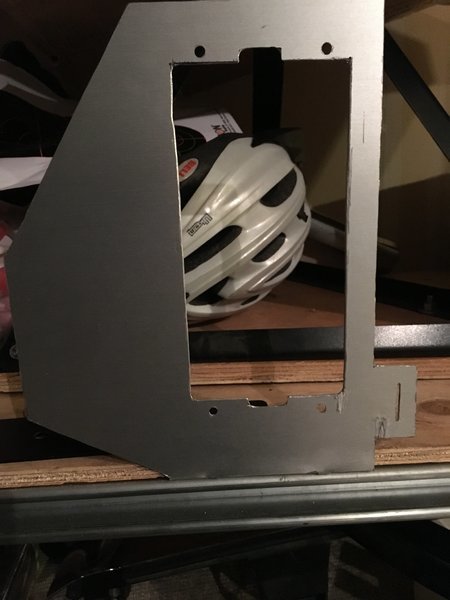

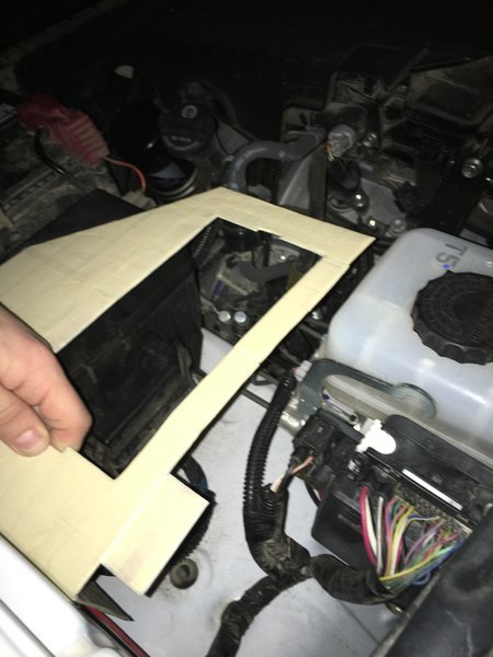

  17. Feb 23, 2017 at 5:10 PM
    #37
    Tac0maSteve
    Tac0maSteve [OP] Well-Known Member
    Feb 14, 2015
    #148633
    736
    Steve
    East Bay, CA
    '15 TRD Off Road Icon Ext. Travel
    DCSB... No mods here

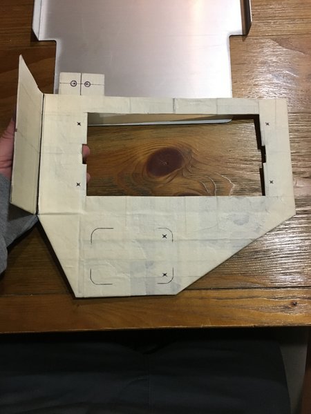

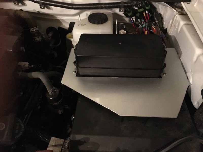

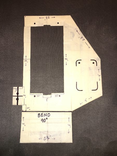

    Mocked up the panel for the electrical box in the engine bay. This one is just cardboard and tape with measurements for the real thing.

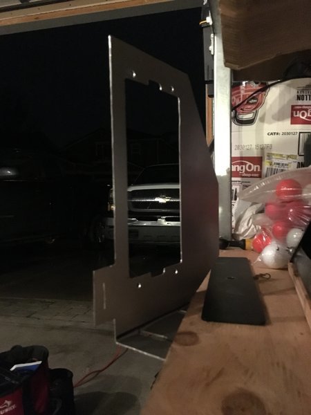

    Then I decided to go for it after my buddy Cam hooked me up with some free aluminum. So far there were some minor set backs like flex and bounce from the panel as the aluminum was too thin. This was fixed using a simple bracket though. Something else which could have been adjusted too was that my panel blocks the OEM fuse panel, soooo thats unfortunate but hey it was my first attempt.

    I might consider redesigning the metal panel in the future and will create a write up for people that want to make there own as well. It really wasn't hard. You just need the right tools and some spare time.

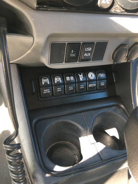

    Got my @OTRATTW switches in the truck today held by the @Iggy switch panel
