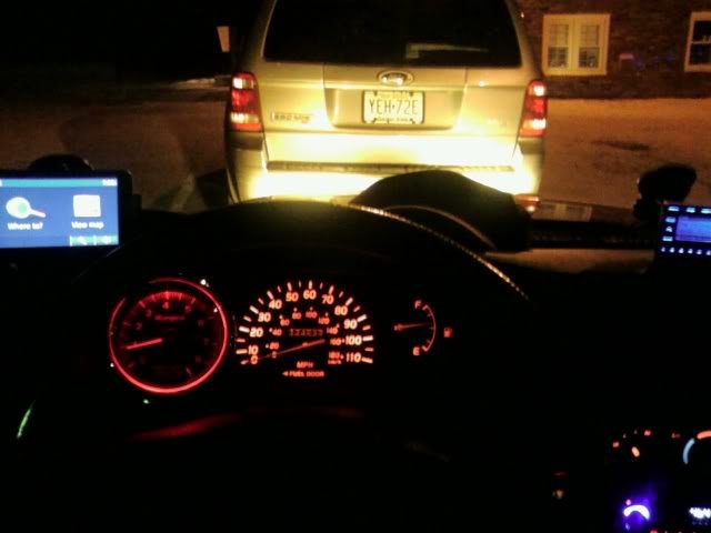

    Installed the tachometer...I had a 3" Tach that I got when I got my taco over a year ago. Super easy install the hardest part was running the wires...oh and the rpm wire was light green with black stripe
  15. Mar 9, 2010 at 5:07 PM
    emglishe30
    emglishe30 [OP] Well-Known Member
    Jul 10, 2008
    #7863
    119
    NJ
    2010 SR5 Base 4x4 DCSB
    Pioneer Touch Screen, Sub, Diode Dynamics SS3 Sport amber fogs, Oem skid plate, led accent lights, led 3rd brake, 2011 color matched honeycomb grill. Plasti dipped pieces.
    Looks a tad overkill due to size but I like it...I replaced the white bulb that came with it with a red led bulb
