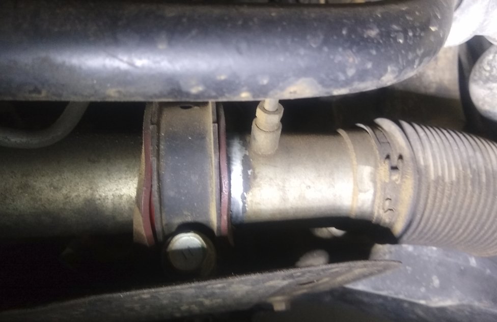

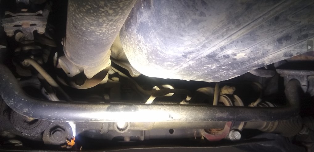

    Yeah... I was scooting around under my truck looking for a front jack position (whatever I found didn't look like a safe place to jack off from) to inspect my tie rods and hubs then I saw chewed orange bushings looking back at me. How hard is it to DIY swap these bushings and every other rubber part up front that is BTFO? Also, I see some oil sludge under the driver side, what part seems to be leaking, how hard is the swap, and what's a fair price to pay to do it? bad bushings 1.png bad bushings 2.png

    Thanks for posting the pic, I have a set in mine and have wondered how well these hold up! Those appear to be Energy Suspension poly bushings, the slightly softer red version, and yeah they look pretty beat up. They're supposed to look like this. Difficulty to change: not that hard, people sometimes have trouble getting the vertical bolt out but I can tell you, yes you can get a torque wrench in there.
    You don't have to disconnect the rack from the lines, but you do have to remove the 4 bolts and slide the rack to the rear enough to get the bushings in, plan on supporting the weight with something while working.
    The sway bar usually needs to be removed for more room, I think it's possible to replace the bushings without doing so but it's a good time to replace the sway bar bushings ($14 for OEM) and the sway bar links when doing that.
    This can be done without removing the TRE's but if you are planning on replacing them (OEM only) get them broke loose before you start removing the rack bolts.
