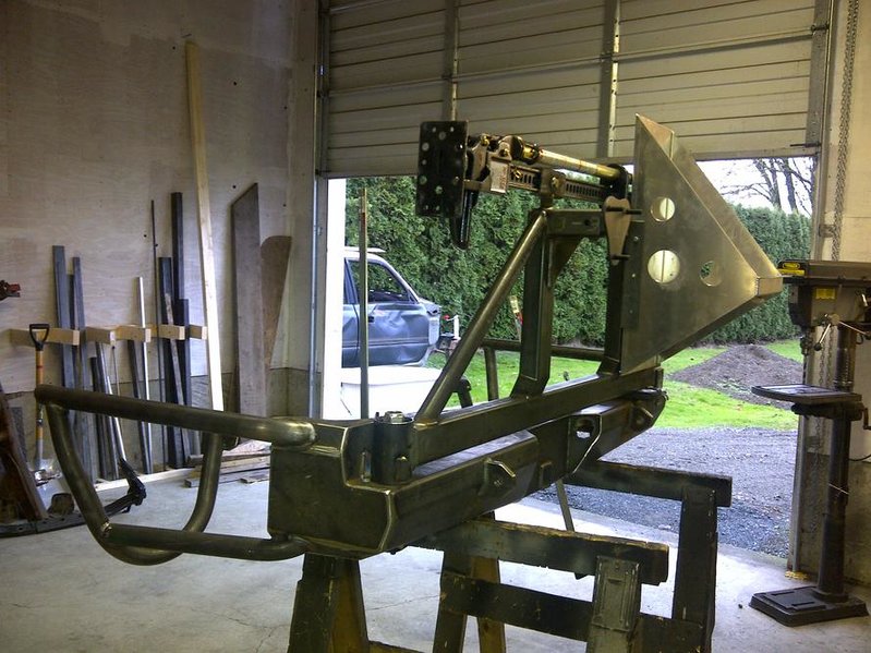

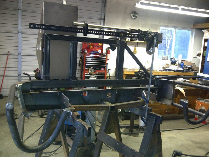

  4. Nov 9, 2012 at 8:58 AM
    #124
    Cruisin Off Road
    Cruisin Off Road Renegade User
    Oct 28, 2012
    #89996
    88
    Jason
    Fraser Valley, BC
    91 Land Cruiser 80 Series
    Cruisin Off Road bumpers, sliders, skid plates, roof rack...
    Thanks for posting those!
    The bars are tied to the frame at the wheel well with a bolt on bracket. Very solid. Note that the swingout arm is not welded on, it looks funny because its just resting there.

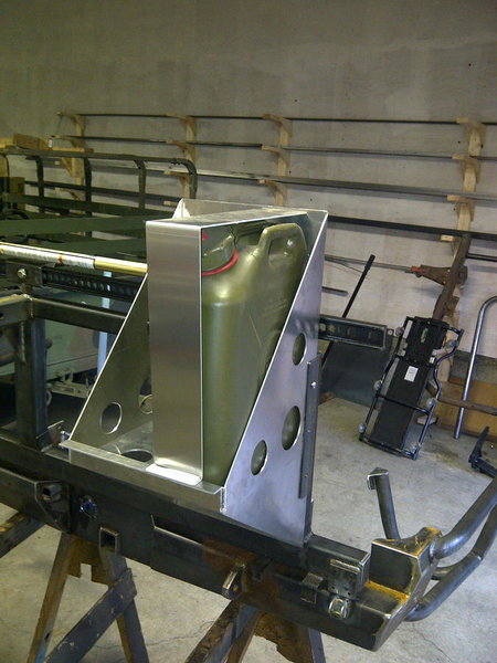

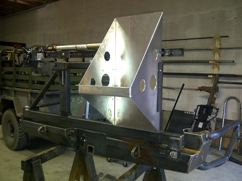

  15. Nov 14, 2012 at 9:06 PM
    #135
    Cruisin Off Road
    Oct 28, 2012
    #89996
    88
    Jason
    Fraser Valley, BC
    Its nearly done. Built most of the swingout today. The criteria for the can carrier was to hold 2 Scepter Military cans, have them lockable, and have it so the caps can't be screwed off. There's some more work to be done to the aluminum holder, but you get the idea. The Hi Lift fits nicely behind the tire and can carrier, there's a CB antenna mount in there, and the factory backup camera will be mounted to the under side of the can carrier. The tire holder is adjustable for wheels of different offset, and this arm will easily accommodate 35"s or bigger. There's also going to be a gas strut to assist with opening and closing the swingout :cool:
