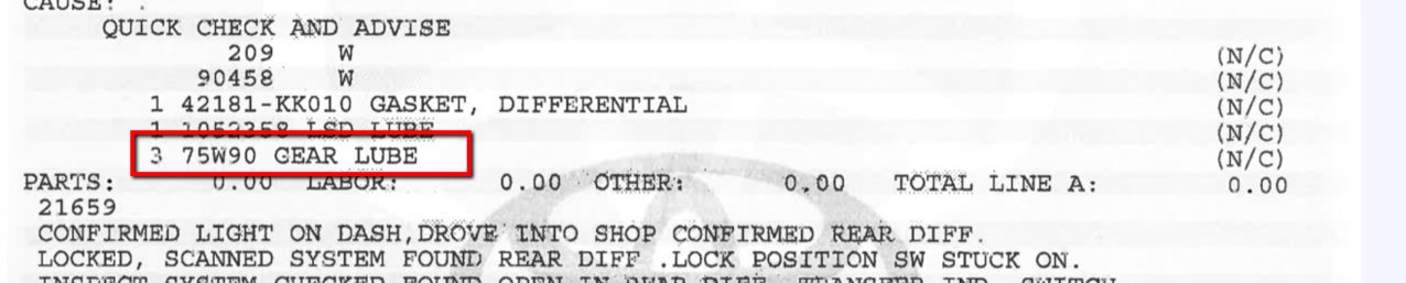

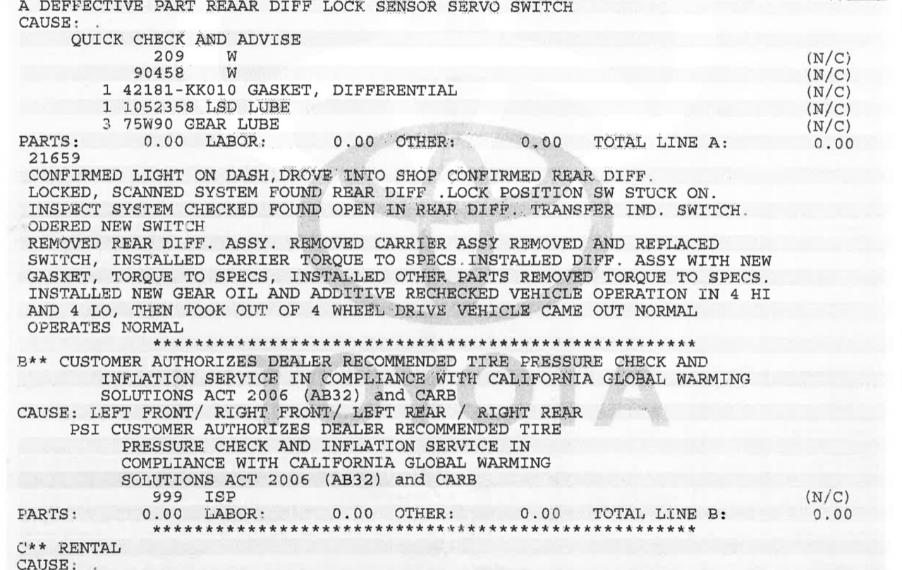

    So I took my 2017 taco to the dealer on nov 14th because the rear diff light wouldnt stop flashing.
    The truck had never been put into 4hi or 4 lo and i have never messed with the rear diff. the truck only has 21000 miles on it.
    Dealer looked at it, said it was bad sensor, kept my truck overnight and ordered a new sensor. Turns out the sensor they ordered was also bad or too long?!? they ended up locking the rear diff and had to order a new sensor and also had to drop the entire rear diff i guess. the fixed it all under warranty and gave the truck back to me after about 3-4 days. they put me in a rental so i wasnt crazy bothered.

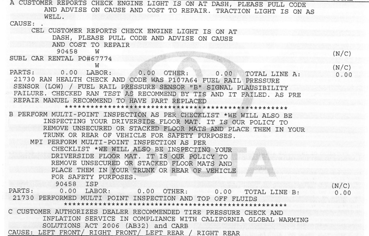

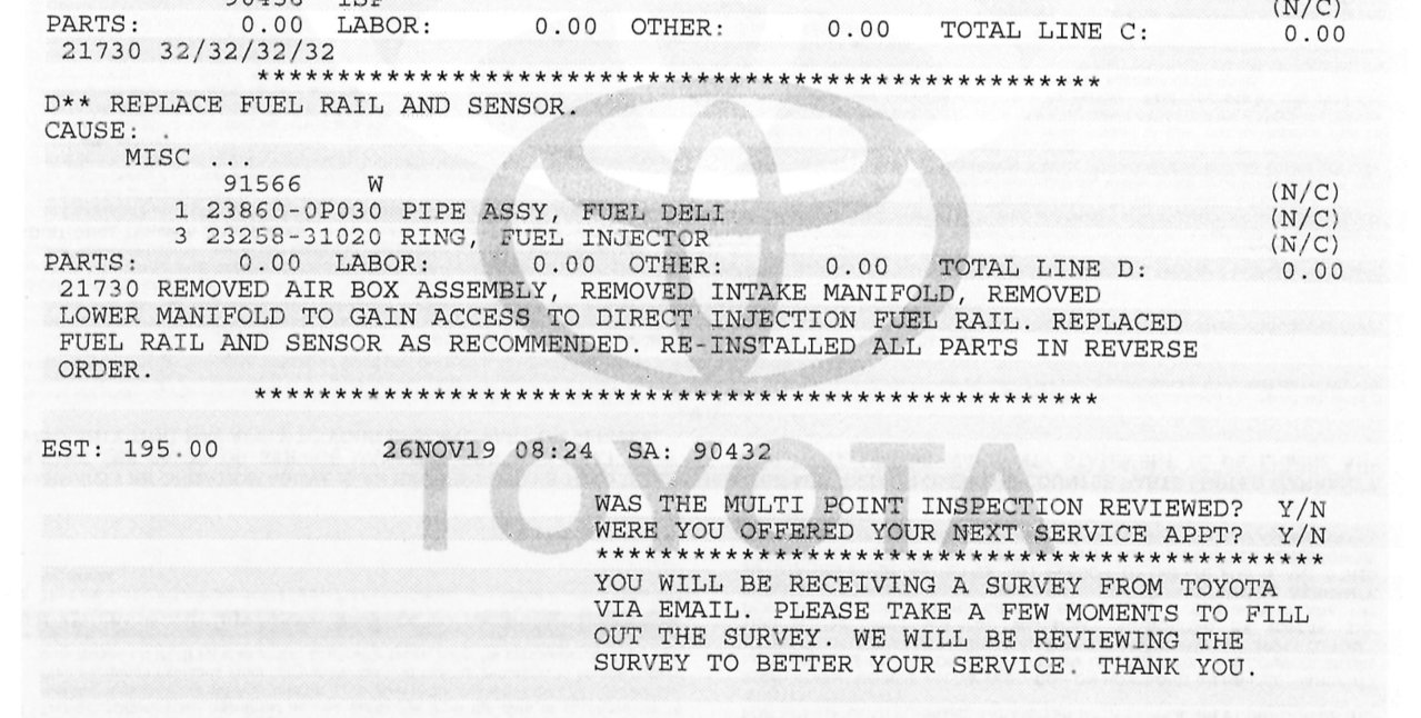

    60 miles later the check engine light and trac off light comes on. i bring it back. they tell me the fuel rail and fuel rail sensor is bad, put me in a rental again and they replace it all under warranty.
    60-70 miles later, check engine light and trac off light are on again...I took the car in this monday, they stated that they would need the master tech to look at it on tues, tues i dont get a call so i figured i be patient. wednesday (today) rolls around and I give them a call, they said they need to send the info up to toyota because they cant figure out whats wrong with it....

    After March you are on your own,NO warranty.Check your gas cap too see if its tight/seal is good,as thats a common issue for check engine/trac light.You will need too delete the code in the computer after the fix.

    I know you mentioned that it had never been in 4WD, but notice that they keep mentioning that they found a differential sensor damaged.
    Might want to take pictures of the differential housing to show that it has not been beat on just to cover yourself for if/when they come back and say that you broke it and the repair is on you.

    Also, why are they putting in the wrong gear oil
    Breeze900rr likes this.

    Definitely demand extended warranty, and good catch on the gear oil. It should be 75w85 GL5 gear oil. I wouldnt ever go to that dealership again. Much like im never going back to the one my truck is being held at. Lazy goodfornothing joke of a place, they literally couldnt even put a hubcap on right.

    Let this be a warning to others!!!!! With 4WD systems, and diff locks, it’s “use it or loose it”. They suffer from lack of operation. Be sure the cycle your functions periodically. Engage 4WD and mess with the diff whenever you get a chance. Your truck will thank you.
