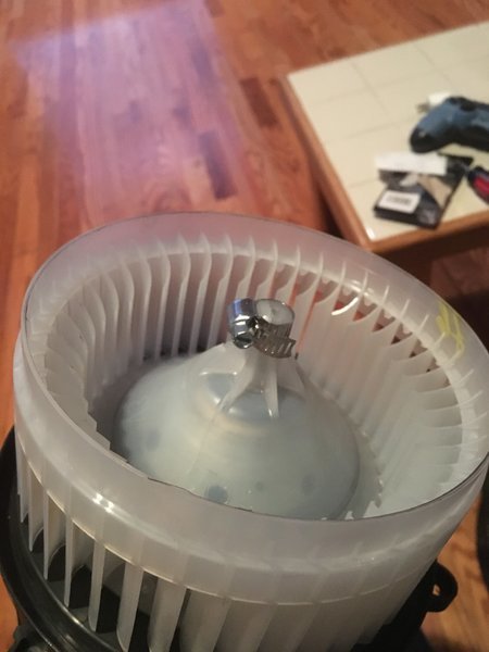

    Hot damn I owe you a beer now! Worked like a charm I got air again! Hose clamp tighten the piss out of it boom works

    I guess we can say cheers! :thumbsup:
    And,
    For now though till parts comes in lol!

    If you can remove the wheel , find a motor shop or refrigeration supplier and match up the blower wheel . They should have one that is close in diameter . Combustion blower motors are similar in size or small refrigeration units .

    The hose clamp looks really good , thanks for the pics ...
