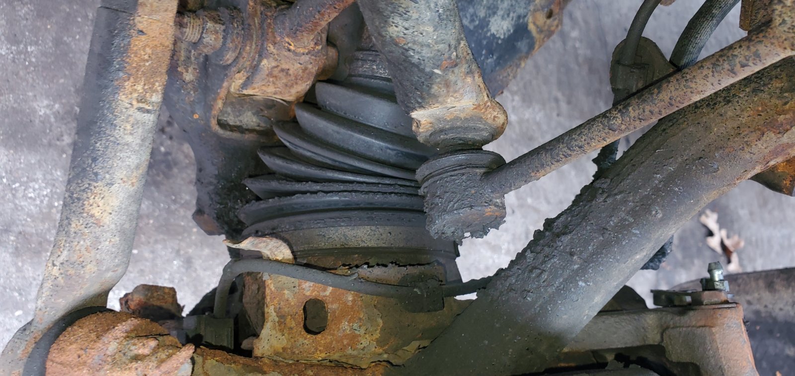

    2011, 2nd gen taco bro here, wanted to know if any of you know what part this is? (The corroded burnt looking connector.) I need help tryna figure out what part that is to replace them. This is on the passenger front side if i recall correctly. Id appreciate the help. Also im at 128k miles, if that helps.

    Looks like the hard brake line.

    All I see is a brake line covered in grease from a leaking CV boot.

    Right on. Def needs replacing.

    Right on. Ill inspect cv boots to possibly replace as well. I didnt know there is a possible leak in the cv boot.

    Also missing the pad return spring. Wipe off the hard line and see what's up.

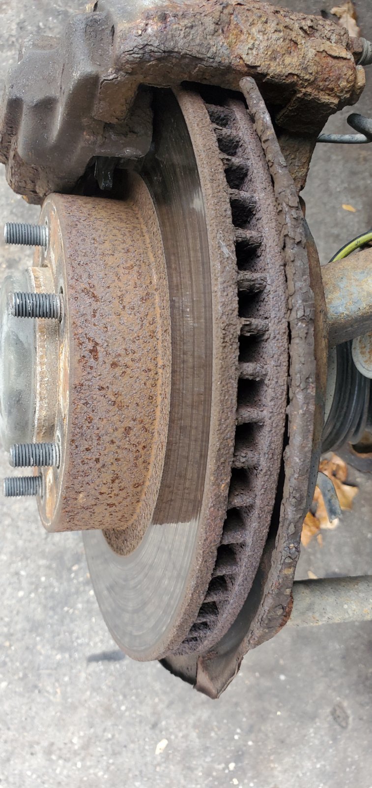

    Cv boot ripped,new pads on old junk rotors,what’s your question

    Drivers CV axle is puking.

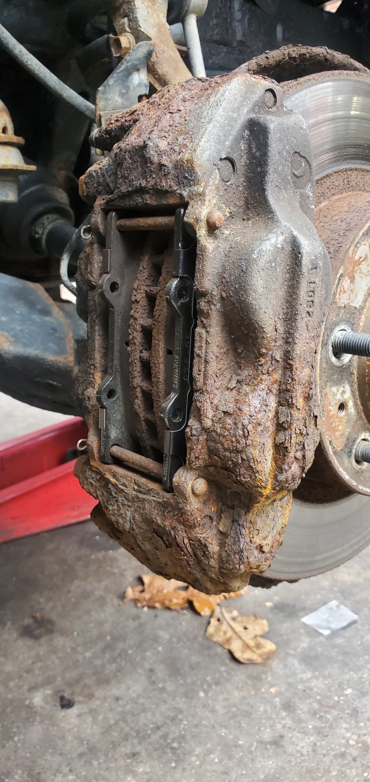

    You have some serious rust issues, the passenger caliper has been changed but that drivers side is way over due for it.

    As for the front end, your rotors, calipers, tie rod ends, shocks (at the bottom mount), steering knuckle, should all get replaced then treated to prevent from rotting out again

    Looks like grease leaked onto brake hardline from torn outer CV boot.

    No. That brake line is probably the only thing that doesn't need replacing. I think the CV grease saved it. Maybe a quick rattle can on those calipers....
