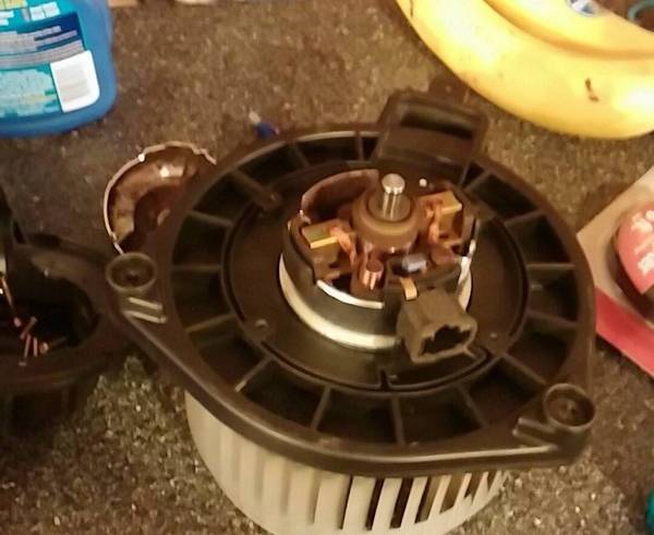

    Bouts to get my 886 fog light mod on. Also gonna try and fix my chirping heater fan.

    How you plan on fixing the blower motor? I'm just going to buy the updated blower motor.

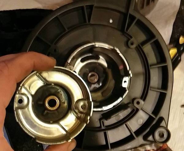

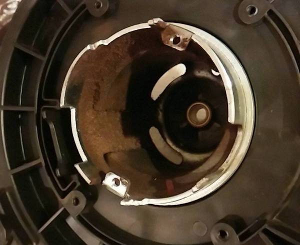

    Clean and lube the 2 bearings, then rebalance it. Here's some crappy pics of when I did mine

    Cool!
    I just don't have the patience

    The only patience parts is waiting for everything to dry after cleaning with plastic safe electronics cleaner and then rebalancing it but thats done in the truck.

    So it didn't fix yours drew?
