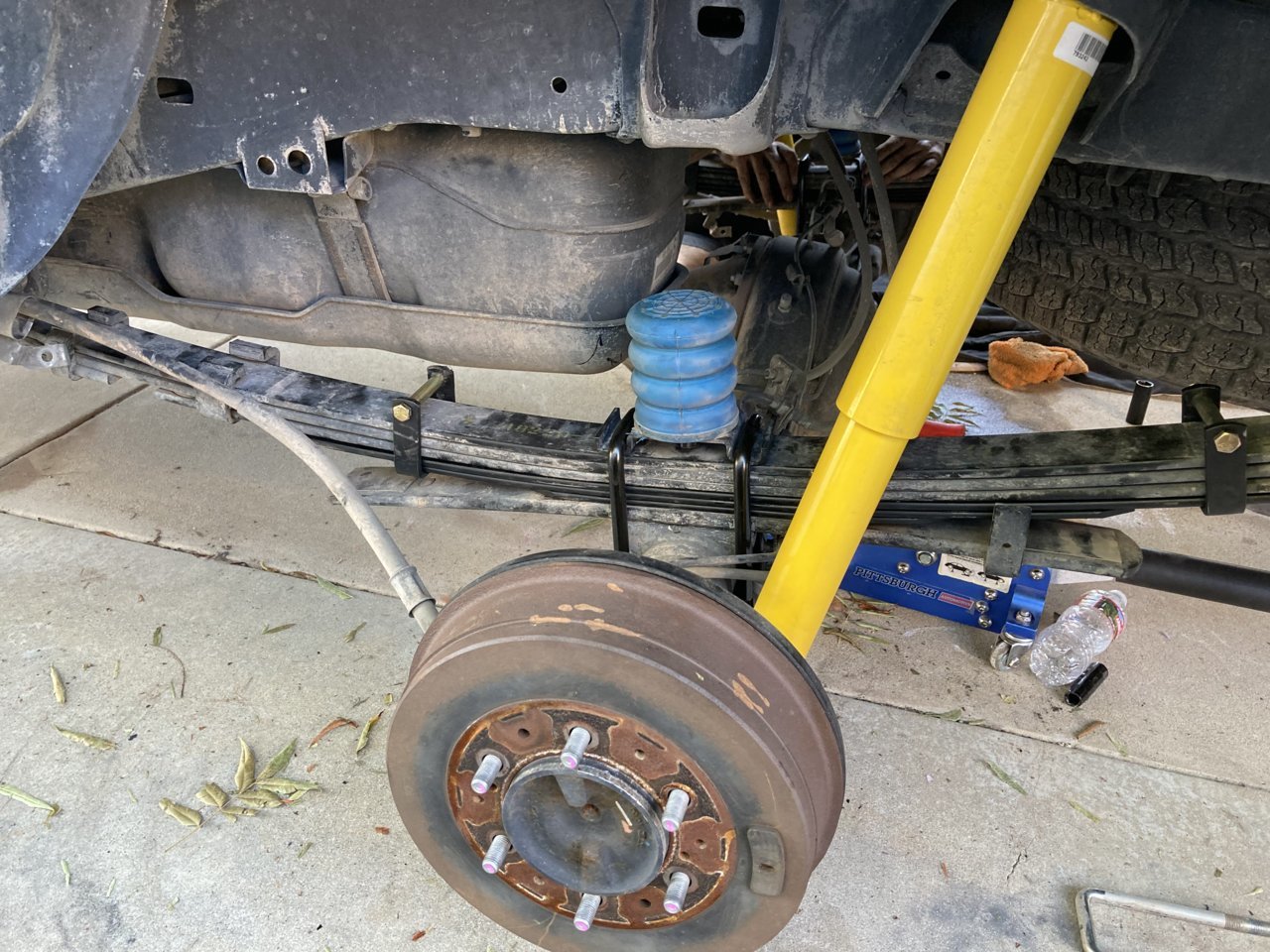

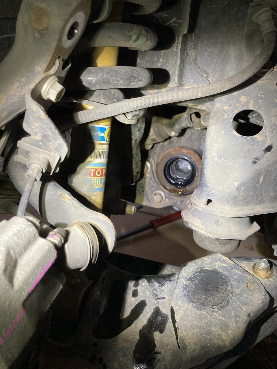

    Put in ECGS bushing. Had to grind about 0.25mm of the extractor tool to fit it behind the bearing.
    Got in Dobinsons coil over on the front driver side as well. SumoSprings front bump stop, rear AAL and front passenger side will be tomorrow’s fun.

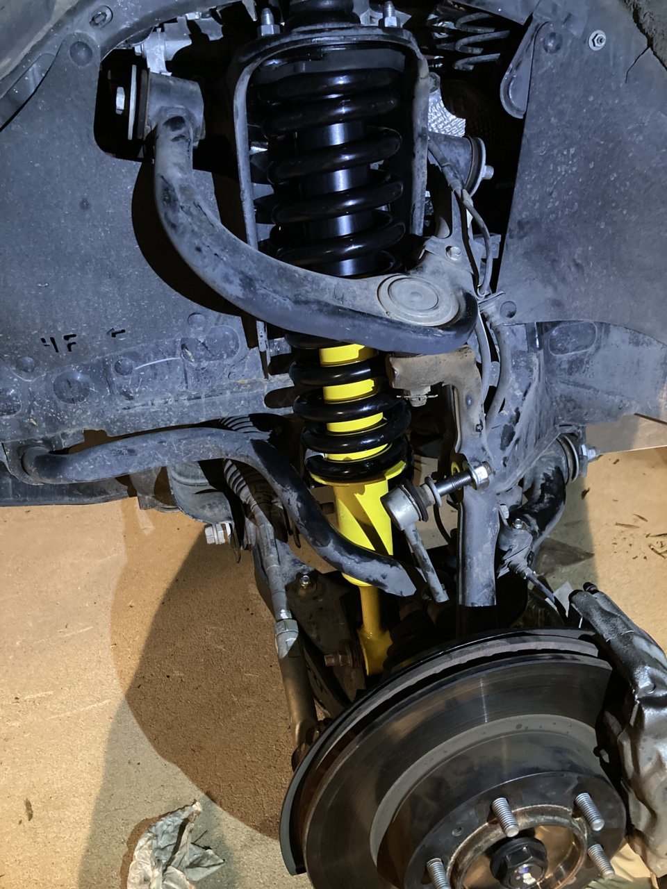

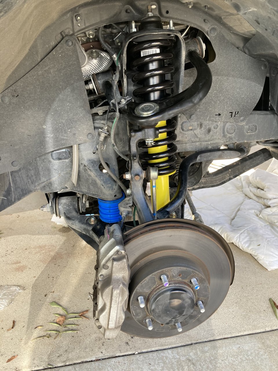

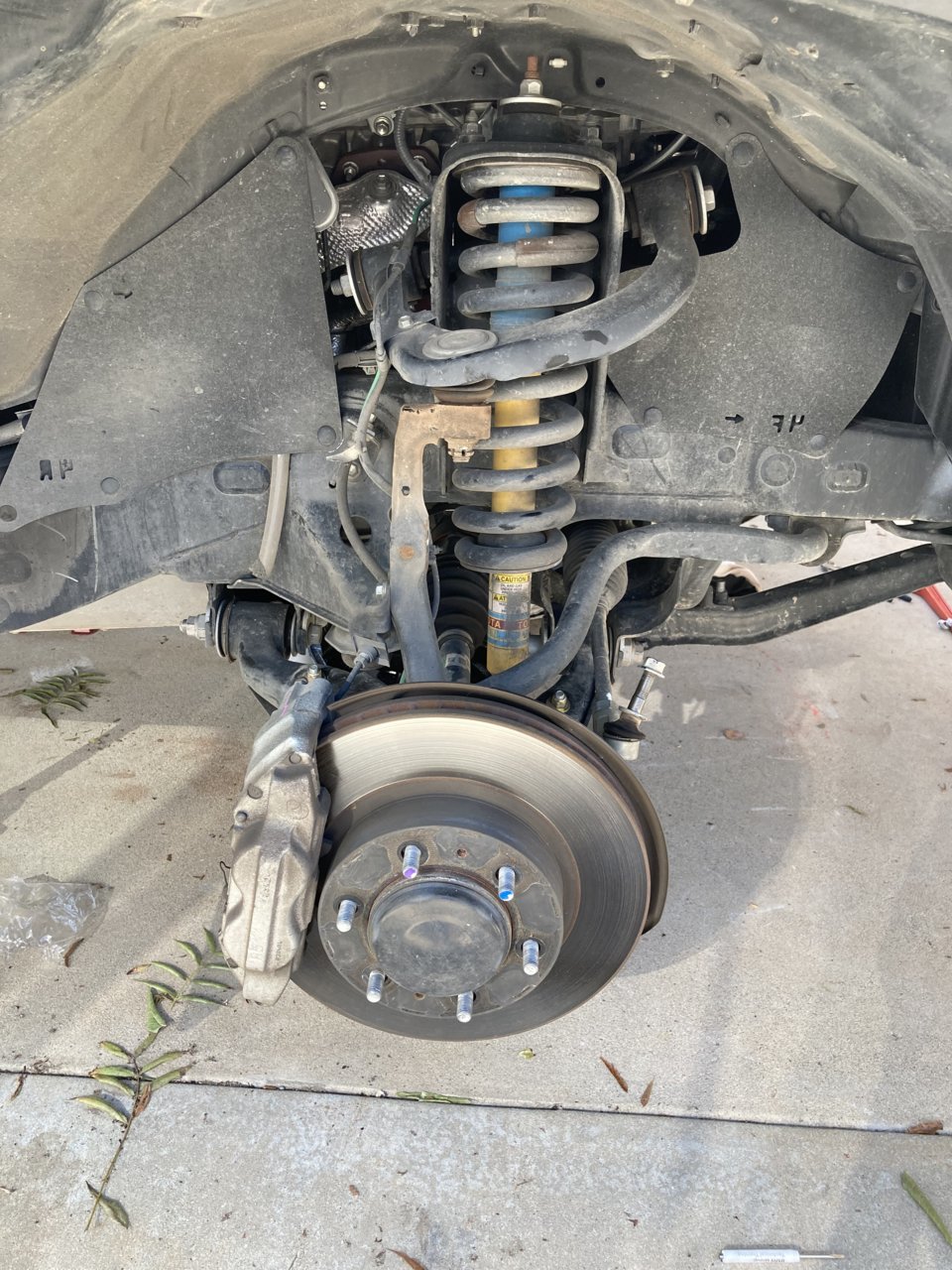

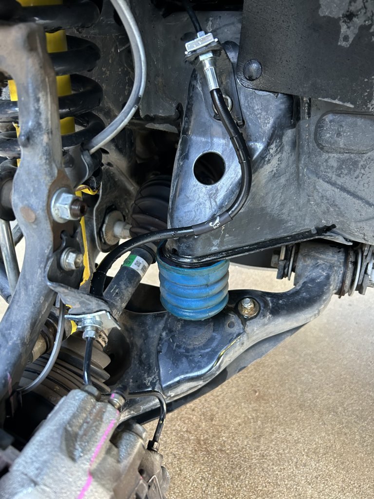

    Did the front passenger side. Also ended up getting SumoSprings for the front.
    Before
    IMG_4918.jpg After
    Added ICON progressive AAL and left overload in. Might have to trim it a bit if it’s gonna be hitting the rivet on the AAL when flexing/ under load but I wanted to maintain my factory rake.

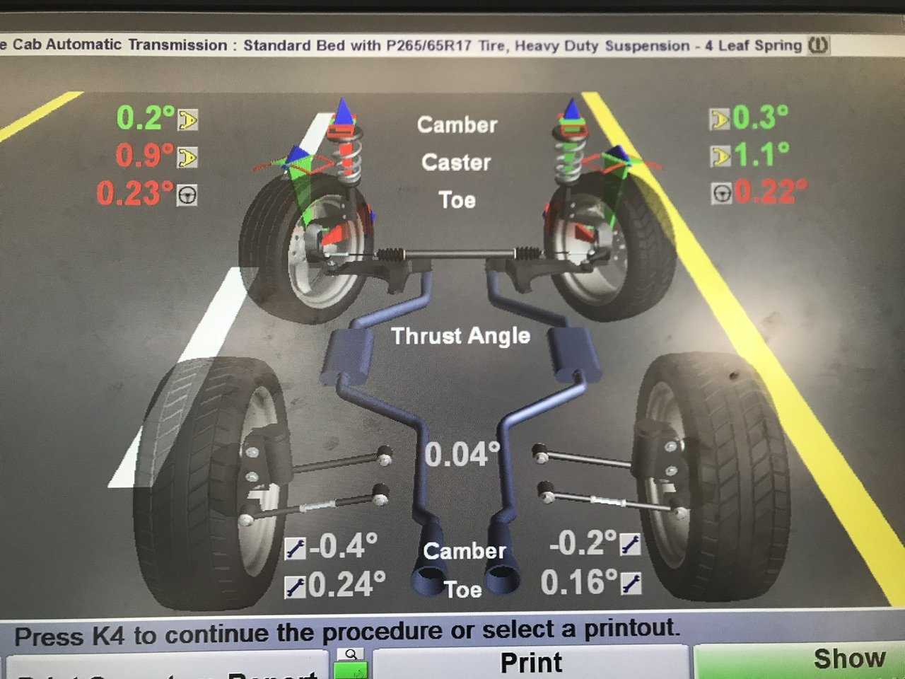

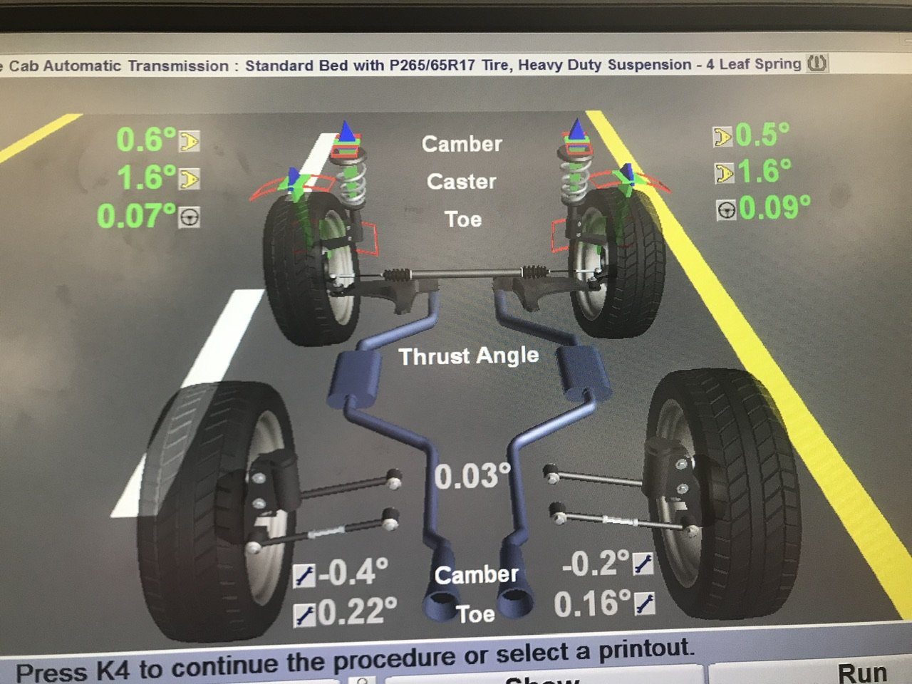

    Quick toe check before a test drive.
    It seems alright, and drives very nice. Collected and smooth. I’m looking forward to seeing how it drives off-road and specifically over washboard roads.
    Next order of business is to measure curb height and get it on the alignment rack.
    Still need to re-route Scangauge2 cable and start looking at running the CB cable through the bed and into the cab.

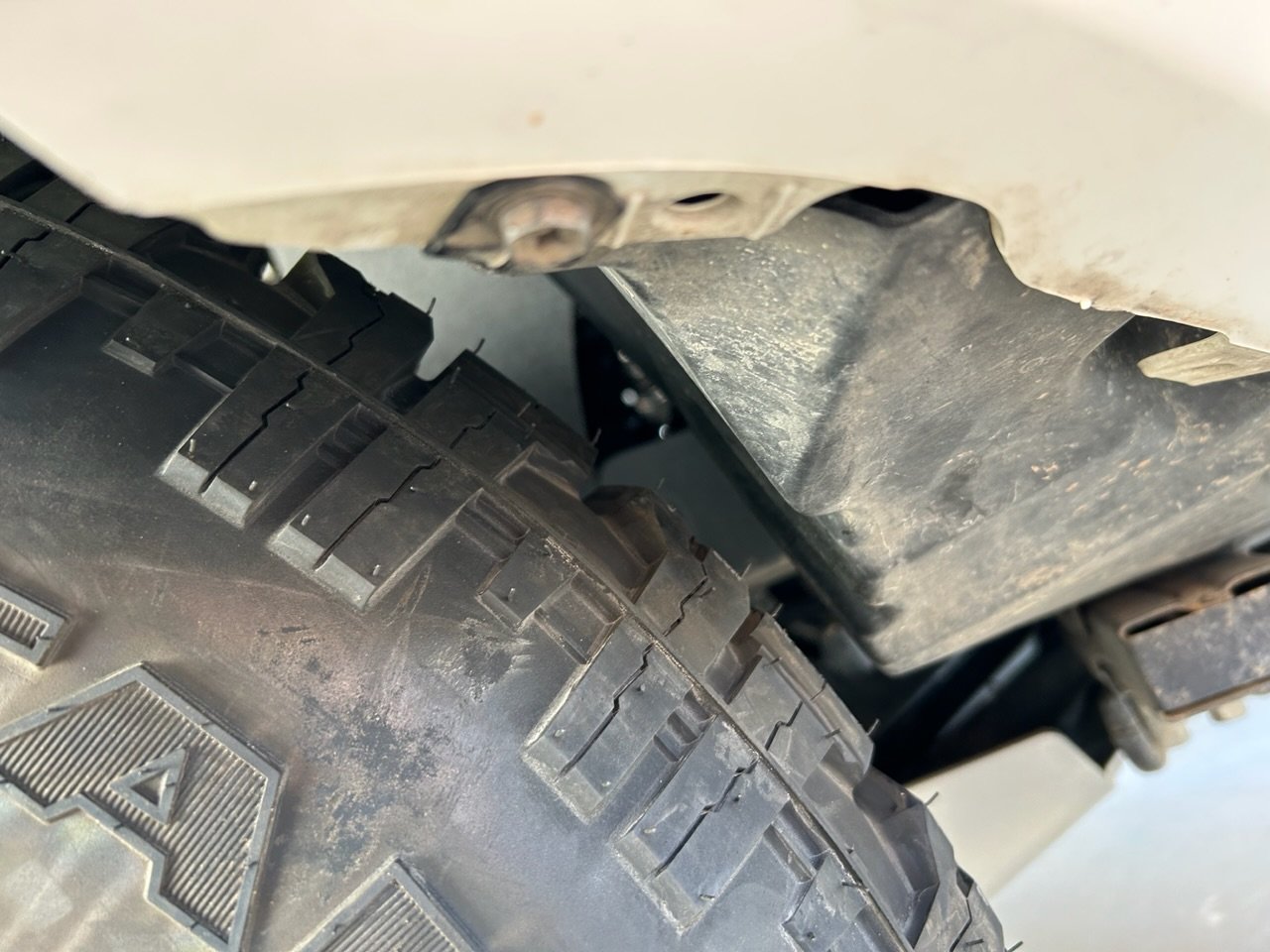

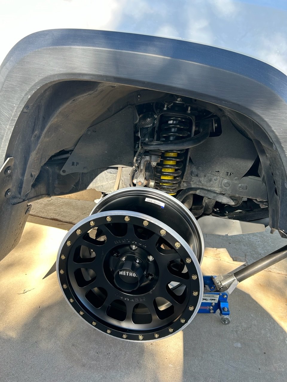

    New wheels and tires are on. Method 305 NV 17x8.5 0 offset with Milestar Patagonia X/T 285/70r17
    Before alignment
    After
    There is a bit of rub on the front when the wheels are turned, so some trimming will be required.
    I also need to re-calibrate the speedometer, TPMS sensor, reroute the ScanGauge wire and take it out to the OHV park to test it out.

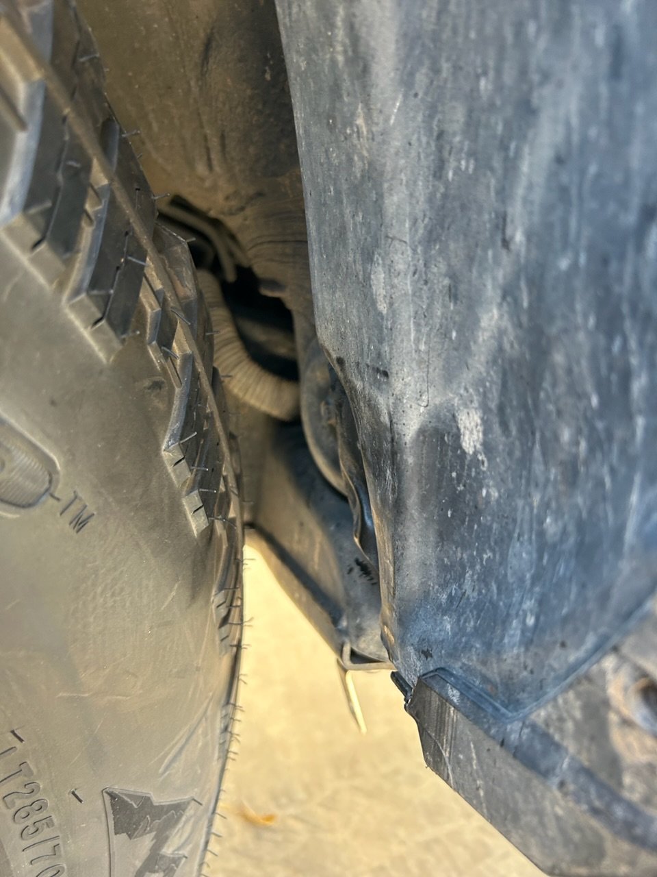

    Clearanced out the tires
    Took it to Rowher Flats OHV, no rub so far. I think I’ll still get fend x liners for my peace of mind though.

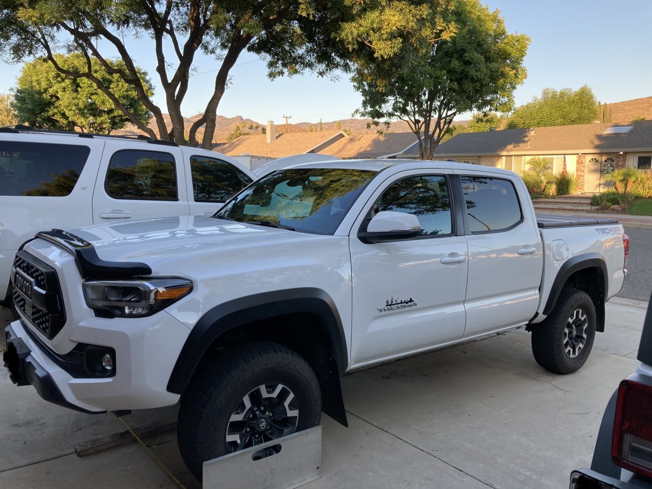

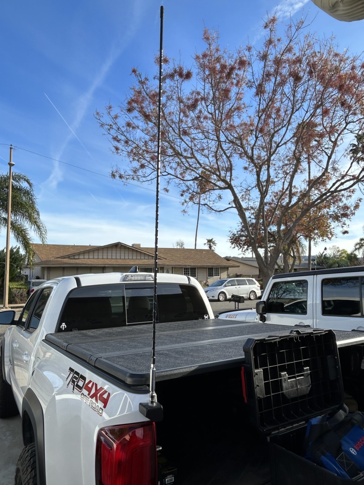

    Installed the CB radio. Tried passenger side first, but there was no good ground. Driver side had ground, so I got a bracket and installed the antenna there.
    Ran the coax along the frame and pop it into the cab under the driver seat. Velcro the control box under the seat and ran wiring to the battery.
    Final SWR is 1.4 on channel 1 and 40 and 1.1 on channel 20.

    That CB antenna mount looks rather sturdy, where did you pick it up? tia
  11. Dec 11, 2023 at 5:20 PM
    sarcastictechsupport
    sarcastictechsupport [OP] Well-Known Member
    Oct 4, 2022
    #407312
    222
    SoCal (805) - Mohave Desert
    2020 Super White TRD OR
    Made by Firestick. It’s a stud mount plus a quick disconnect on top. Since the picture was taken I’ve replaced stud mount with a spring mount and kept the quick disconnect.

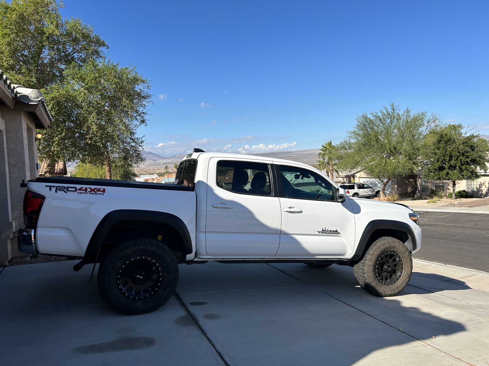

    I really like them. I have about 1600 miles on them so far. Ton of grip off road and no issues on the freeway. They didn’t take a ton of weight when balancing either. Here are some more pictures

    Here is a side view. Keep in mind, the driveway is a steep downhillIMG_0176.jpg

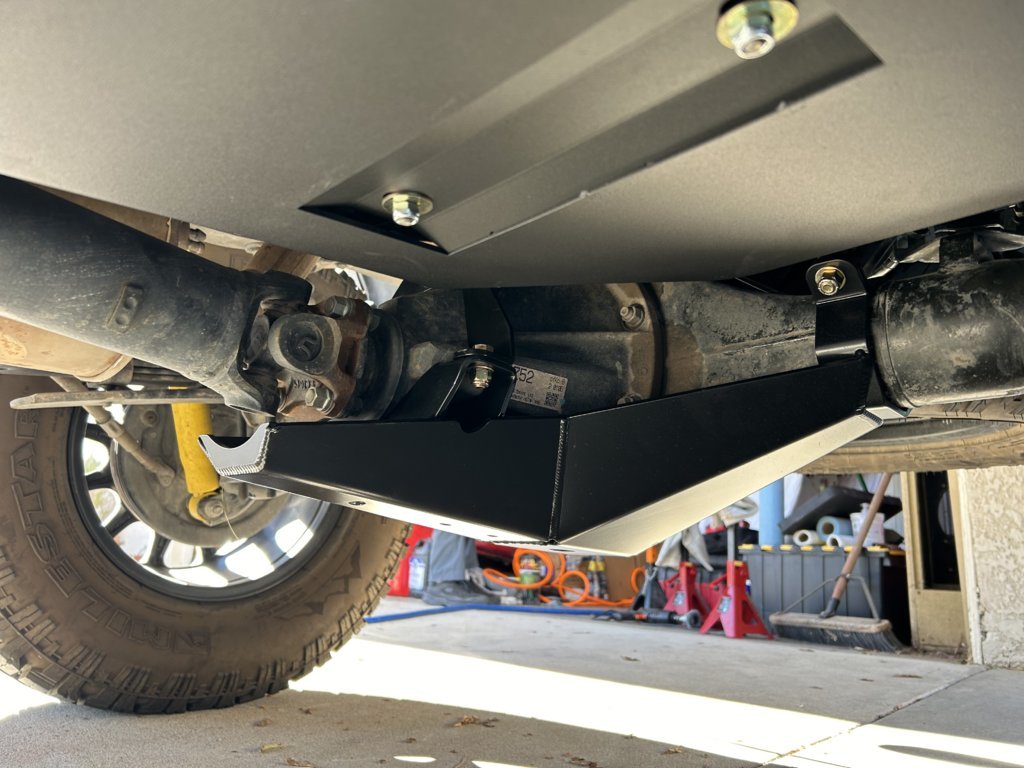

    Got RCI fuel tank skid and DRT Fabrication diff skid installed

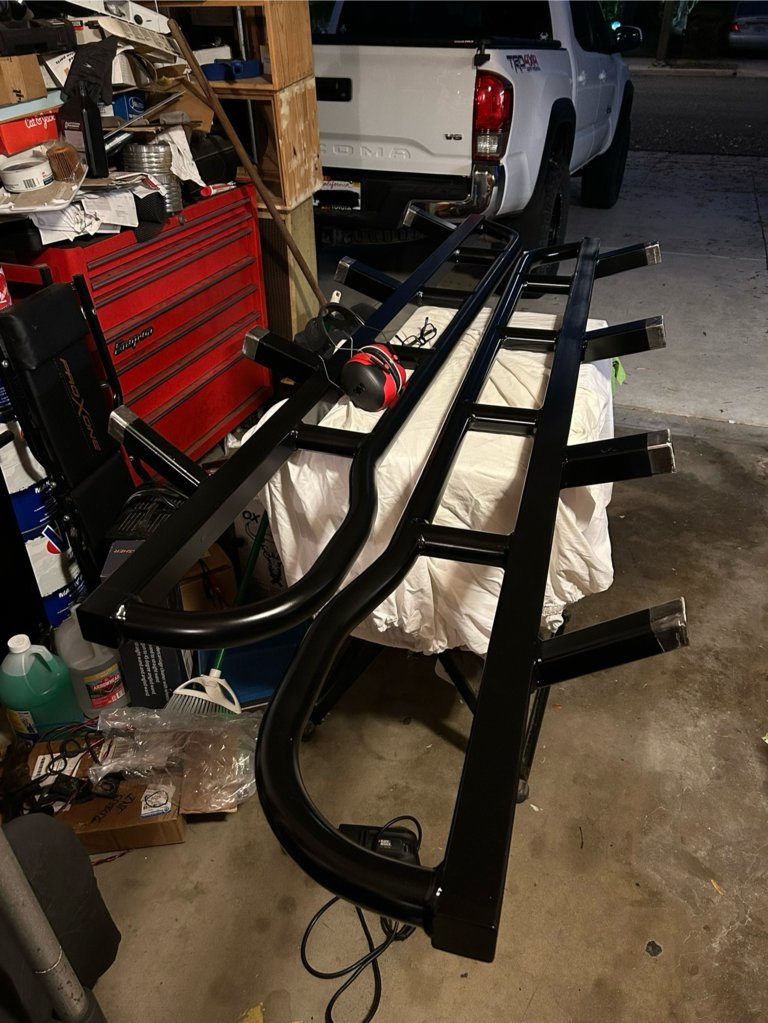

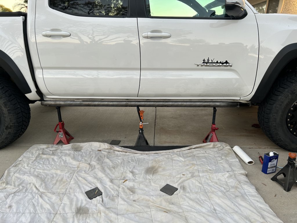

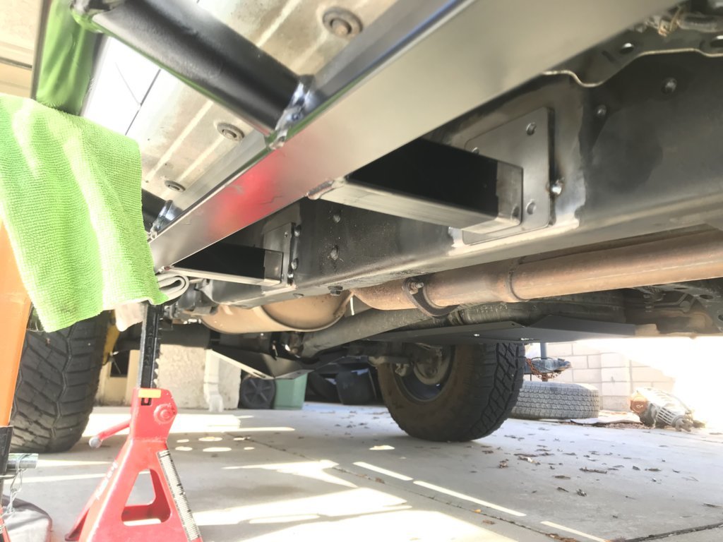

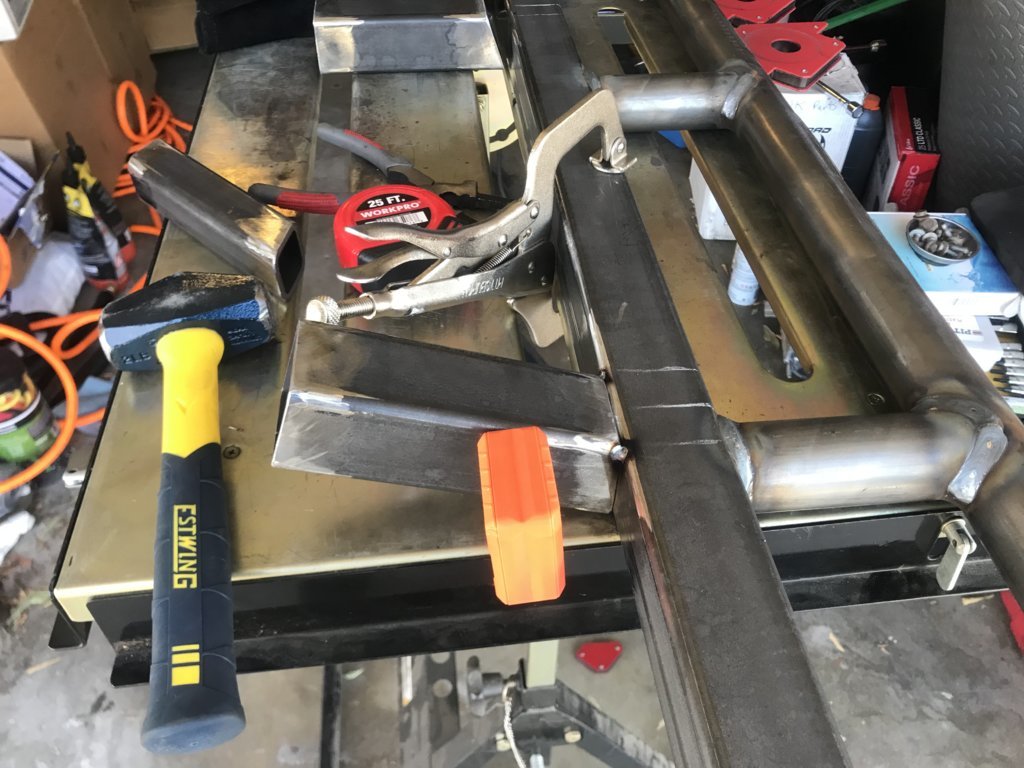

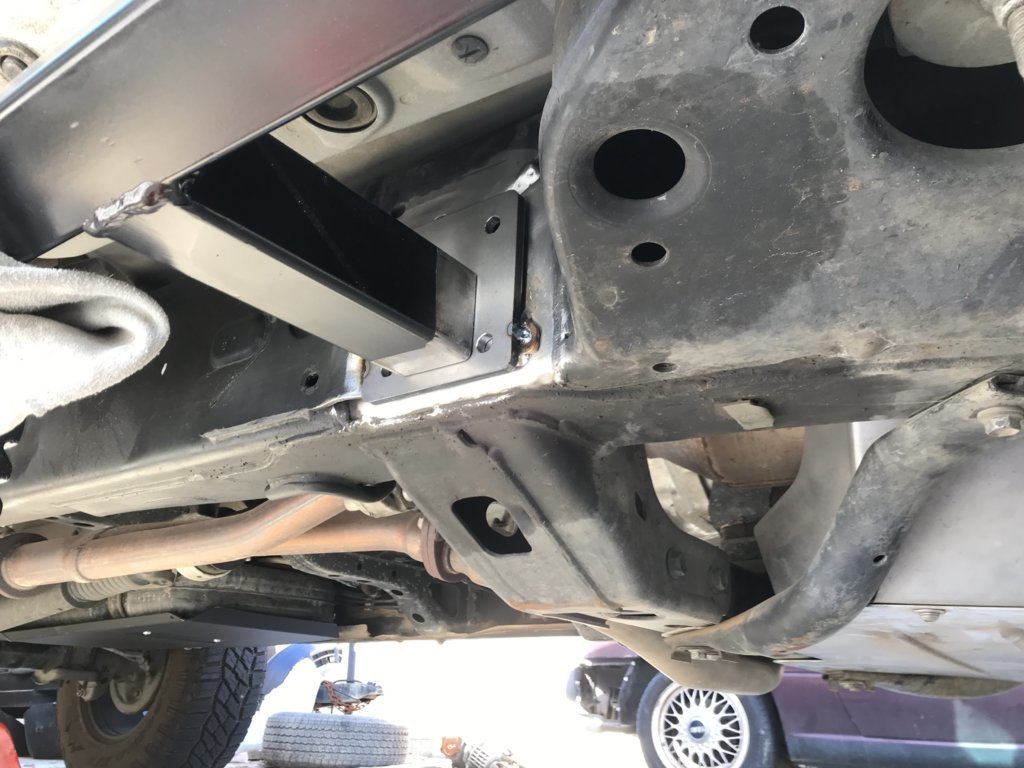

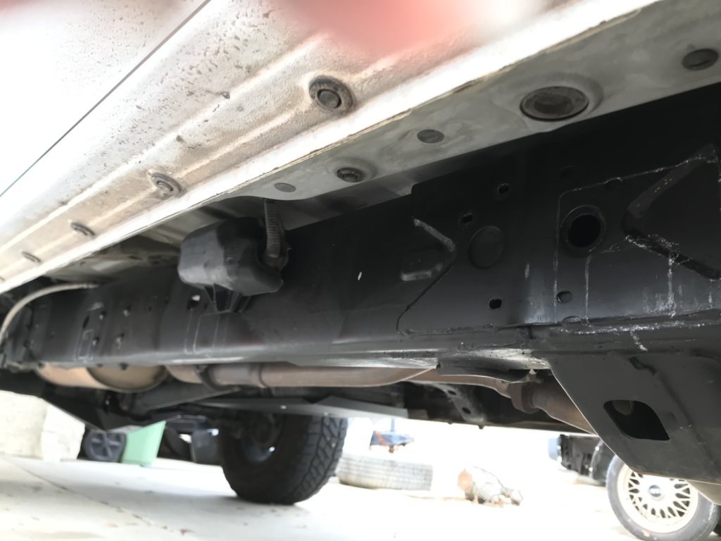

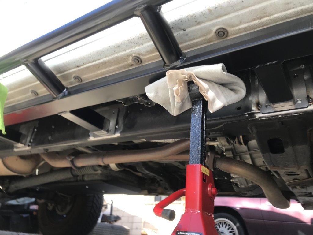

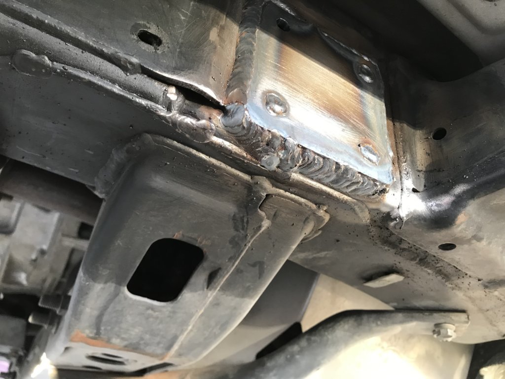

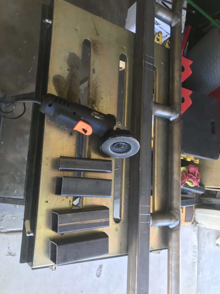

    Rock sliders project, 2 weekends in and counting. Rock sliders from 4xInnovations
    Mocking up on the truck
    Mocking up on the bench
    Welded and painted
    Marking up where frame plates would go
    Frame plates tacked in
    Frame plates welded in place
    To be continued…
