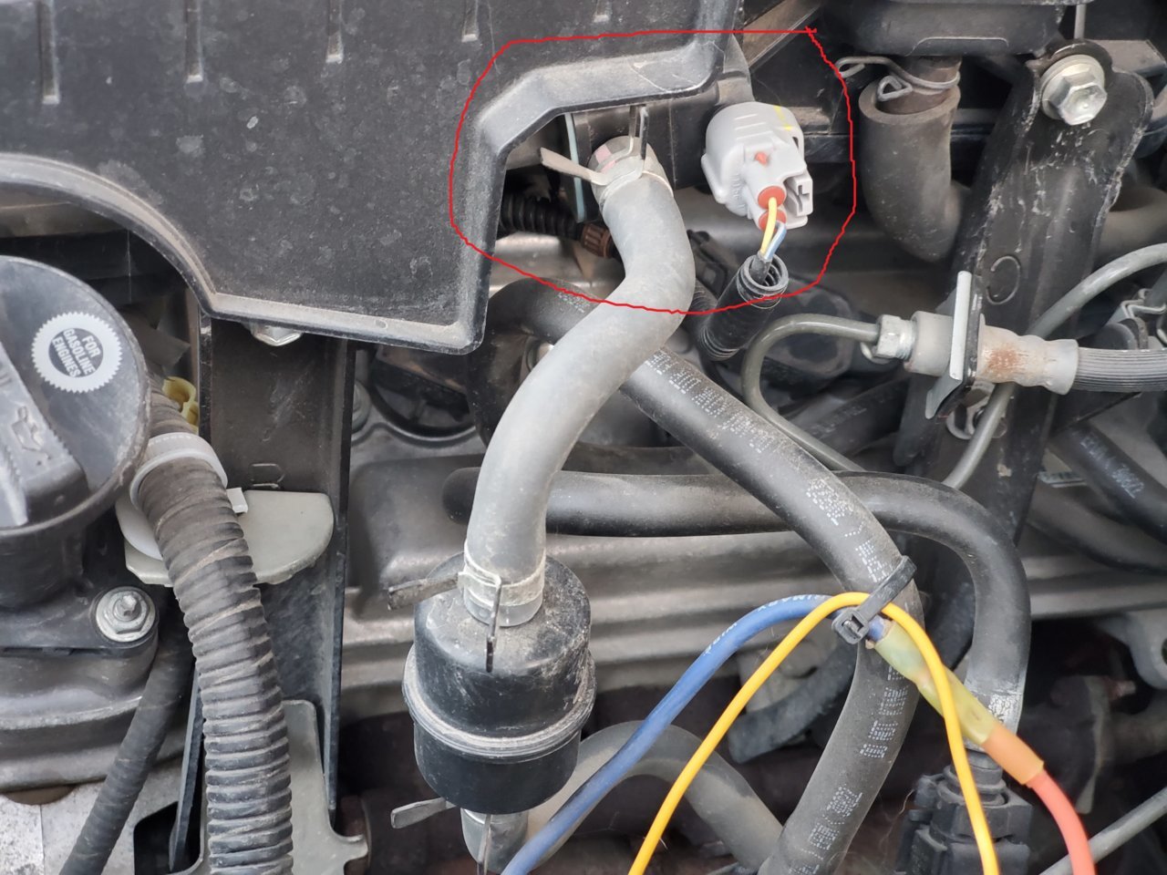

    Sounds like either a purge valve that is sticking open or a fuel pump that is on it's way out.
    You say it's only hard to start when you fill it with gas?
    Purge valve is an easy check, just pull the hose off and unplug the electrical connector (be aware this will set a code for the valve). If vacuum is present at the port with it unplugged and the engine running it's bad.
    To check the fuel pump would require a fuel pressure gauge with adapters to tee into the line.

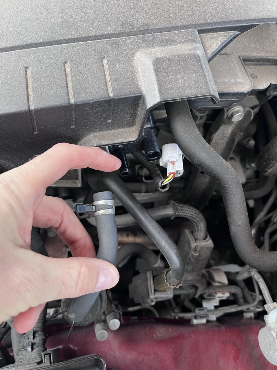

    I'm not as experienced as you guys so just to be clear, I took a pic. But I took off the electrical connector and hose and covered the port I'm pointing to with my finger. With the engine running, there was a vacuum in the port.
    Should I just replace the purge valve? And do you guys recommend finding an OEM part or just go to AutoZone to get one?IMG_4172.jpg

    That's it, I'd go OEM if you can.
