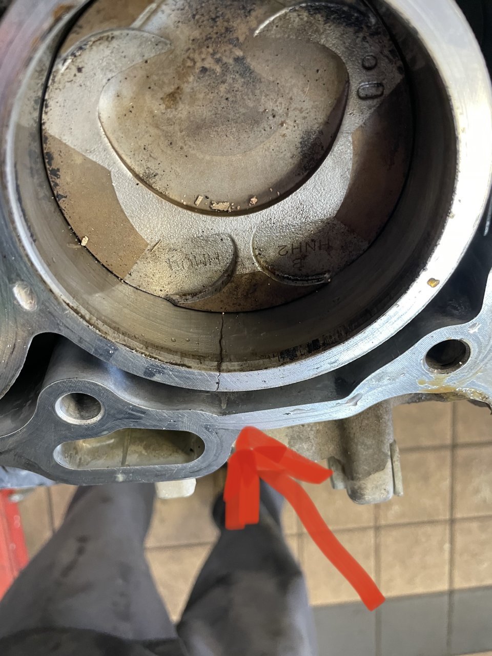

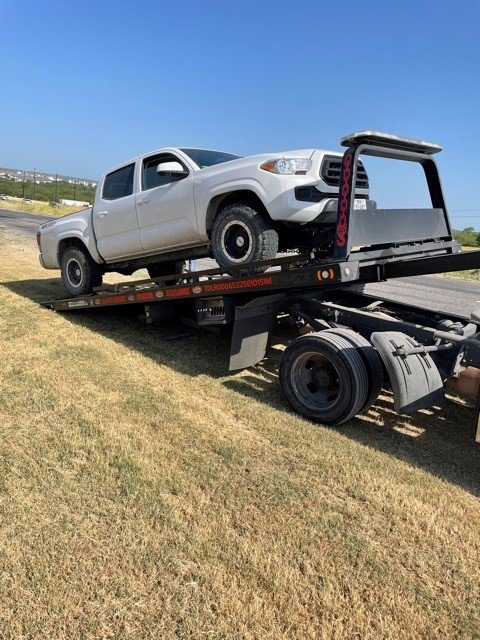

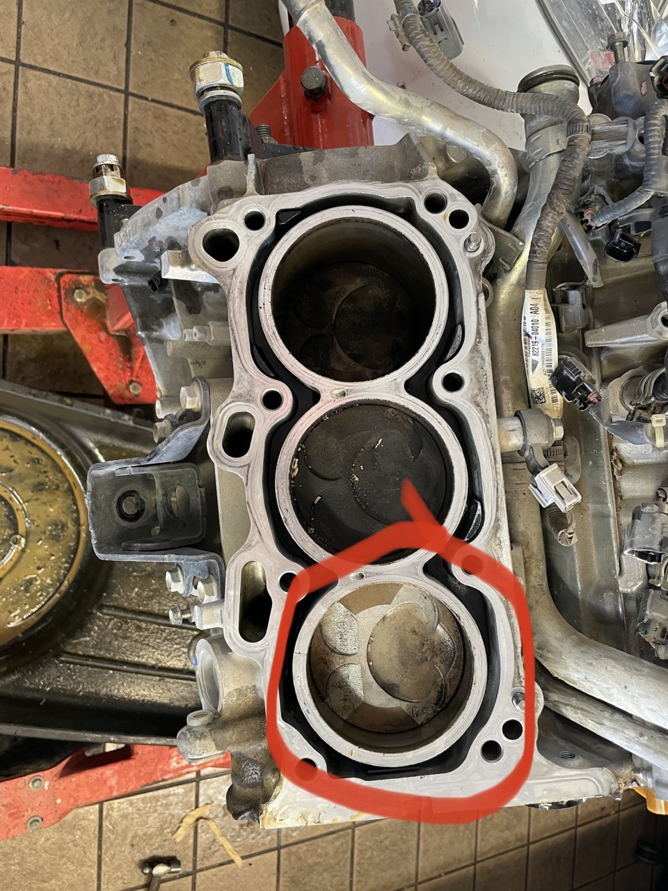

    2020 V6 Tacoma with 65K miles.. So I was driving to work the other day with no issues, then all the sudden check engine light came on and truck went into "limp mode". Checked water temp gage and it was right in the middle as normal and pulled off to side of road. got out to see my coolant reservoir boiling and over flowing.. then saw vapor coming from tail pipe. Open oil fill cap and vapor coming out there too. Confirmed oil level was good, but could tell oil got hot... Got it towed to a mechanic who later called and said I need to take it to Toyota dealership because it looks like I have sever engine damage. Called Toyota and found out that this could happen if thermostat or other valves failed... Powertrain warranty ran out at 60K miles.... Have you guys ever seen anything like this?? I'm getting it towed to Toyota Boerne tomorrow for further inspection, but for the company that created the Poke yoke (autonomous error proofing) I would think they would have designed in a fail safe for this type of system failure. Hoping my motor isn't blown :( ....
    Update: sounded like a quite pop then went into blown motor / cracked block mode…2E95EA19-01C1-410C-A95E-14AA0E1DEA25.jpgA9213915-7E49-41A4-B4AE-FDE3F6BE7F64.jpg
