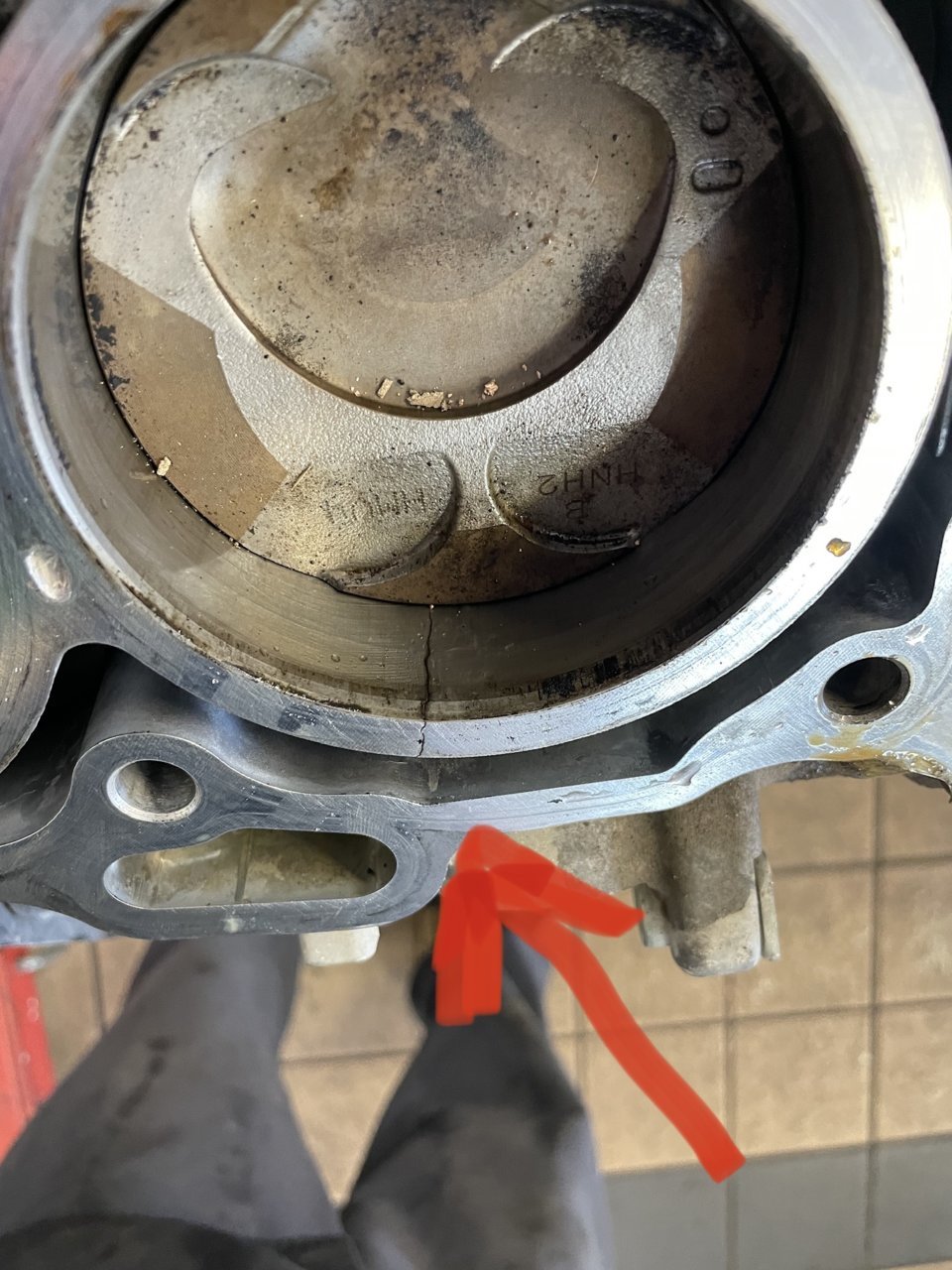

    Cast wouldn’t have cracked due to defective head gasket. Would’ve just fucked the head or heads at most

    The head gasket failed and let coolant into the cylinder, right? If the cylinder wall hadn't given out to relieve the pressure the next thing to go would likely have been the connecting rod with the obviously catastrophic failure to follow.
