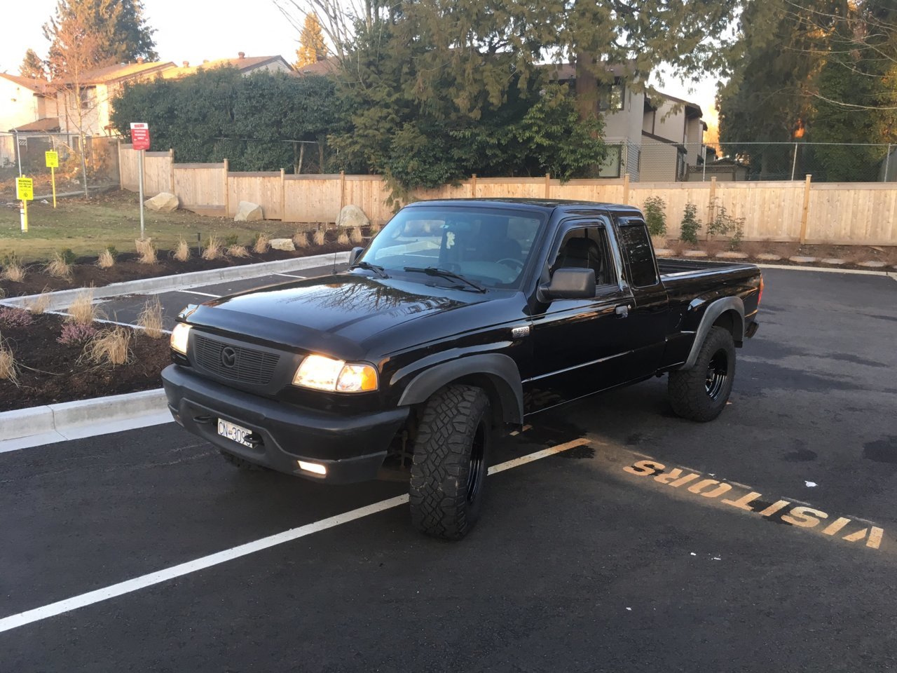

    I don’t blame you at all man.
    My 2007 Ford ranger that I wasn’t very nice to, well except for keeping it looking mint, went 165k miles and literally drove like new. I did regular maintenance and replaced 2 thermostat housings, starter, AIC valve, driver wheel hub and maybe some other minor things. Original clutch too.
    If my Tacoma won’t make 200k with regular maintenance and maybe a few minor things here and there, I would be very disappointed and would probably look at other options.
