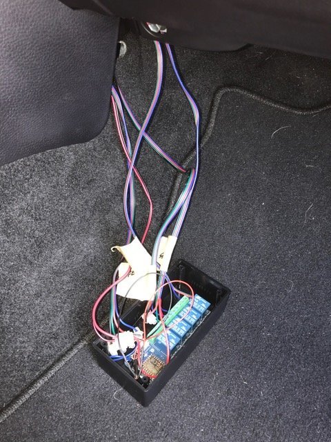

    Prototype (pic below) doesn’t look like much, it’s mainly a mess of wires with an ESP8266 chip at it’s core with relays for controlling output, an ADC circuit to read the steering wheel controls, and some other input switches. I designed this to be COMPLETELY insulated from all factory wiring, it will not introduce anything (noise/resistance/voltage) onto the already finicky factory wiring.
    I also managed to source all the Toyota harness connectors, so no splicing / cutting / joining of factory wiring harness, it’s all simple plugin.
    I’ll have to take a video of it working, as I realize it's hard to visualize, and it doesn’t look like much from still images. Hopefully I'll post a video next weekend.
    This is a prototype I've been running for a bit. Finished unit will fit behind the headhunt.

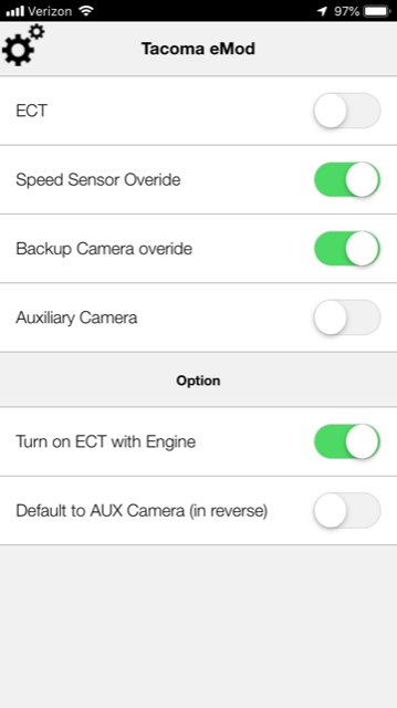

    The main web interface.
    (Since I have a bedcam, the default to AUX cam in reverse is for when I travel with the tailgate down).

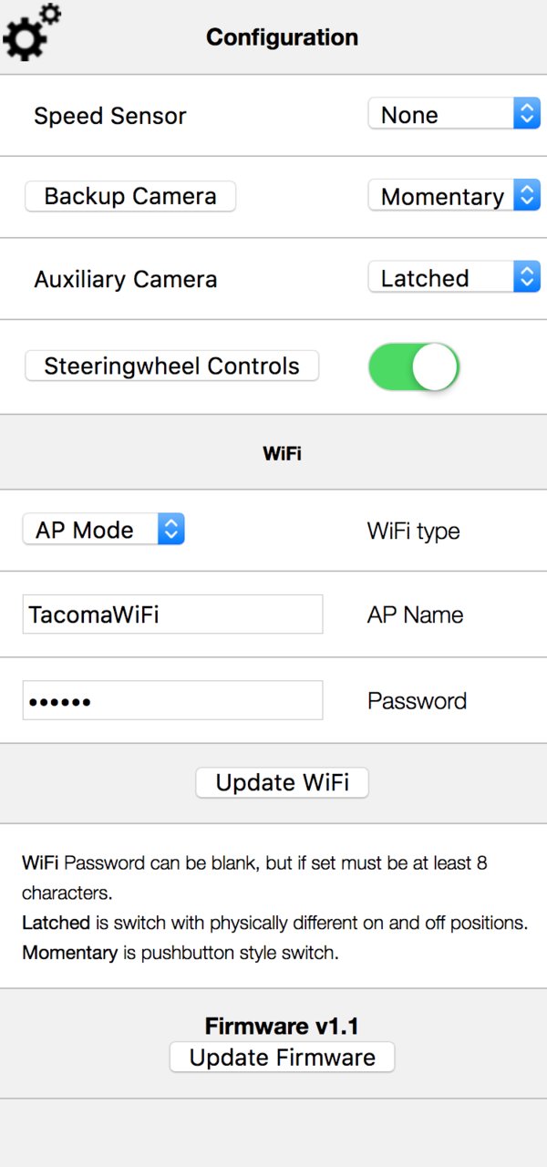

    Here is the main configuration options. The top section is external input switches for the main 3 functions. You can use a latched or push-button switch. When using push-button (or steering wheel controls) you can configure the switch to do different things depending on the length of the press.
    You can also update the firmware over the internet, since I'm sure there will be more things / options to add in the future once/if people start using this.

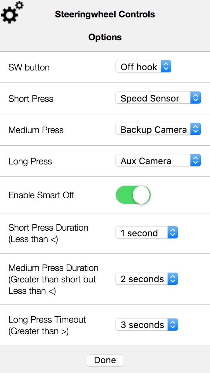

    Here is the config options for a push-button (in this case steering wheel control).
    Config the button ("off hook" is used as this does nothing unless you're on a call), but can use the other steering wheel control buttons as well.
    Smart off just means if anything is on and you press the button for minimum duration, turn it off. Without smart off, the "same time" press is on or off depending on state.
