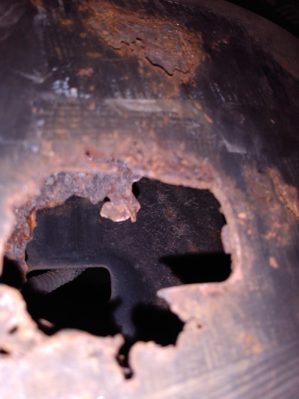

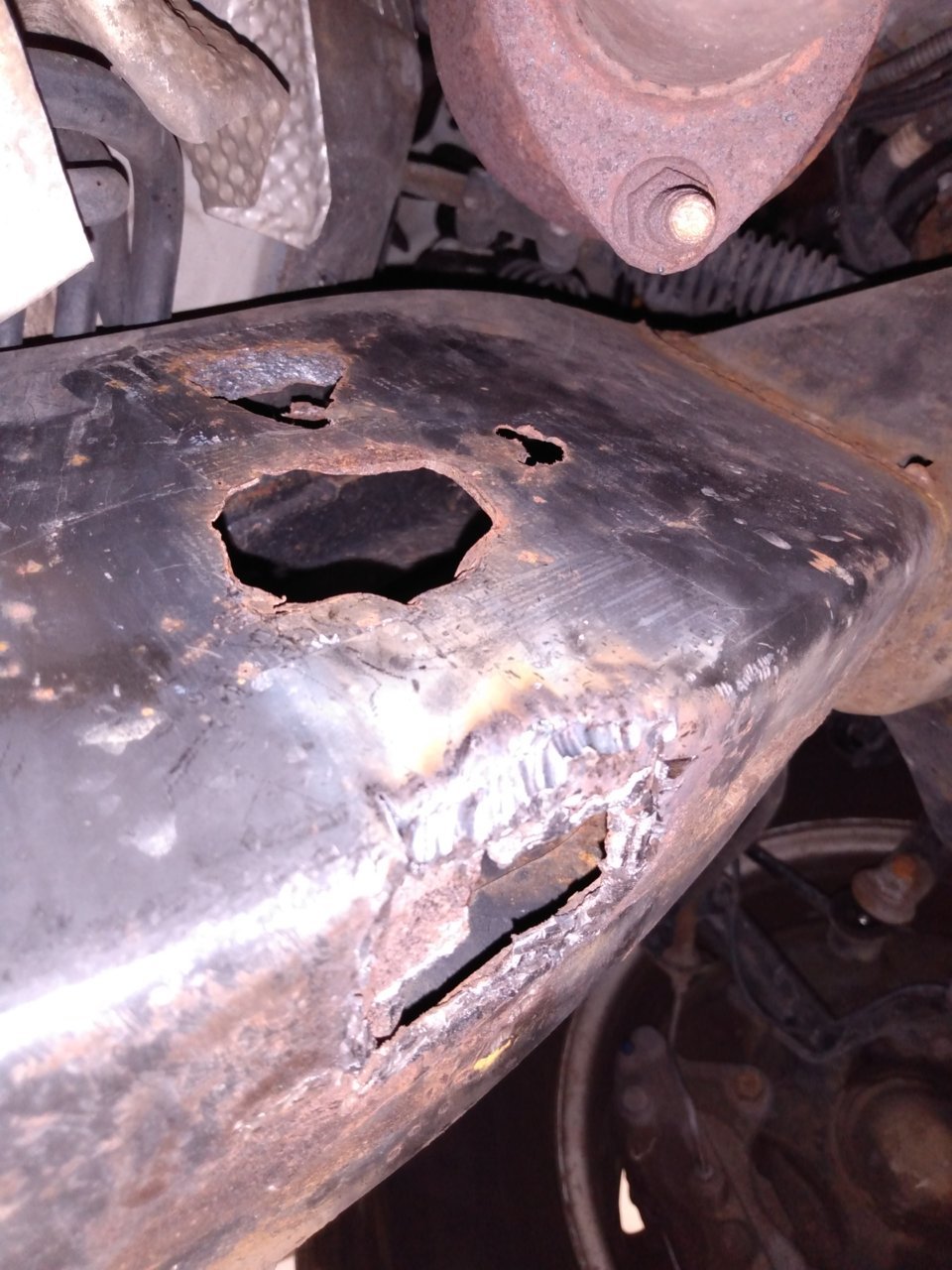

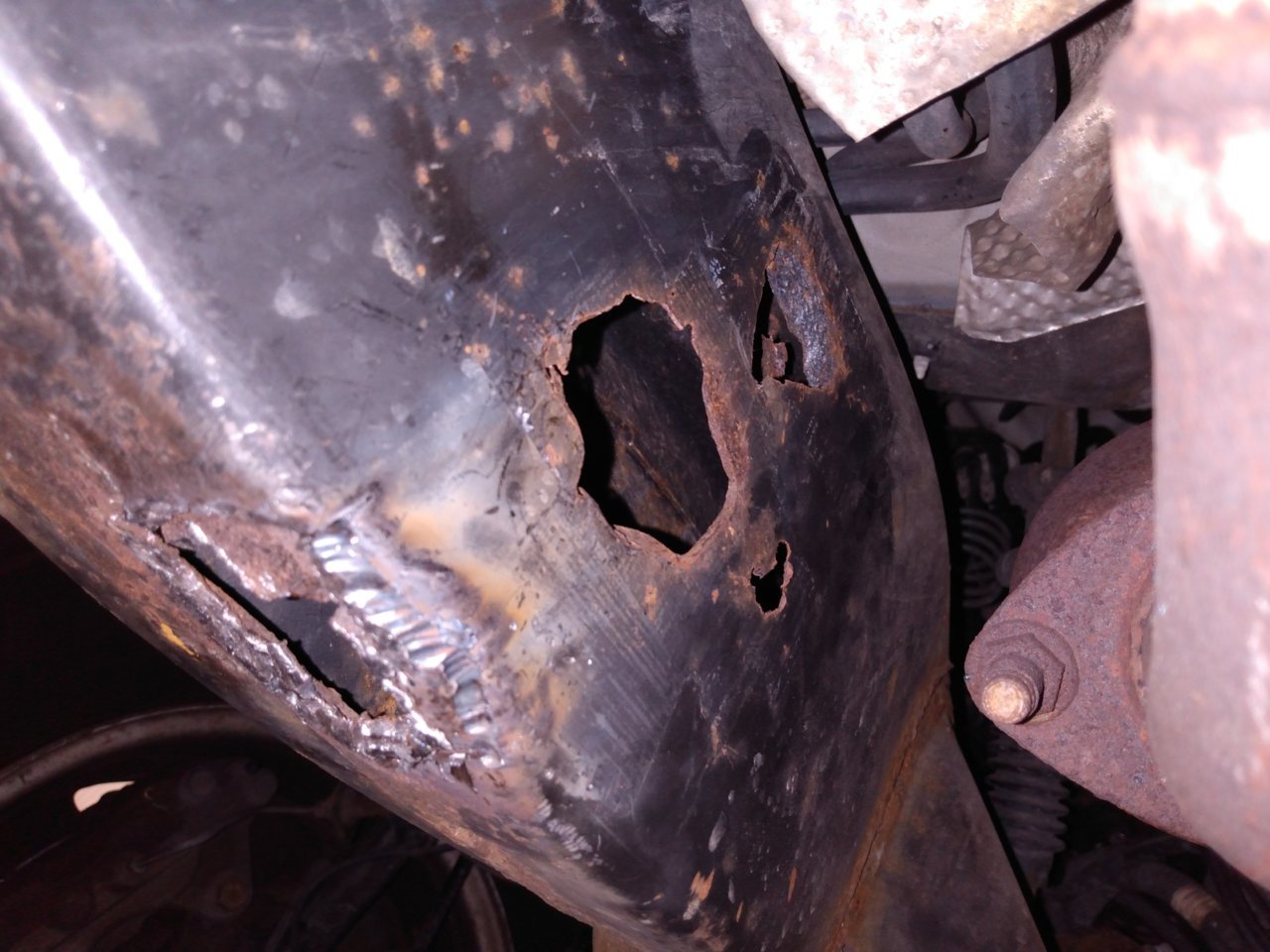

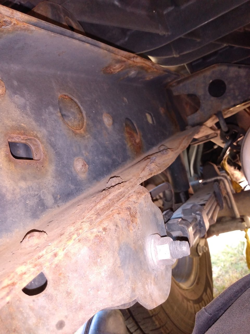

    Taking a poll how many of think this is repairable with safe T Caps or otherwise?

    It can likely be fixed.
    Whether it’s worth it probably depends on who is doing the repair and the condition of the truck as a whole.

    I'd be interested to figure out if they completely cut out the rusted part or to what extent they had to go in order get clean metal that was good enough to weld, also if they took the cab off the frame when doing this repair or not because working under neath is not good, not with this type of repair anyway.
    The photo of the boxed part looks so rusted I am not sure how he was able to install safe T cap on it.
    videos of Safe T cap seem to show them cutting everything out to the top but leaving the top part and then sliding the cap on but I thought you still had have good amount of good metal there otherwise what weld it to?

    No, but its a 07 Prerunner Southeast vehicle theres still alot rain here and when took it in to dealership for inspection they said oh its fine. Well I'd like a copy of the report but not sure who to contact exactly.
    They probably just lied on report as seems dealers don't like to repair these anyway.
    Additionally the dealership did not apply any CRC coating at time of inspection which from my understanding only vehicles in SALT states recieve the CRC coating. THing is if I had gotten this CRC coating it probably would not be anywhere near this bad now.

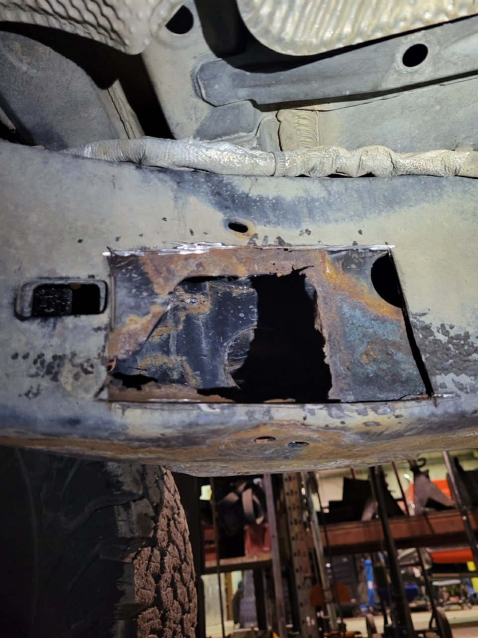

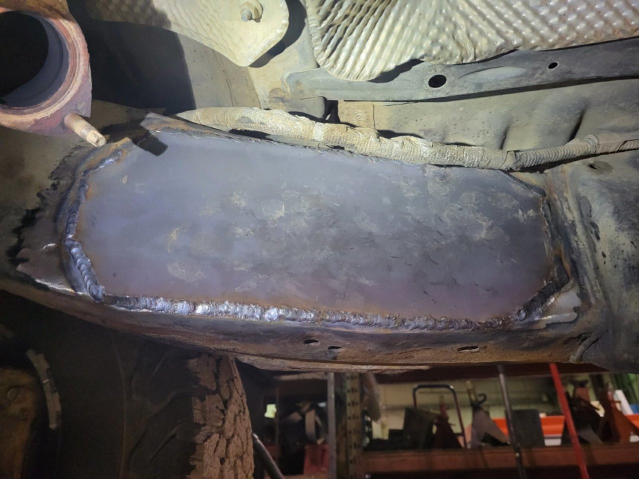

    Here's how I had mine repaired!

    It appears there are two different pieces of metal in this area so did they remove two pieces and weld just one piece over that?
    Was rust mostly on the piece of frame that is closest to the CAT ?
    What type of place did this repair a welder or a off road shop or what?

    @TacoBell07 Yeah they took alot more out than in that pic above. That was just when they first inspected it. The rust was exactly by the CAT on the passenger side. It was a heavy duty mechanic shop that did the repair, cost me about 500 CAD.
