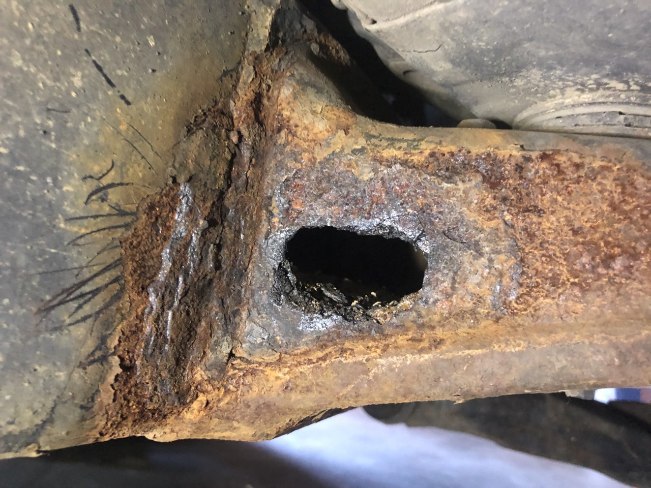

    7fingers
    7fingers Member
    Jun 30, 2022
    #400412
    8
    2010 black TRD Sport 4x4 access cab
    None
    I bought my 2010 new and took it in for the recall a couple years ago at which time they did the inspection and the CRC application and said that the frame was fine. Just two days ago I crawled under to do my annual scrape and paint on any rust that was showing on the frame and found a hole rusted through the cab mount. I called my local dealer that preformed the CRC application and talked to him about it and it sounds like it is going to be replaced under the frame warranty. I will find out Tuesday if it will be replaced. Truck still looks like new with 172000 miles with exception of the frame.2D7B8C0E-936F-4C3A-9C38-02A8540E9BA9.jpg201EB12B-56DB-40AF-9D40-D539158AFB01.jpg
