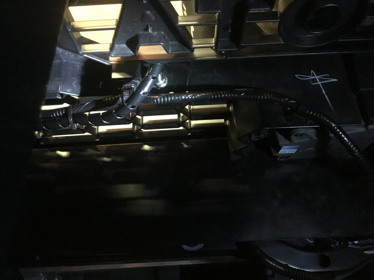

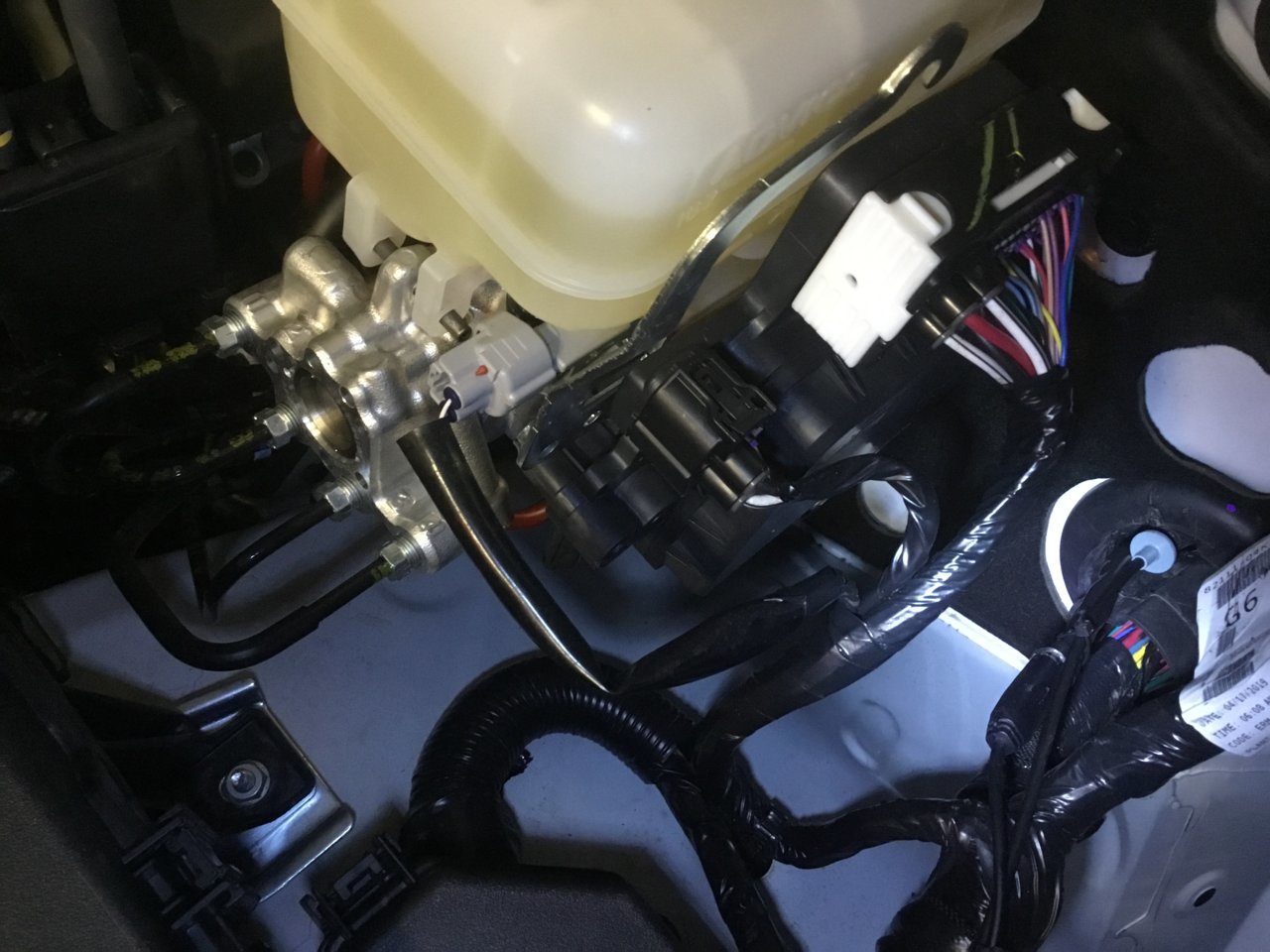

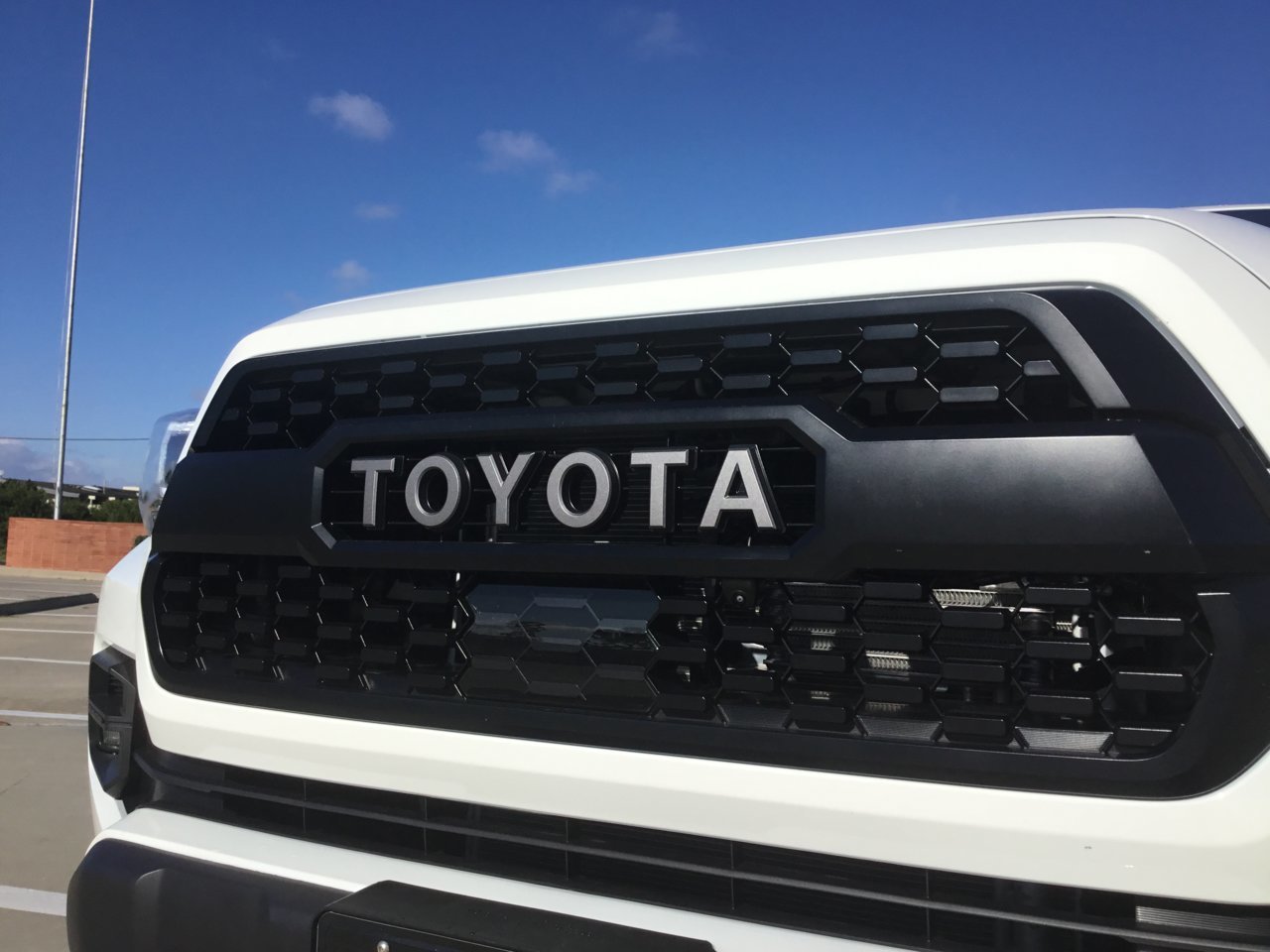

    I completed the other half of the install today by fishing the wires up to the head unit area with a coat hanger, plugging everything in and crimping on the hot/ground wire connectors from the camera. The controller truly is plug and play and a highly recommend mod. I like how you can elect to keep the front or rear camera on at all times instead of having it turn off automatically after 30 seconds. The Nikita camera image is great and the unit works flawlessly. Here are some pics...
    I installed the camera right below the “A” to avoid the TSS garnish
    Camera wires going the firewall. The breakaway connector is located just upstream of the firewall in the engine bay for easy access
    The camera from inside the engine bay with the wire protected by a corrugated wiring loom
    I tested everything before reinstalling the head unit. I still need to install a shim under the front camera so it just catches the edge of my front bumper. Install 99% complete!
