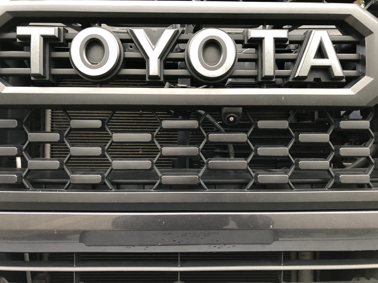

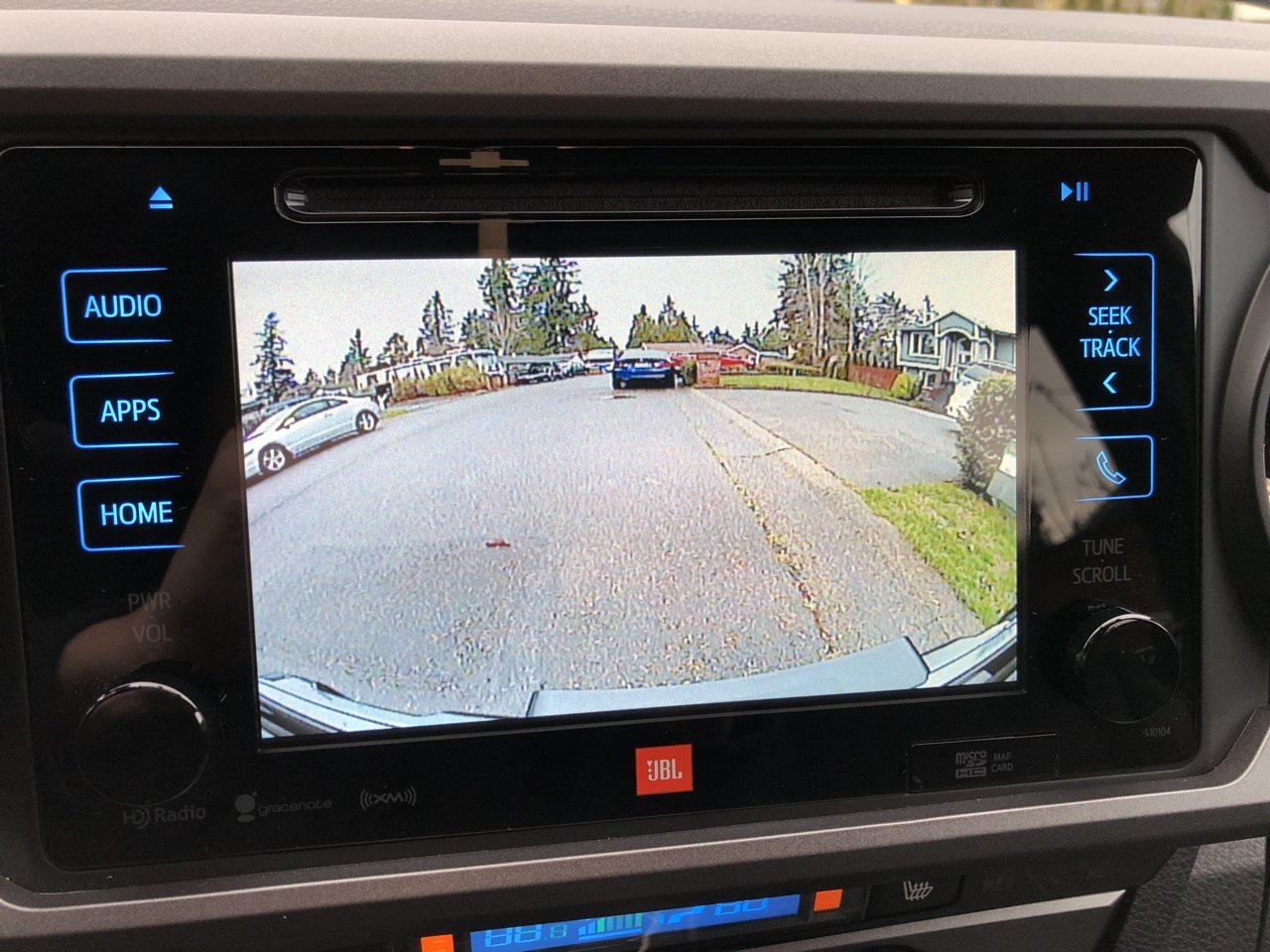

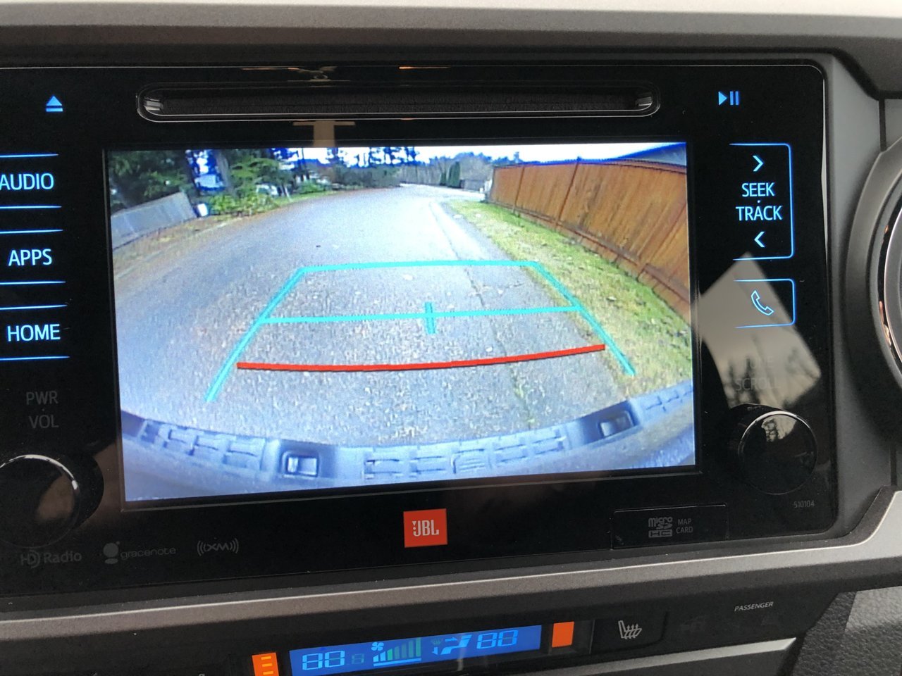

    Some pictures after I got it figured out. No guide lines and no inverted image.
    If Natika camera:
    - Cut green wire for no parking lines
    - Cut white wire if you don’t want inverted image.
    My truck is 17 has no TSS, knockoff pro grill.
