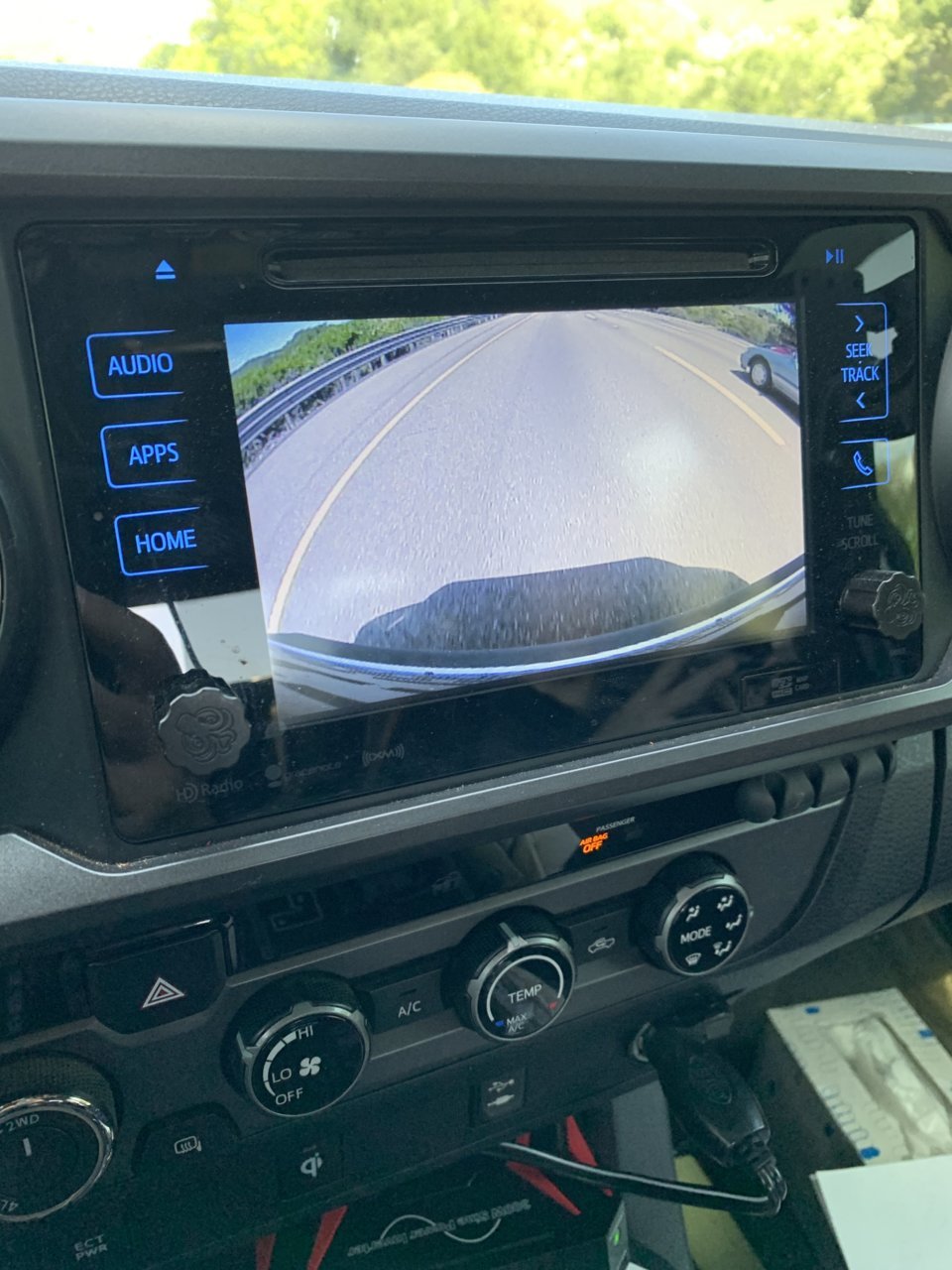

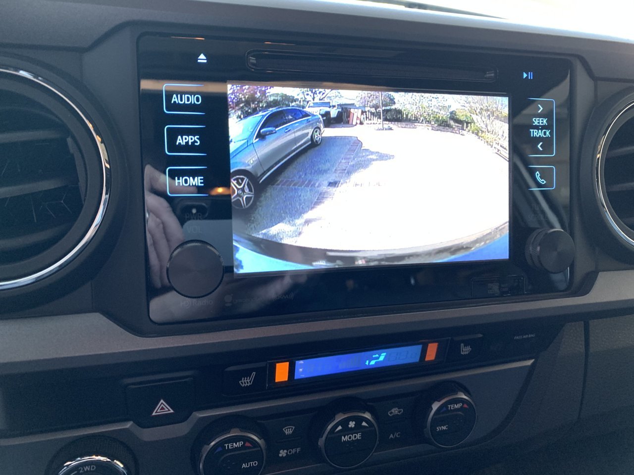

    Could you also please post one of those crummy iPhone photos of what the fwd image looks like on your Entune display?

    You can see my nose pointed to the sky... and I’m able to see everything below.... exactly what I wanted the front camera for! Thanks again for you help!

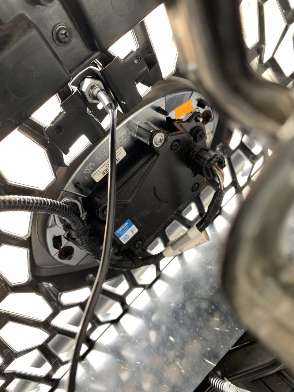

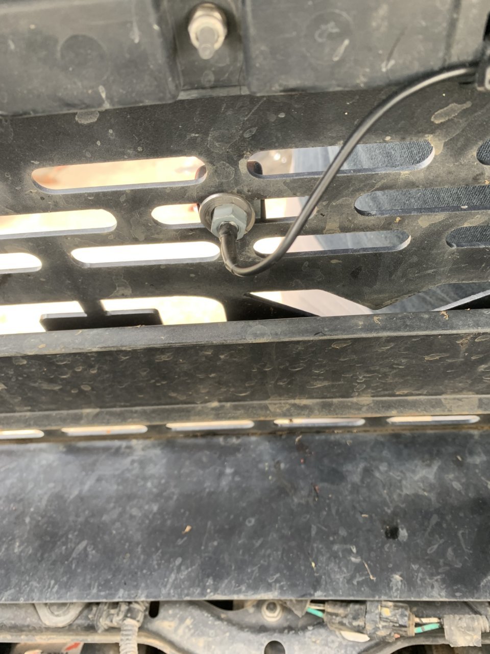

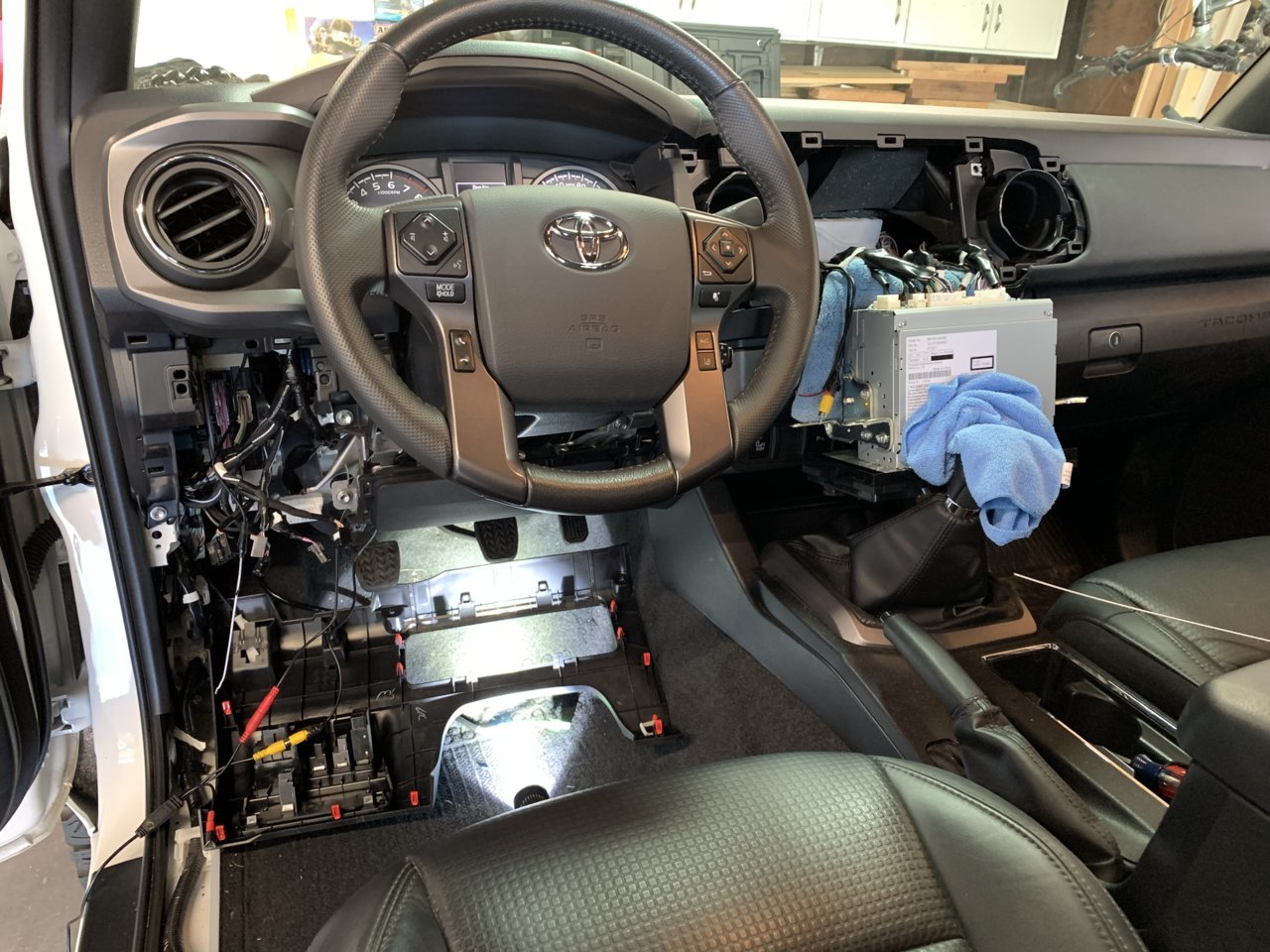

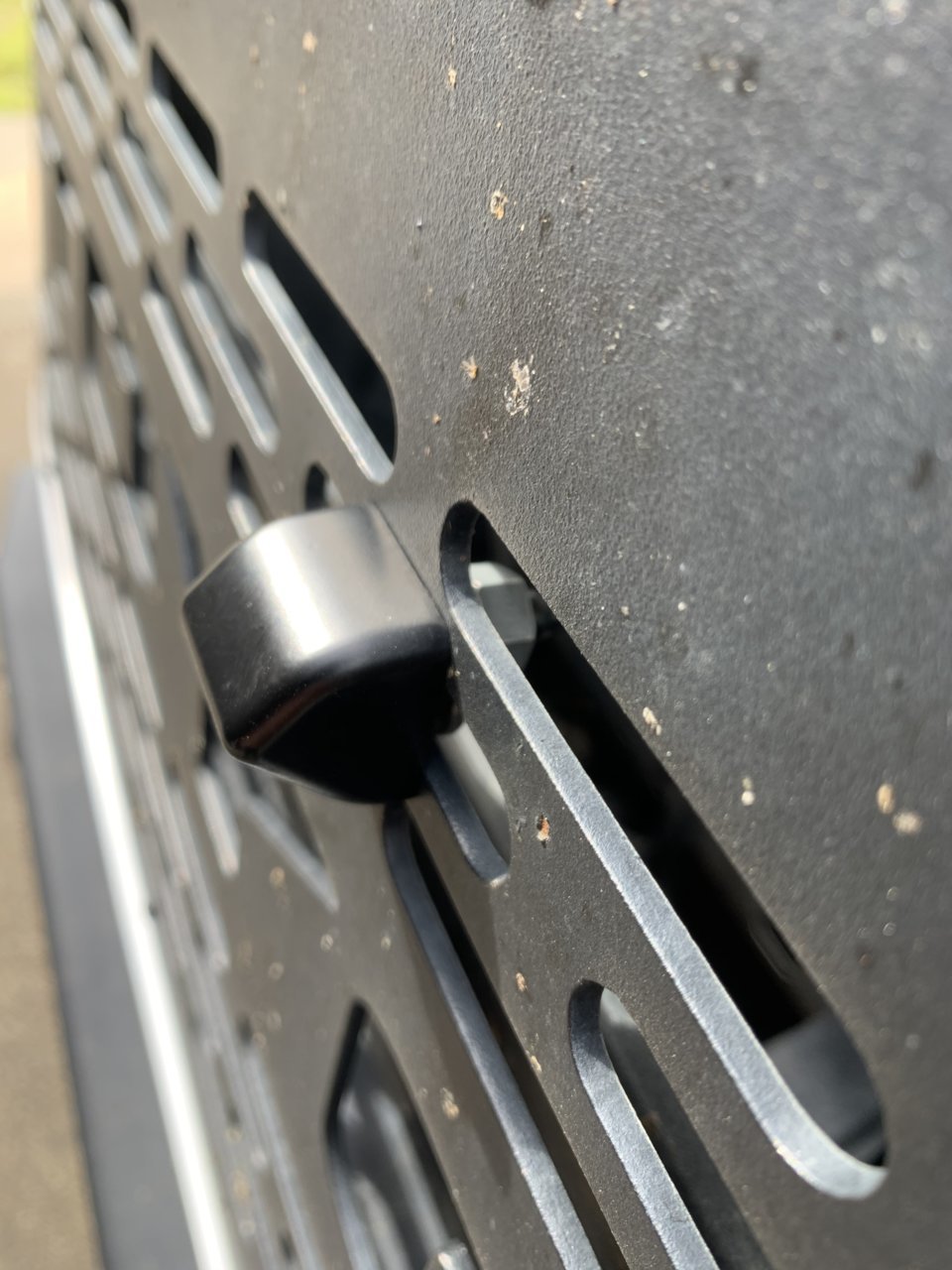

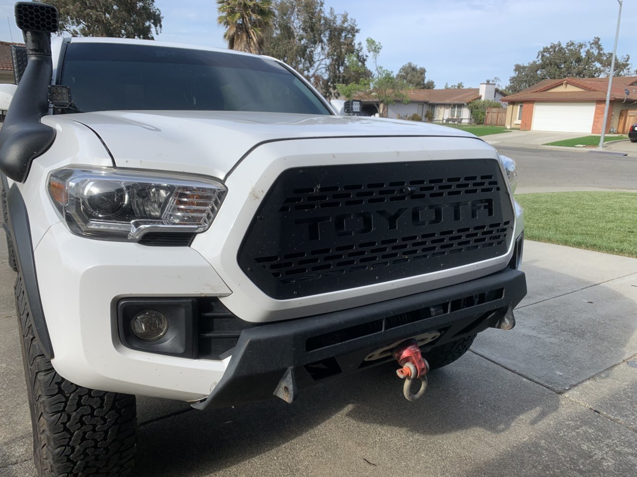

    Installed this in my 2019. My observations: Very straightforward install of the system, just take your time understanding how the camera wires into the system. (I bought the camera with the system.) Excess wire management was a bit of work, required lots of tie wraps. Taking the lower dash off was key for me -- highly recommended. My particular grill was the biggest pain. I ended up fabbing a rudimentary bracket to fit the grill - see pics. Seems to work.
    One thing about the function of this setup: Pushing the Mode button twice activates the front camera any time, as advertised. However, I thought it would stay on until manually turned off, but it turns off after 30 sec(?) like when you change from reverse back to first gear. I'd have preferred it stay on continuously for trail use. No big deal, but not perfectly optimal.

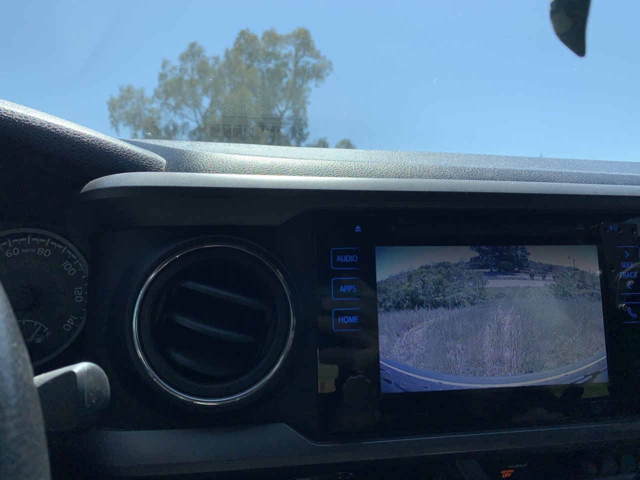

    I know this is not the best picture but I figured it would help, I'll get better pictures and a video in the near future.

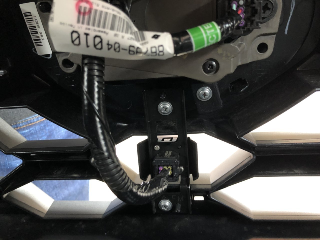

    In the mean time anyone out there already fitted a camera to a 2020 grill? Would love to see the position and type of camera/bracket used...

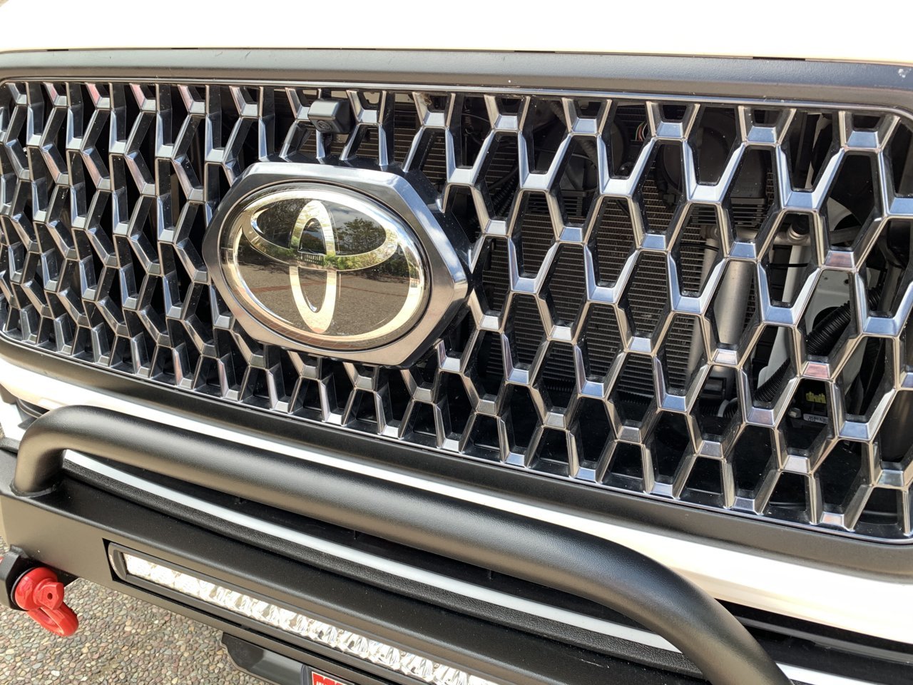

    This is not mine, but @Tullie D recently put a 2020 grille on his 2019 truck.

    Tullie D Well-Known Member
    Mar 5, 2019
    #285417
    2,553
    Tullie
    Wilson, NC
    2019 SR5 V6 SSM Access Cab
    mosccat likes this.

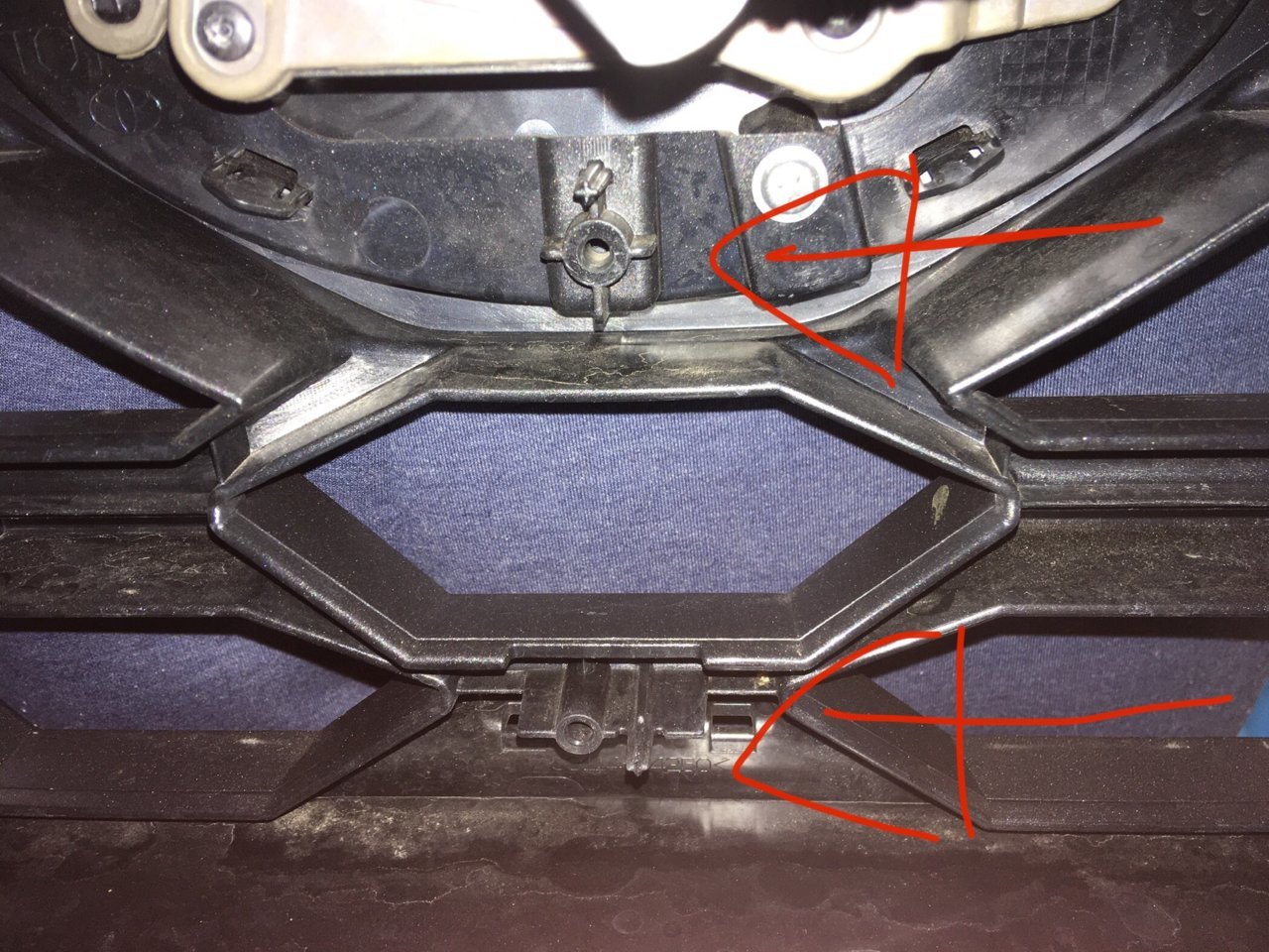

    I should have specified the new OR/Sport grilleo_O
    I’ve just been out and looked at mine and I see there are mounting points for the oem camera. I’m going to look to see if I can find a part number for the oem camera to see if there is a bracket to make things easier....

    Found and stole this photo from @alexthesparky, thanks . By the way nice truck!
    I’m thinking it’d be easy to utilise an old strip of plastic to make a bracket.
    Alex, do you per chance have a part number for the bracket?
