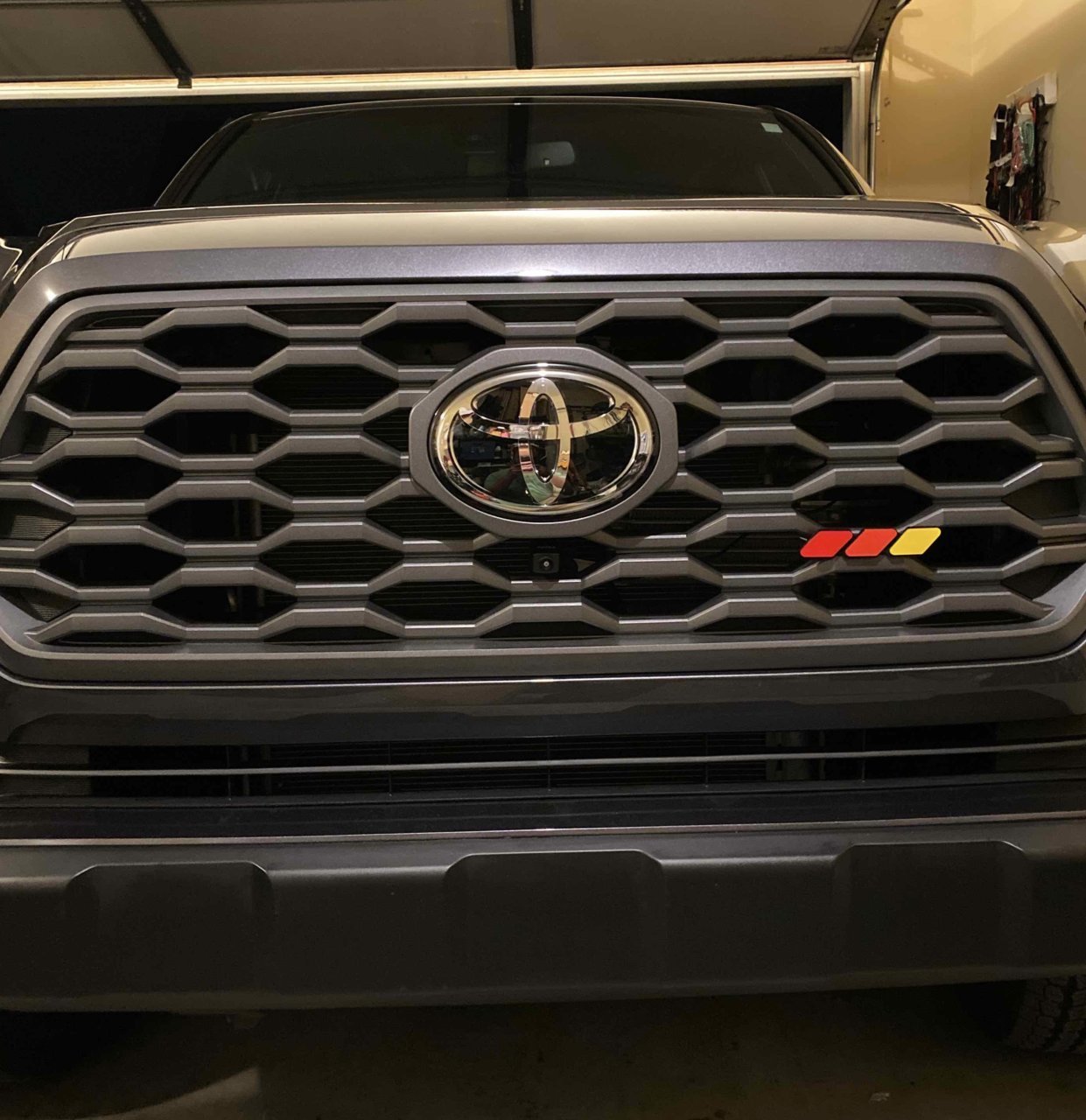

    I have, we used a different camera for the anytimebackupcamera.com version.
    This is the camera:
    https://www.amazon.com/Backup-Water...akita+bac&sr=8-6#immersive-view_1582870128797
    I made a bracket out of a piece of 1" bar thin aluminum I got at home depot to fit in the stock camera location on the grill and plasti dipped it so it would be a little more hidden. I bent it so it was flat at both screw locations and pointed the camera at a slight down angle. Same angle needed to get flat at both screw locations. The thin aluminum bent easy and it is rigid enough at speed. I can get more pics if you need them. I purchased the screws for it at Toyota that are the same screws the OEM bracket uses. Part number for screw is 90167-A0021.
