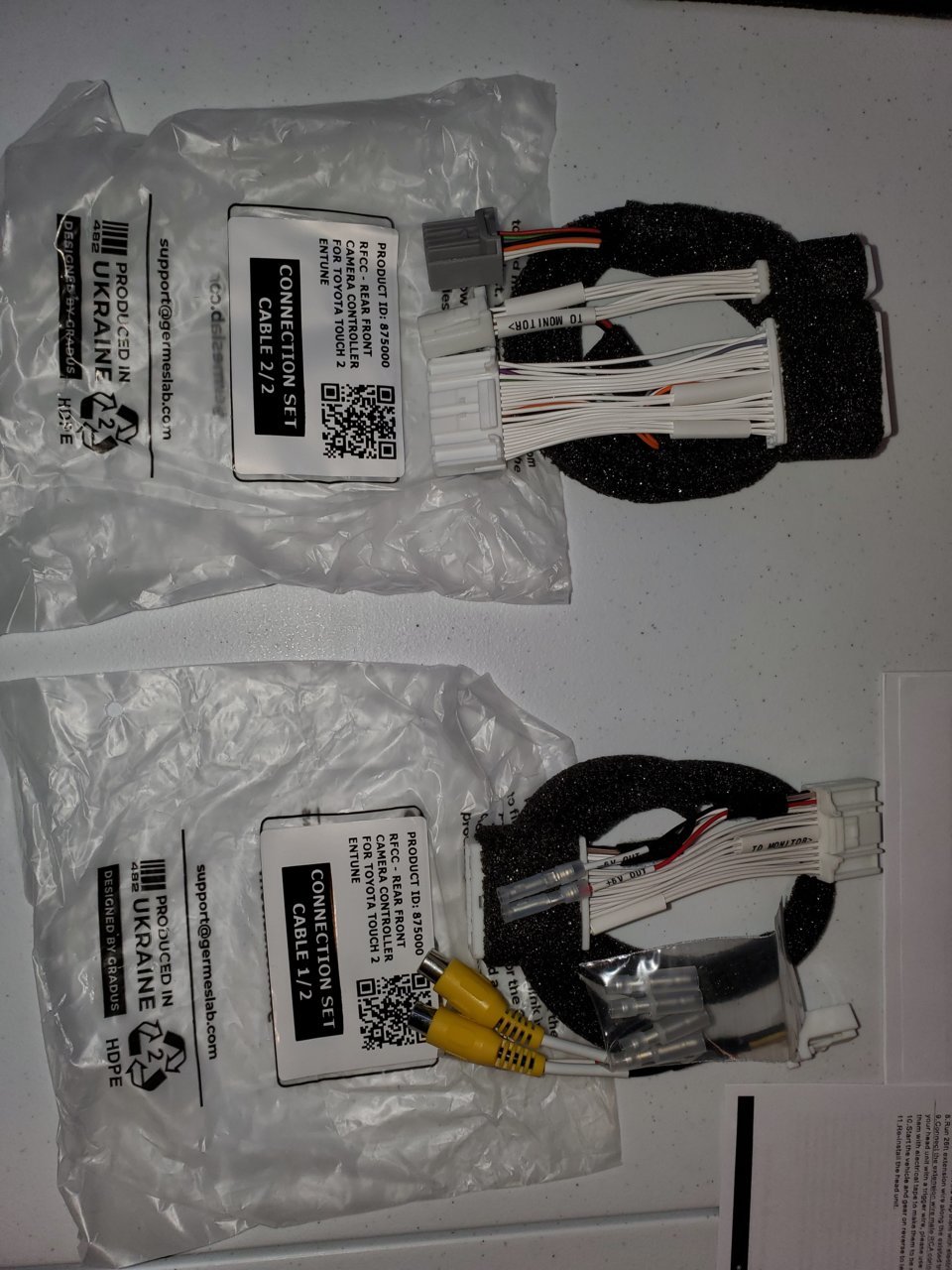

    DES2009
    DES2009 Minister of Truth
    Jul 22, 2014
    #134426
    1,000,546
    Southeast Louisiana
    2017 MGM Limited
    I'm a Millionaire! One Million Posts!!
    It's pretty tight back there. Plus, the HU has a cooling fan on the side of it... at least mine does. Someone in a recent post mentioned removing that foam stuff from the Germes harness and wrapping it with something else (tape?) so it would take up less space. I didn't do that... I just saw that post in the last week or two. Found the post.
    This pic shows the foam that came on my harness. I'm wishing now that I had taken more/better pictures of the harness.

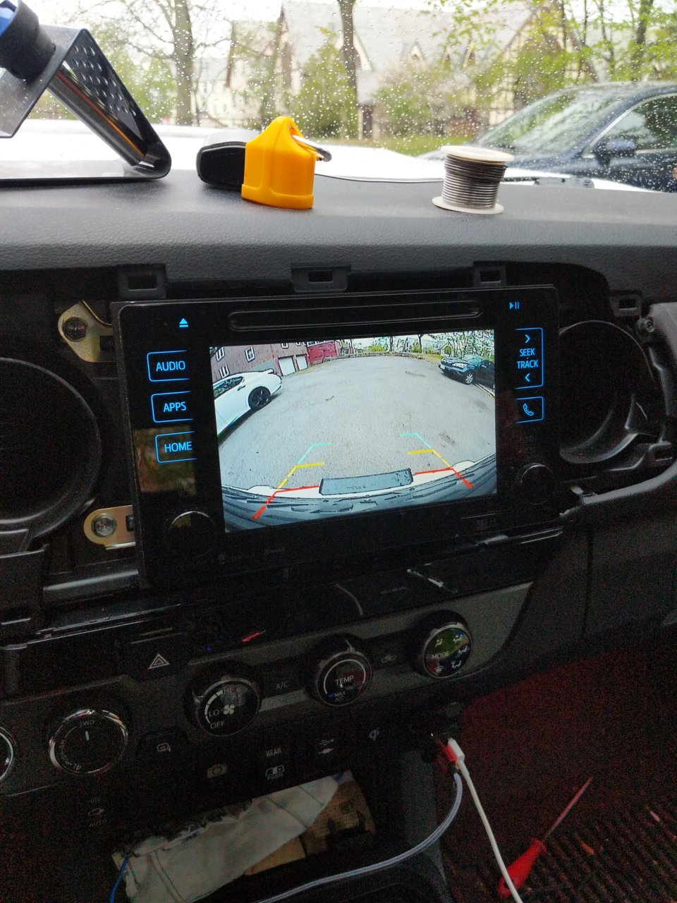

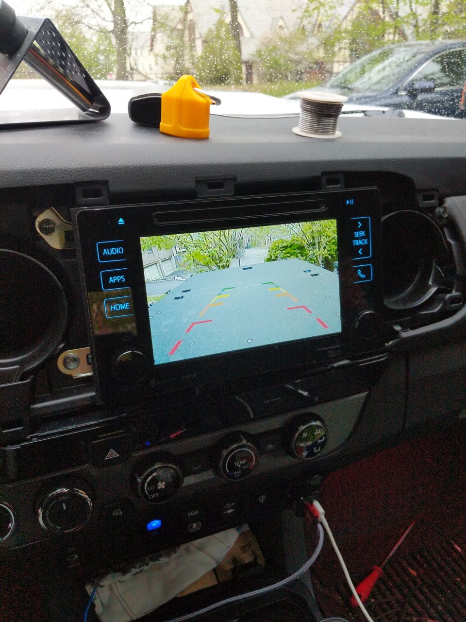

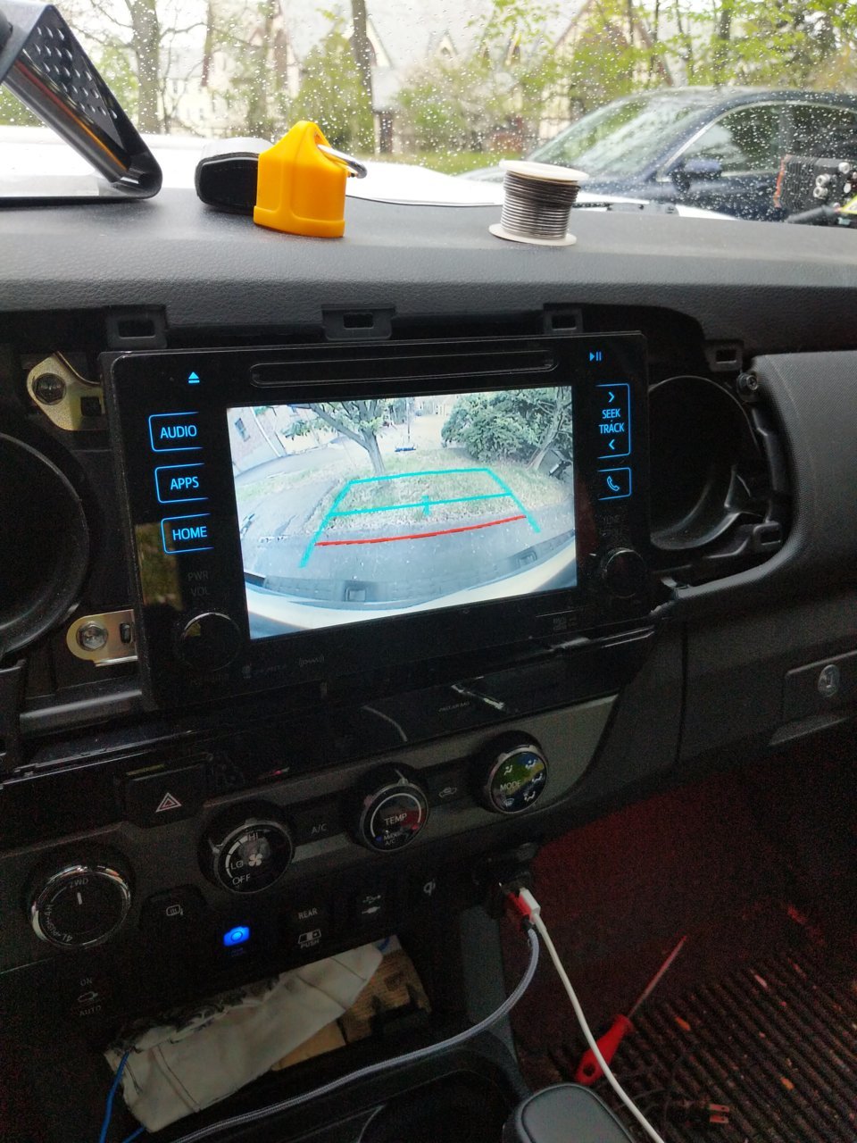

  18. May 8, 2020 at 2:39 PM
    #658
    CttAznRanger
    CttAznRanger Crazy NE Asian with the Cali Lean (temporary)
    Dec 3, 2018
    #274702
    4,754
    Brandon
    Boston, MA
    2018 Tacoma TRD Sport
    Ladies and Gentlemen, it lives!!!
    1588973909927179332799136806605.jpg 15889739318697669542756653272083.jpg 15889739471305928139068684968475.jpg
    badkids, hyrule_trd, DES2009 and 2 others like this.
  19. May 9, 2020 at 12:26 PM
    #659
    tpp4
    tpp4 Well-Known Member
    Oct 11, 2019
    #307757
    269
    Memphis
    2018 DCSB SR
    Looks good, where did you mount your front cam?
  20. May 9, 2020 at 5:15 PM
    #660
    CttAznRanger
    Dec 3, 2018
    #274702
    4,754
    Brandon
    Boston, MA
    In a really shitty spot. Top dead center of grille.
    Unfortunately I didn't have much time/locations to put it in a better spot. I would have put it lower if possible, but since I have an aftermarket grille, the sensor is at the bottom, and I didn't have a good place in mind to put it on the lower portion of the bumper.
