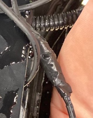

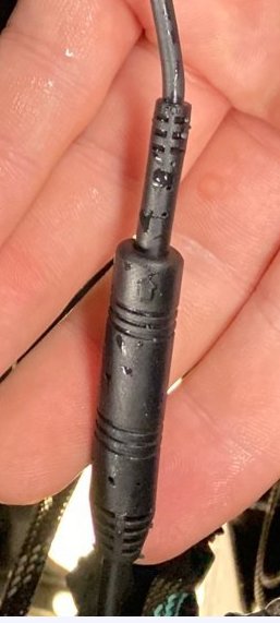

    Sure thing here are the pics, I don't think the issue lies in the camera since I swapped it out to the old one just a few minutes ago and having the same issue. Nothing changed with the new camera replacement going in, just popped out and unplugged then popped in new and plugged in, worked fine until this morning.IMG_6467.jpg IMG_6468.jpg

    What's taped up in this?
    And is this part mounted where water cannot get in?
    If it was working before the rain... then it rained and stopped working... likely suspect is the rain, right?

    The taped up part is the purple, green and white wires for the camera (reverse, parking lines) I cut the flip image and parking lines so they're shrink-wrapped and taped in electrical to protect from water. The main connection is where it always sat and never had any issues at all with water and I live in FL it rains like half the week. I'm guessing it could have been water too but I don't see a fuse to replace if it shorted, unless the whole wiring kit is garbage now. Odd timing right when I get a new camera though.

    That taped-up whatever-it-is is on the camera side of the connections. Is that a picture of the new camera or the first camera?

    I mentioned what the taped up part is & the camera in the picture is the new one but is the literal exact same as the old one.

    I'd disconnect the connector and see if you see any signs of water intrusion... and do the same for the taped up part. That's where I'd lean to... there are some "hot" lines in there... if they shorted to each other, it may "break" the camera feed.
