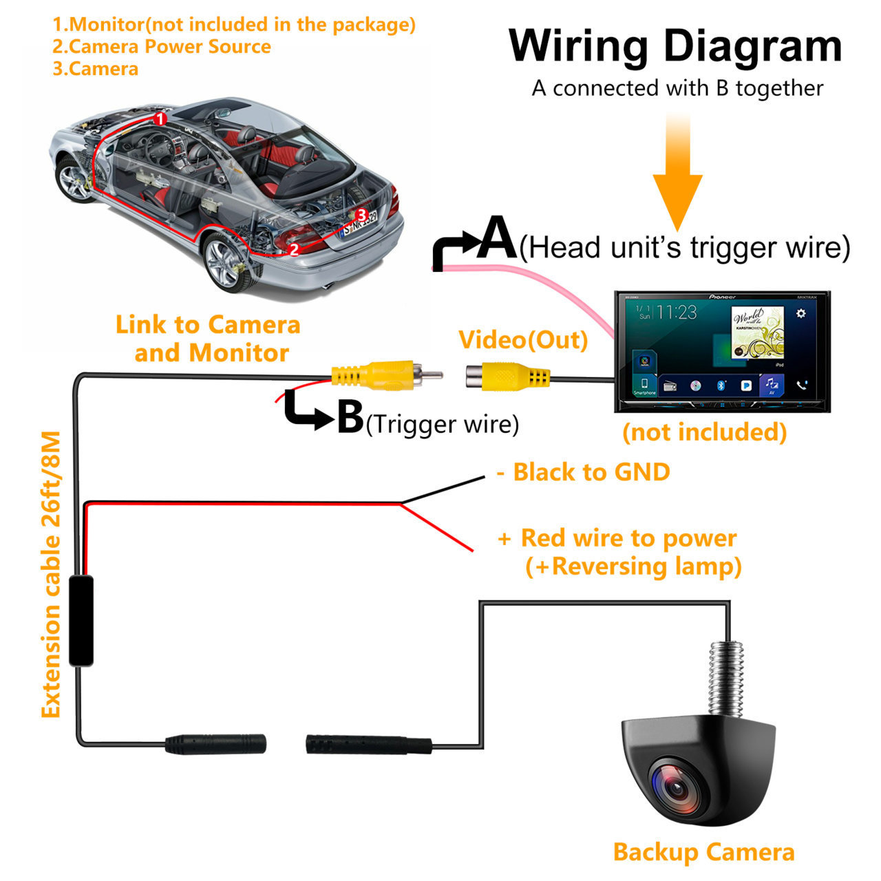

    How is your camera power wired? I used the "A" trigger wire from the head unit (as provided on the CS harness) and connected it to the "B" trigger wire connection on the male RCA connector. I routed the Red and Black wire pair into the truck cab and taped the ends.
    Depending how your camera is powered, you could try powering it by the alternate method. The problem is that if there's an issue between the junction point where the Red and Black wires tie into the main cable and the 4-pin tubular connector, I don't know of any good way to check that out.

    Mine is running the same way you have yours ran. I think ill just try and spend the $20 and see if the new wiring solves the issue.

    If you can get a new Natika wiring harness, I would pull your HU out and connect the new harness and run the cable out through the window to your camera. That way you can be sure the cable failed before you go to the trouble of routing the new one through the firewall.
