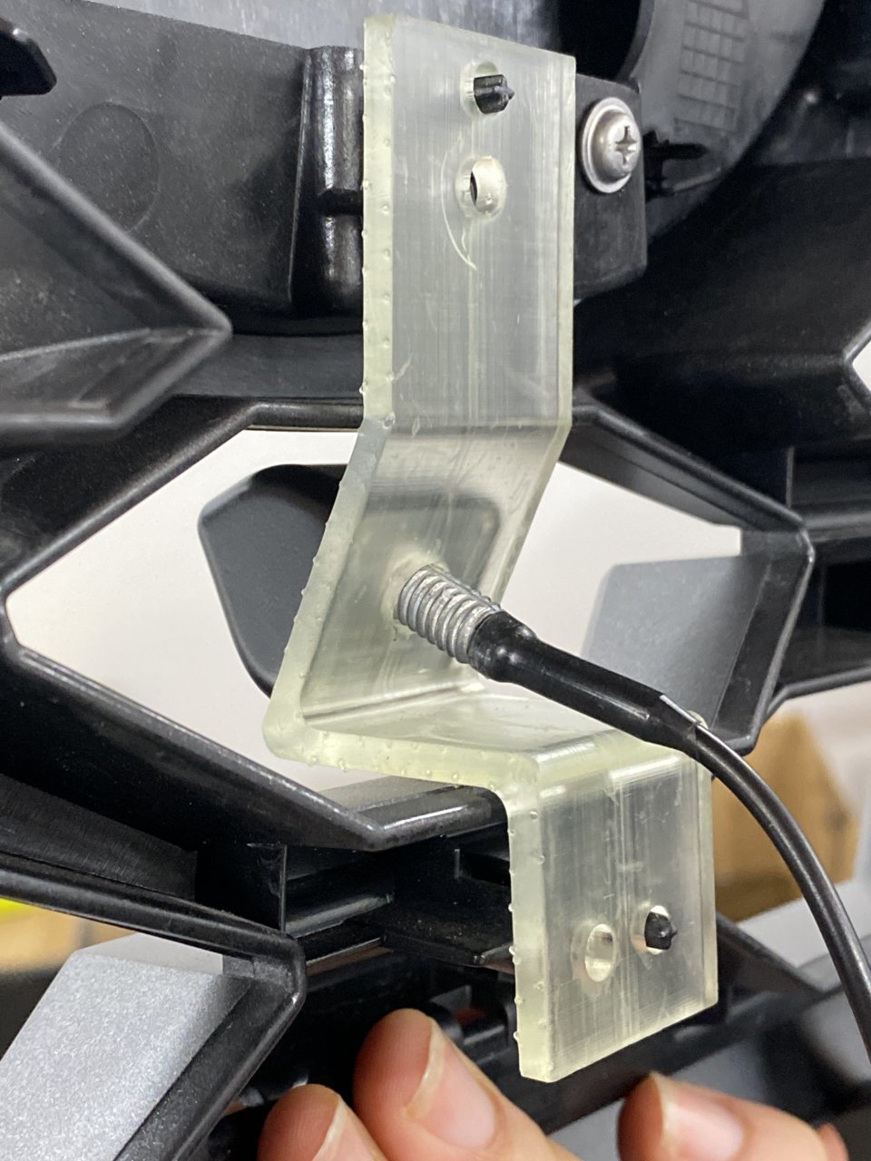

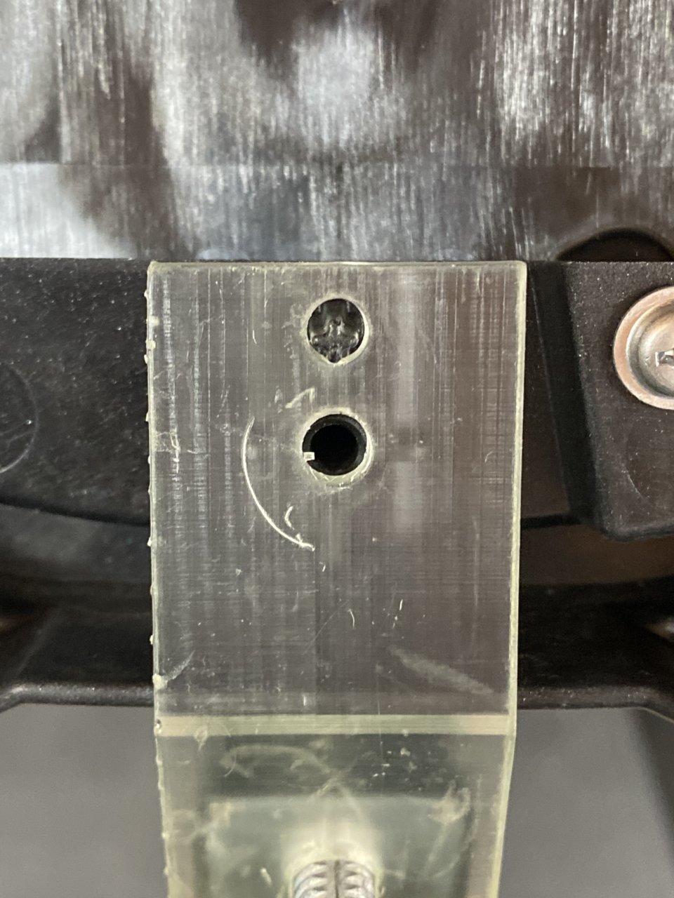

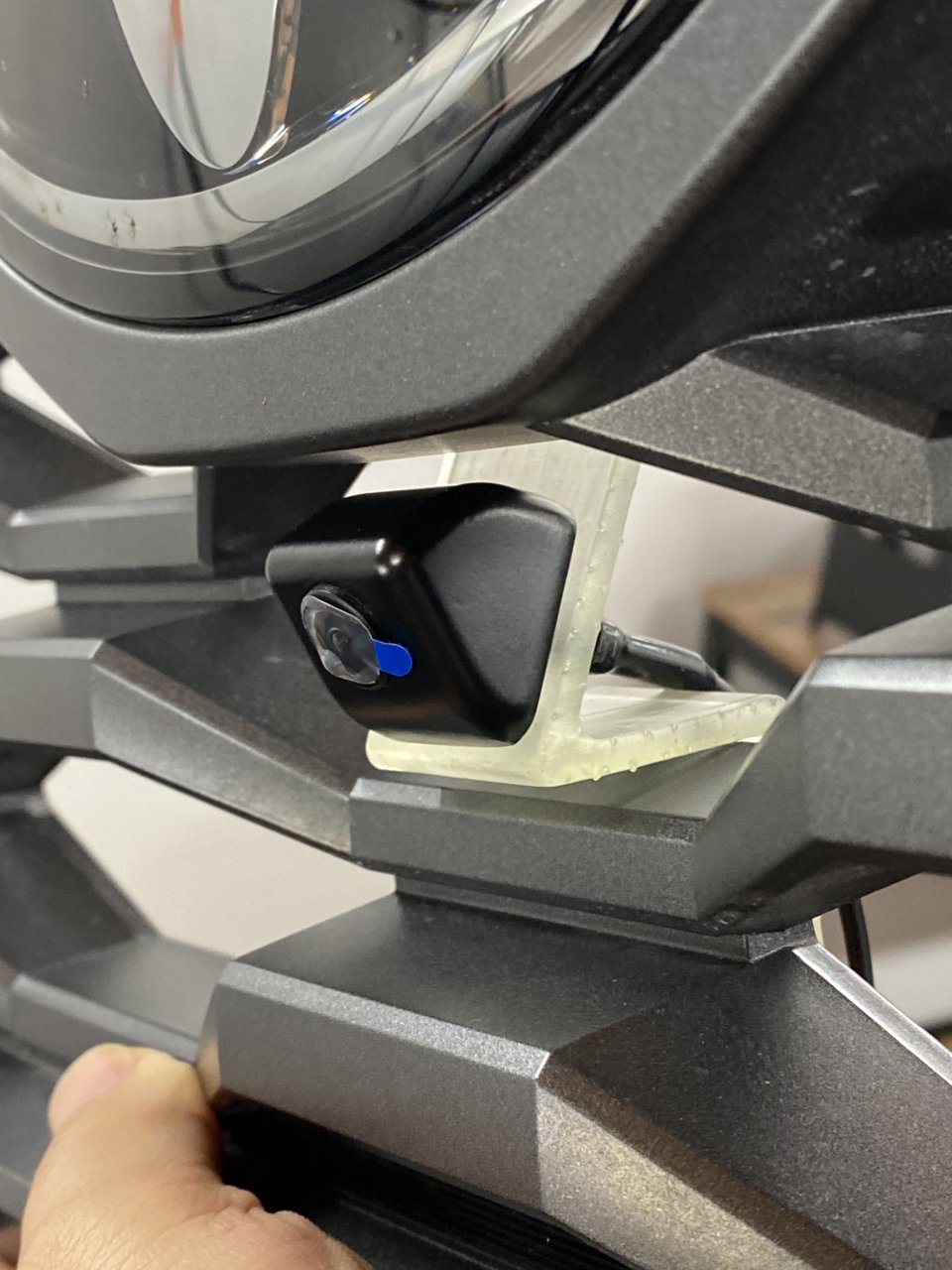

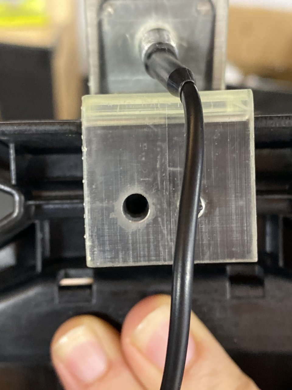

    I finished the first bracket, these images are the first prototype it’s now reached production ready status, I’ll picture that today and post them later.
    It bolts on to the stock mounting locations for the multi terrain monitor camera using 2 screws.

    Looks good! Shame the system is not cooperating but I appreciate you doing the leg work and checking compatibility.... Cheers!

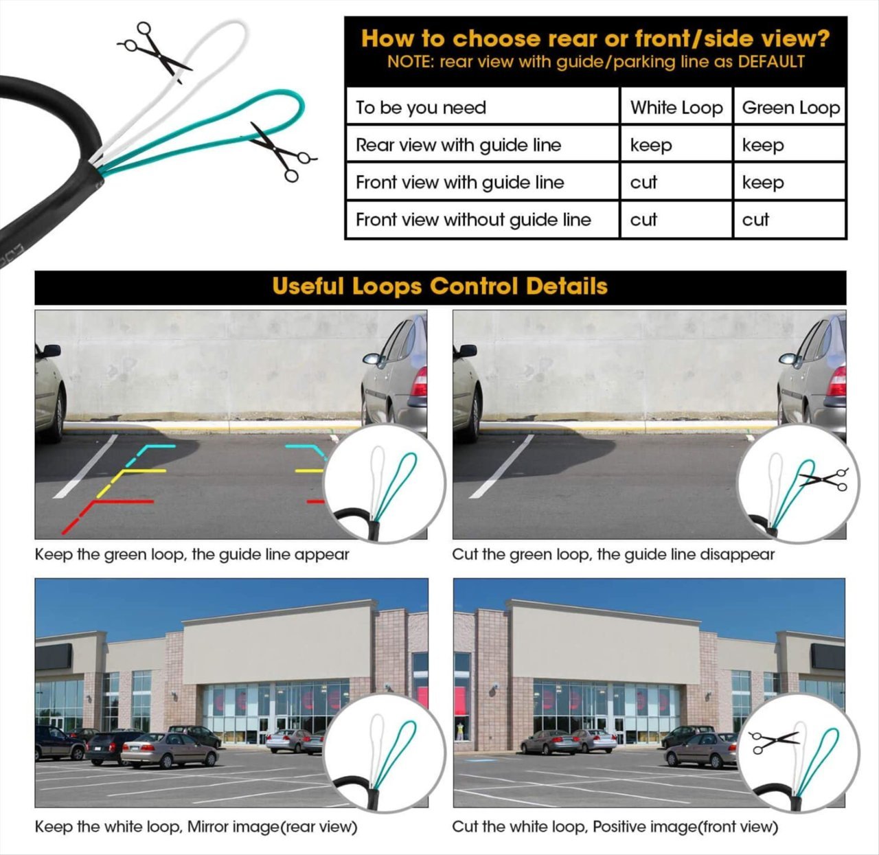

    Hey I have another question. Couldn't I just install the Natika camera on the front upside down? I am sure I can rotate the image correct? If I install it under the Toyota logo wouldn't it look normal or would the image be l/r backwards and/or upside down?

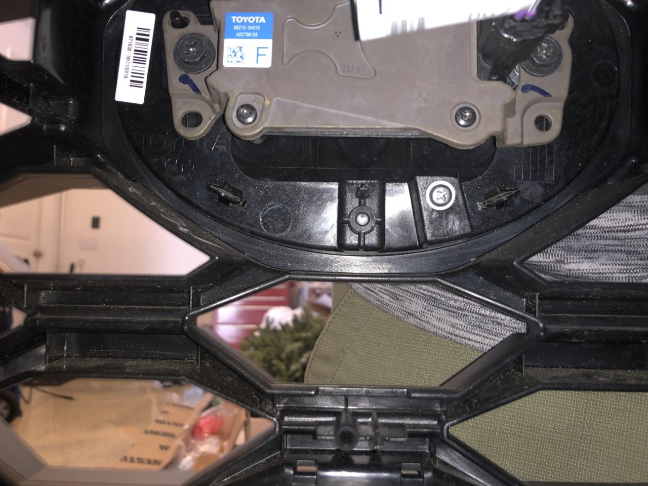

    Ah thanks man!!!! I saved that image. Do you think the Natika camera would fit here? I imagine I have to cut the post to get the nut on the back.

    You could probably use the bracket the FreshMex has designed. Or use a piece of aluminum bar stock to design your own.

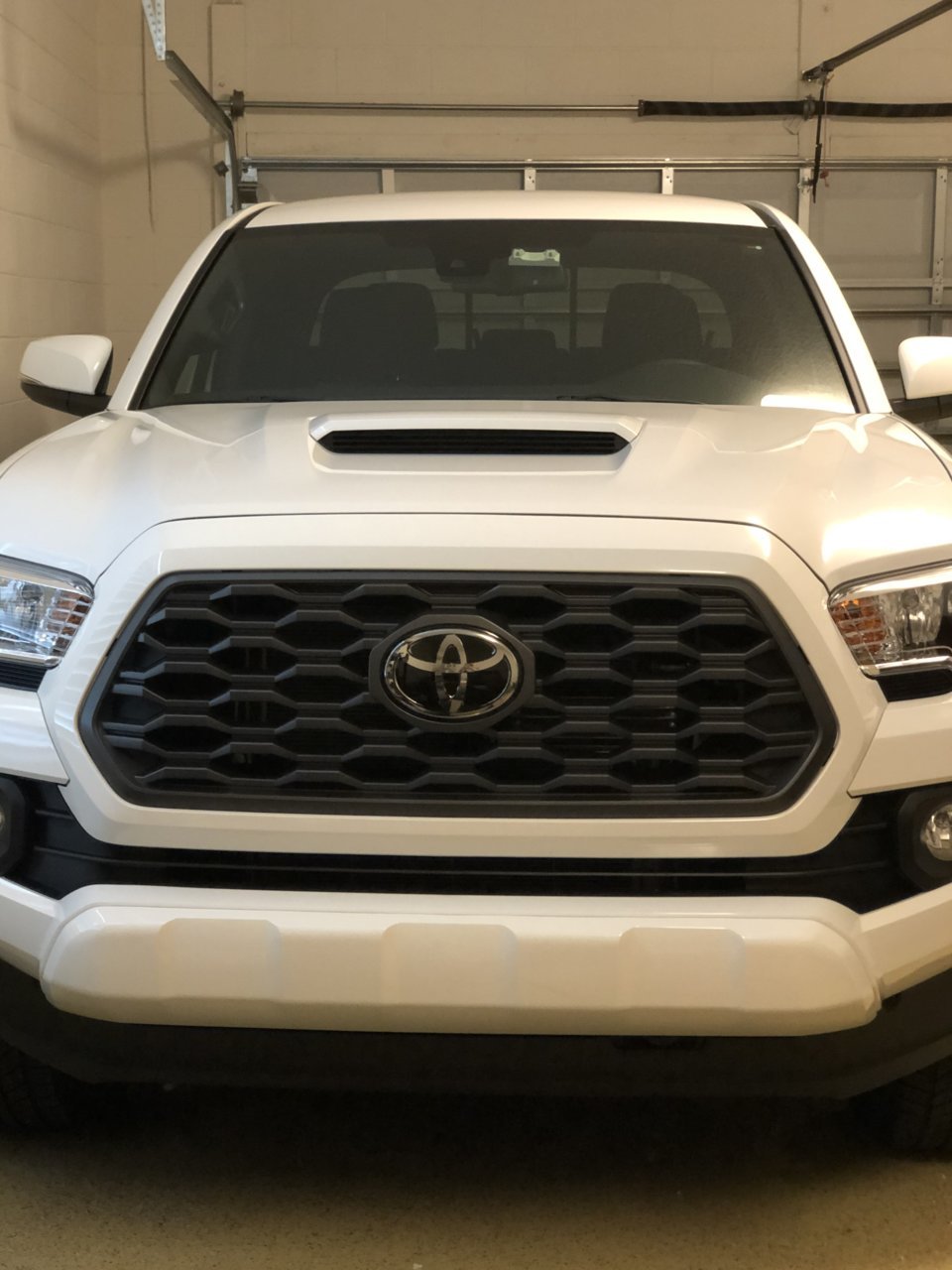

    If I had to guess, I'd say that piece is both too wide and too thick. Probably 1.5" wide and 1/16" thick would be more like it. But I don't have a 2020 grille so I'm really not sure. But the piece you ordered, being 1/8" thick, is probably not going to allow the bend radius you'll need.
