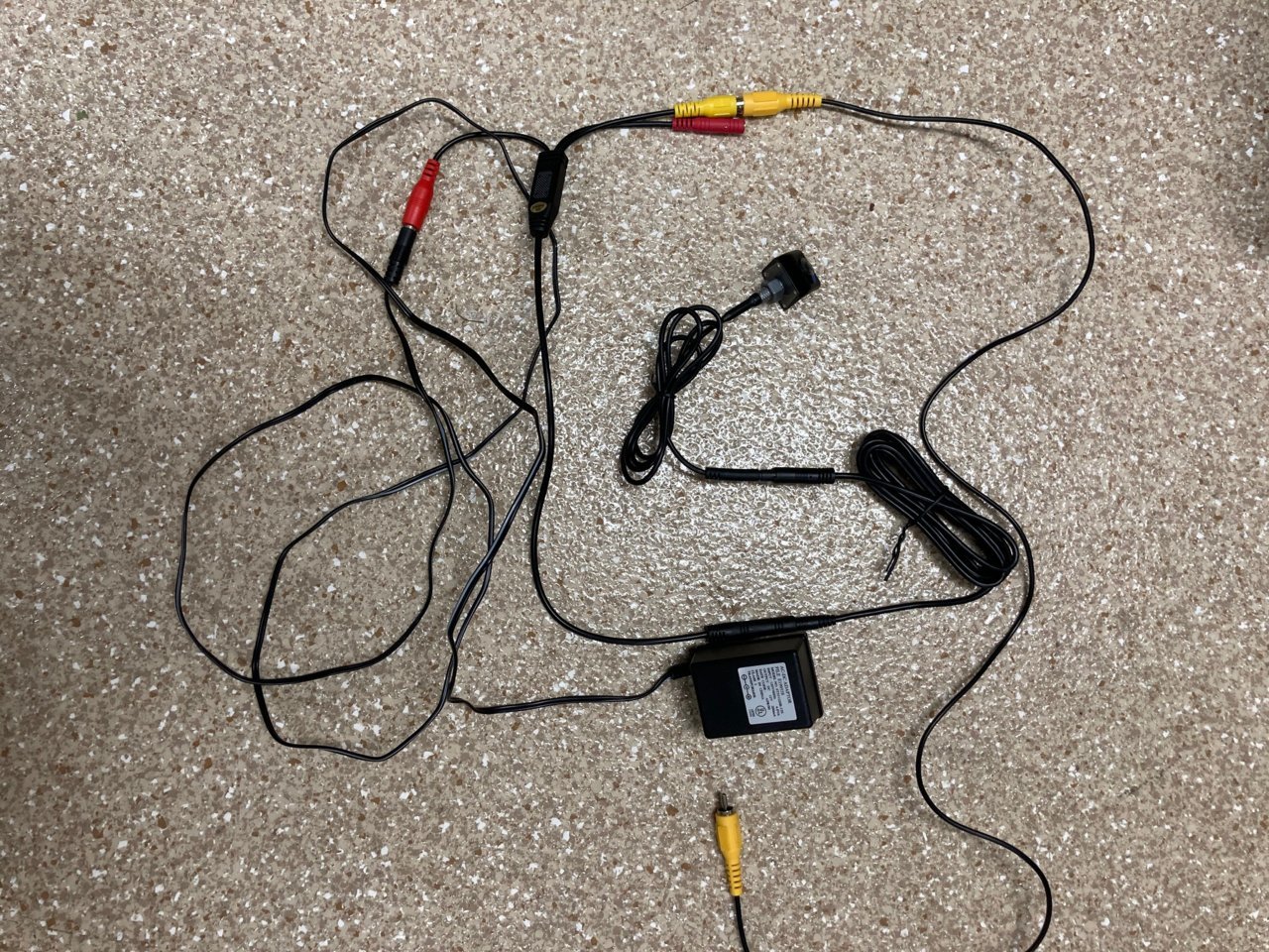

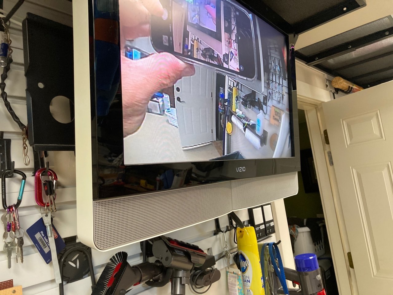

    I received this cable today. It connects on the camera end cleanly though maybe not as fully weather-tight as before, still probably 100% OK but you could maybe wrap with heat shrink, enclose in flex loom, etc. On the pigtail side it connects tighter than I expected, took a bit of force to get it on. There's a grove so you can't mess up and bend a pin when connecting.
    And...it works. I used a 12V 200 mA AC-DC adaptor for temporary power after confirming the pigtail expects positive pin. Photos of my setup and the results attached, obviously not the cleanest image as I still have the protective plastic on the camera lens and wasn't going for anything beyond confirmation that it all works as expected. I believe I'm holding the camera upside down as I intend to mount it so I still need to connect the control button and reverse L and R and maybe I want gridlines, haven't decided yet.
    Perhaps this helps some of you who might want to do something similar? Perhaps OP might consider bundling this extension cable and/or potentially sourcing a shorter rca video cable and crimping on the bullets which would save anyone from having to purchase a crimp tool just for that.
