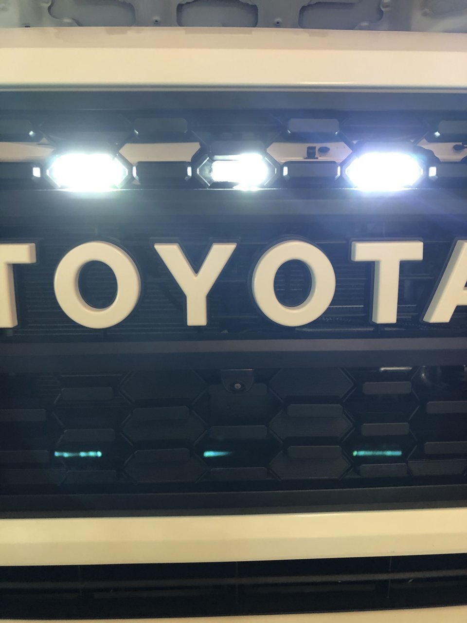

    Hmm my R4T grille LED center light is defective and the fuse placement puts it with the headlights and I wanted it with the daytime running lights.
    So for a 2020 which fuse is for the daytime running lights.

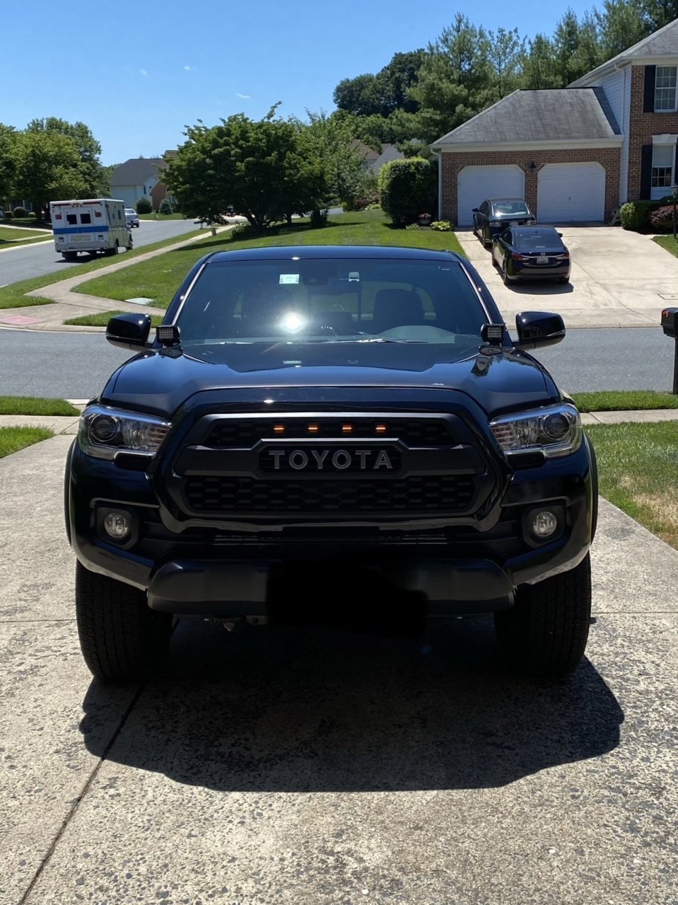

    Ironman Stage 1 Foam Cell Pro lift kit, 255/85/16 Cooper ST Maxx, SCS BR6 Wheels, SPC UCA, Heated seats, MESO TRD start button, Meso Total Tail v1, Meso V5 mirror white DRL turns, bed decal, ditch and hidden bumper lights, screen protech, RAV4 radio knobs, steering wheel anytime camera kit, dash cam, ECGS bushing, Timbren Active Off Road bump stops with Wheelers flip kit. 35% Xpel CS Ceramic Tint, KD Max Tune, SumoSprings front bump stops, RRW Sliders ‌ ‌ ▲ ▲‌ ▲
    The only way to get them on with the DRL is by splicing them in with the DRL wire. The fuse for them is always hot so the LEDs would be on all the time. There are not many fuses you can tap into in the engine bay that aren’t hot. I tapped into IGN2 I think. Hope this helps.

    Was that your DRL or should I just leave it on the headlights?
    Id rather not splice anything.

    If I remember right it’s fuse tapped into IGN2. The lights come on anytime the truck is on. I tried using the headlight and DRL fuses but they are always hot.

    That fuse is in the main fuse box under the hood, it’s just if you use that fuse to power the lights they’ll be on all the time, even when the truck is off.
    I wanted to do the same thing for my lights to come on with the DRLs too but they would have been on when the truck was off. I might still end up splicing them into the DRL wire since I don’t like them being tied into the IGN fuse.

    I have white ones and live in Florida. I do not anticipate that being a problem but we'll see.
    First the vendor has to fix the broken one they did send. I only use 3 instead of 4.
